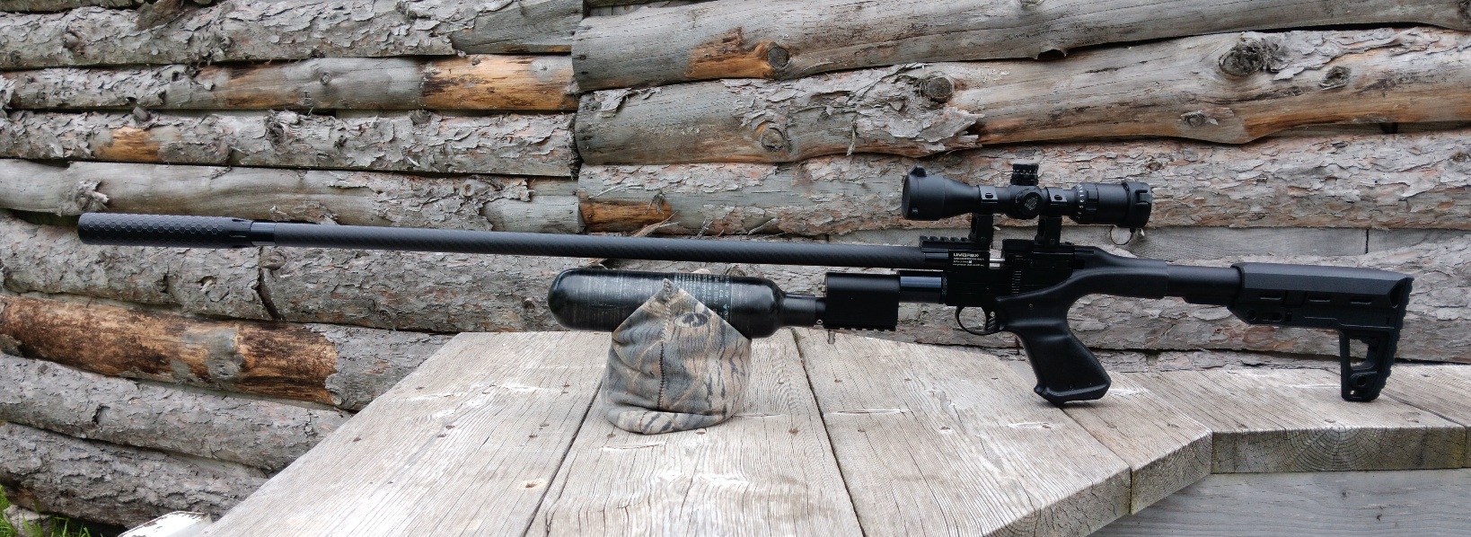

How old is this NOTOS??? It has a pic rail on the bottom of the bottle and a right side lever to cock and load. Unless I am tired and slap happy...which I do need a little bit of a nap! I've been looking into fitting my Notos with a bipod, And would love for mine to load on the right!! I guess I am just wishing and hoping for something I could have!
Good eye!
As mentioned it is a pp750. And even better it is in .177 cal if you look for mods on the pp750 you will find items that will fit the notos as well.
Allen

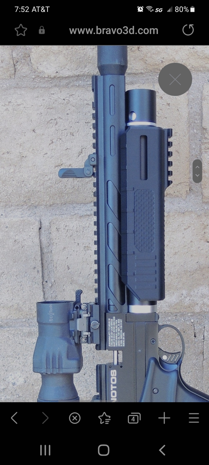

I picked this one up and its frigging awesome. No dumbass "tube clamp" with a picatinney section. It slides over the tube very snugly and looks great and functions great. $29.00 from Bravo3D.com
Reactions: BABz58

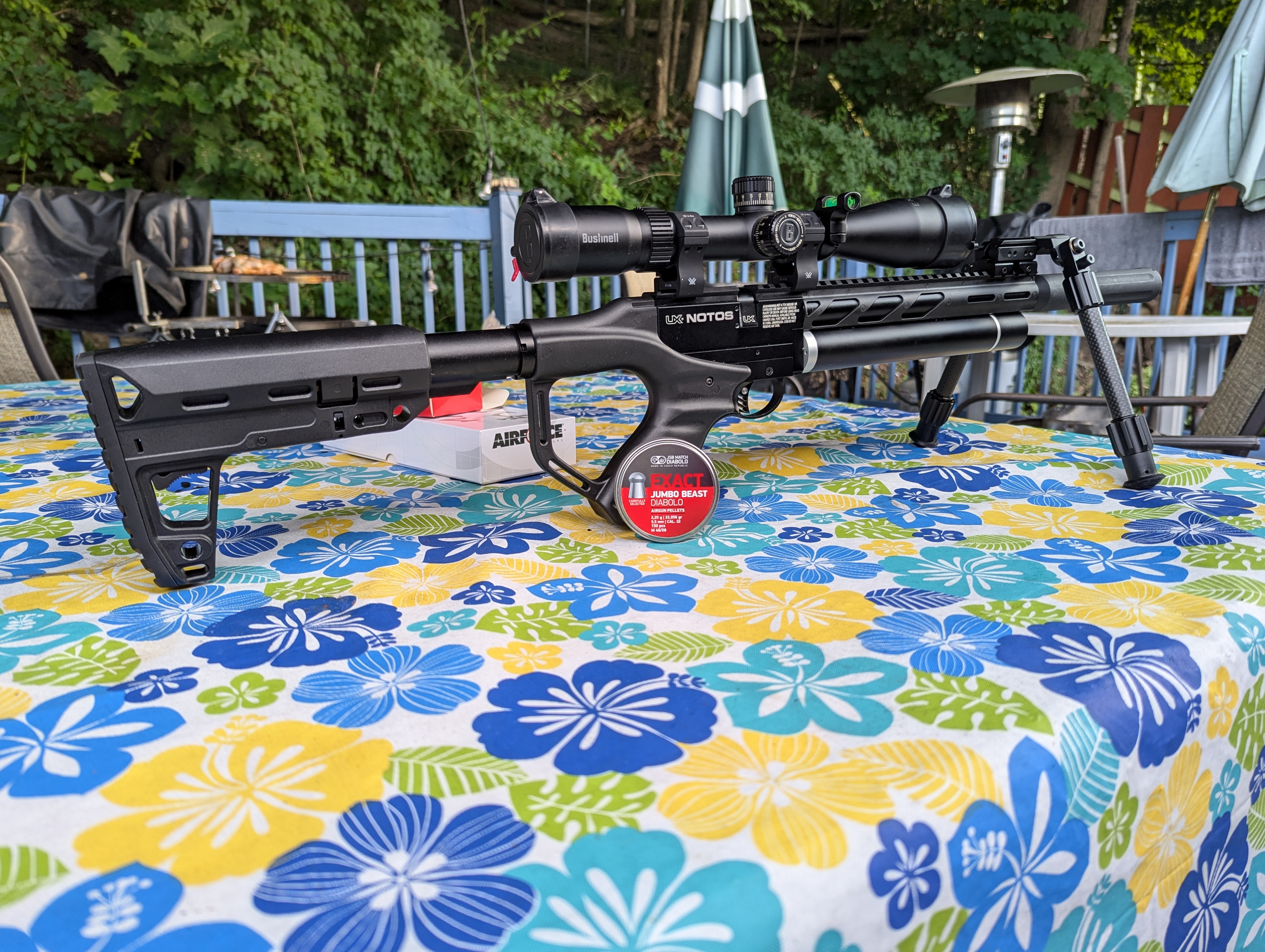

Got the Ted kit from pyrramydair, love it! and it's a great Kit
It looks awesome and the bipod and Notos are fantastic products, but from my experience I think that Ted dropped the ball here…
What happens is that having the bipod so far out in front and clamping on top of the gun, it bends the shroud/barrel combination under anything but the very lightest of touch when gripping the gun due to a long leverage arm. The Notos is not a heavy (literally) duty setup, it is mostly light plastic, and in essence has a free floating barrel, so not suitably equipped for this setup. (A fix would be a barrelclamp fixating the shroud to the airtube)
I have a laser clamped up front as well, and when I look through the scope it stays perfectly on target, but the laser dot will rise and fall with any varying grip. Of course this is very detrimental to accuracy and precision… (from the side you can also literally see the shroud separate from the airtube when you vary grip levels on the gun)
When you connect the bipod at the base of the rail (near the action) there is less leverage and the barrel will not bend. But that will unfortunately not work with your setup, as there is no room for it.
