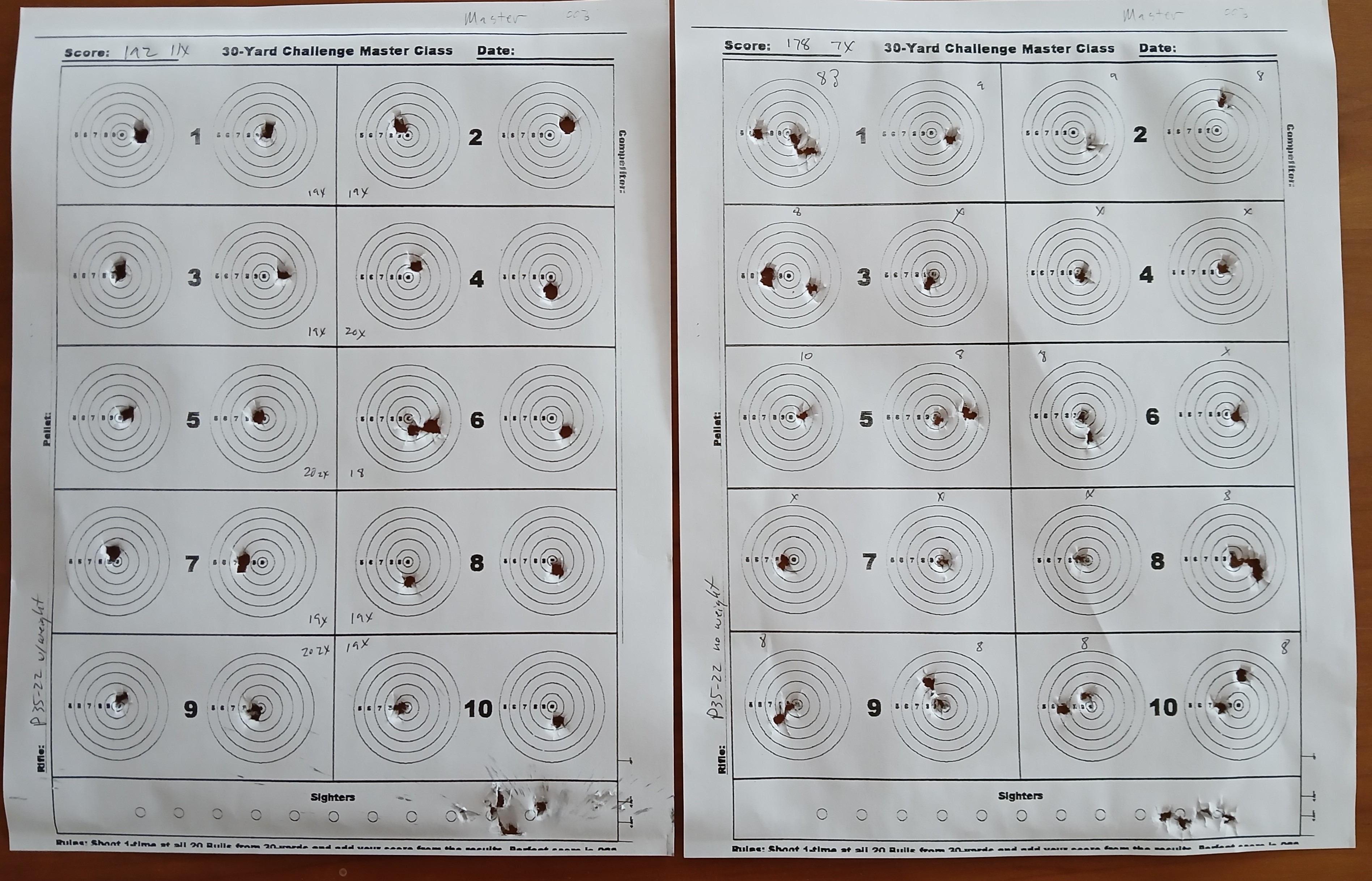

Still undecided. It was been windy here but is better at 6 to 8mph today so I did a little shooting both ways with the same gun and scope. I have an old stock for it that is painted and I screwed a 1 lb lead bar to it. I've also used 2 before but I think 1 is enough. Half a pound might be enough. I think it helps stability a little but also makes the adjustment screw on my adjustable monopod a little harder to turn. If I decide I like it I will put the weight inside the stock (route a groove in the forend).
I believed Smok3y but I wanted to see some indication with my gun. That happened yesterday. I was shooting poorly, I shot a 196 with this rifle in an unweighted stock Sunday. But yesterday I shot a 178 even though there was much less wind. So I moved the gun to my crudely weighted stock and shot the 192. My pattern is to shoot better on the first target and get progressively worse. So I don't think this was just me shooting better. This is my P35 in 22 shooting unsorted H&N Match pellets at about 810 fps at 30 yards. The extra shots were me trying to figure out if my misses were me or the scope moving or wind. The scope is new and I think it's probably me but I had the same sort of shifting poi on a different gun this morning but it was winder. It might be going back but hopefully not. The scores are based on the worse shots.

I have shot a couple 195 masters targets with the added weight but I shot a 196 without it. I think the weight helps as does the scope but the most important variable is still me. I am back to using two wind flags (in 30 yards) but I do not consistently use them well. Right after Helene my wind flags were precluded by a big oak tree that fell. I consistently shoot my best targets in wind that is consistent. Usually that means very low wind but the 196 was consistent 6 mph winds. When it changes direction or intensity I usually do not adjust well.
