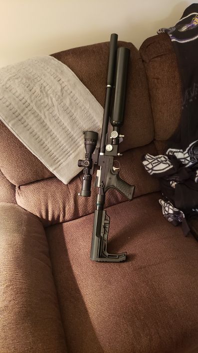

So there is no way to use that cylinder? Bummer. I am getting around 25 good shots with 10.34 pellets shooting at around 880fps and that is with the gauge block and 16 inch FX superior liner. I was getting around 900 for the first couple of shots, but later I figured it was due to creeping regulator.
I now ordered Huma regulator, so I'm hoping to improve efficiency a bit at 900fps. I have unristricted model, but haven't done any porting.
Any advice would be appriciated.

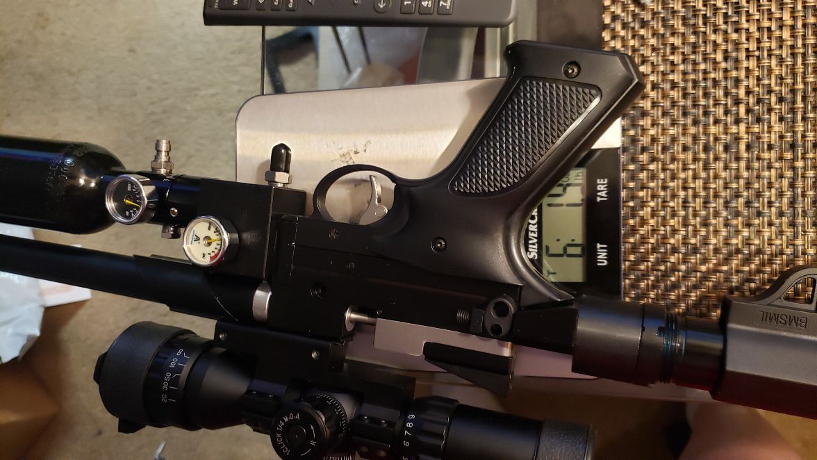

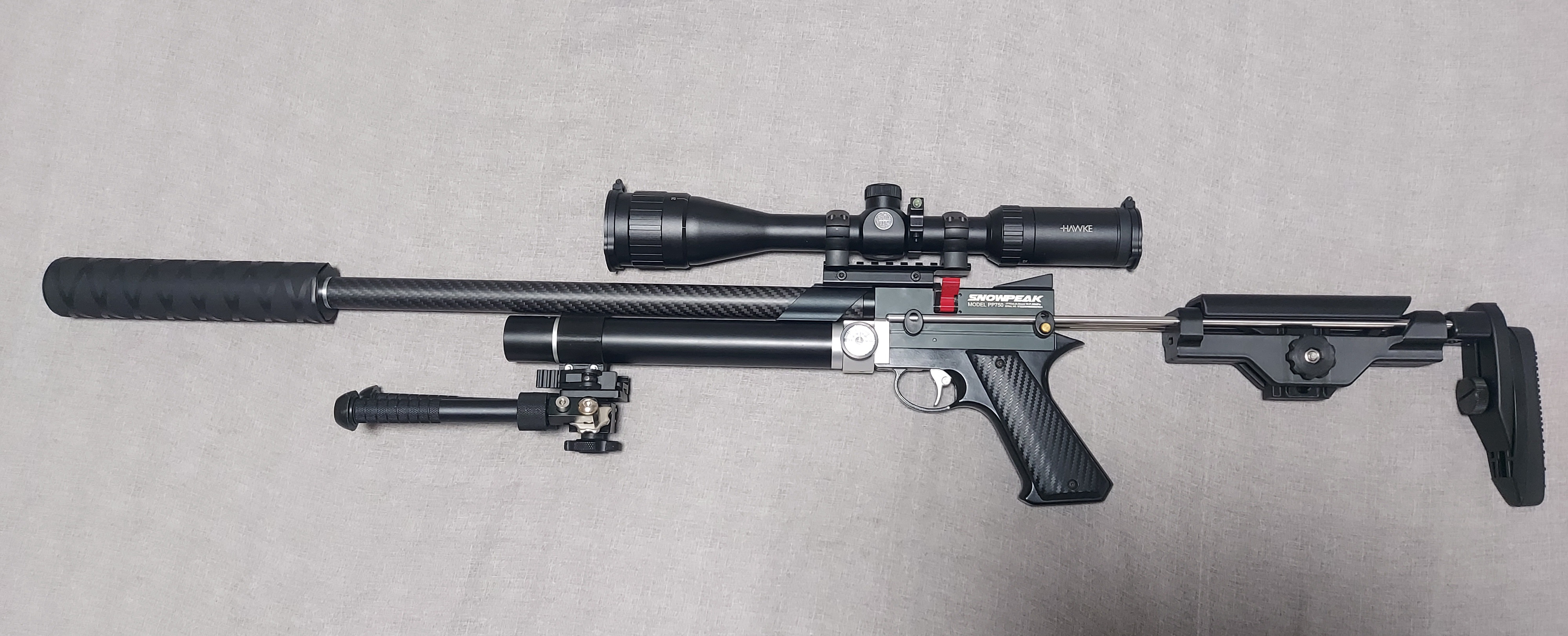

Currently working up a 14.5" and 15" barrels with 12FPE goal. Going over 12FPE is not difficult even with 8.5" barrel. It is getting to 30 shots.
The 14.5 makes 24 shots... then spikes as it comes off reg. 15 cu in bottle with ninja reg @ 1,350 PSI makes probably 100 good shots, but bottled pistols are more like carbines, especially with a 15" barrel.
I will turn up my reg, slug the hammer with 5 more grams and find out... hope the poppet holds.
