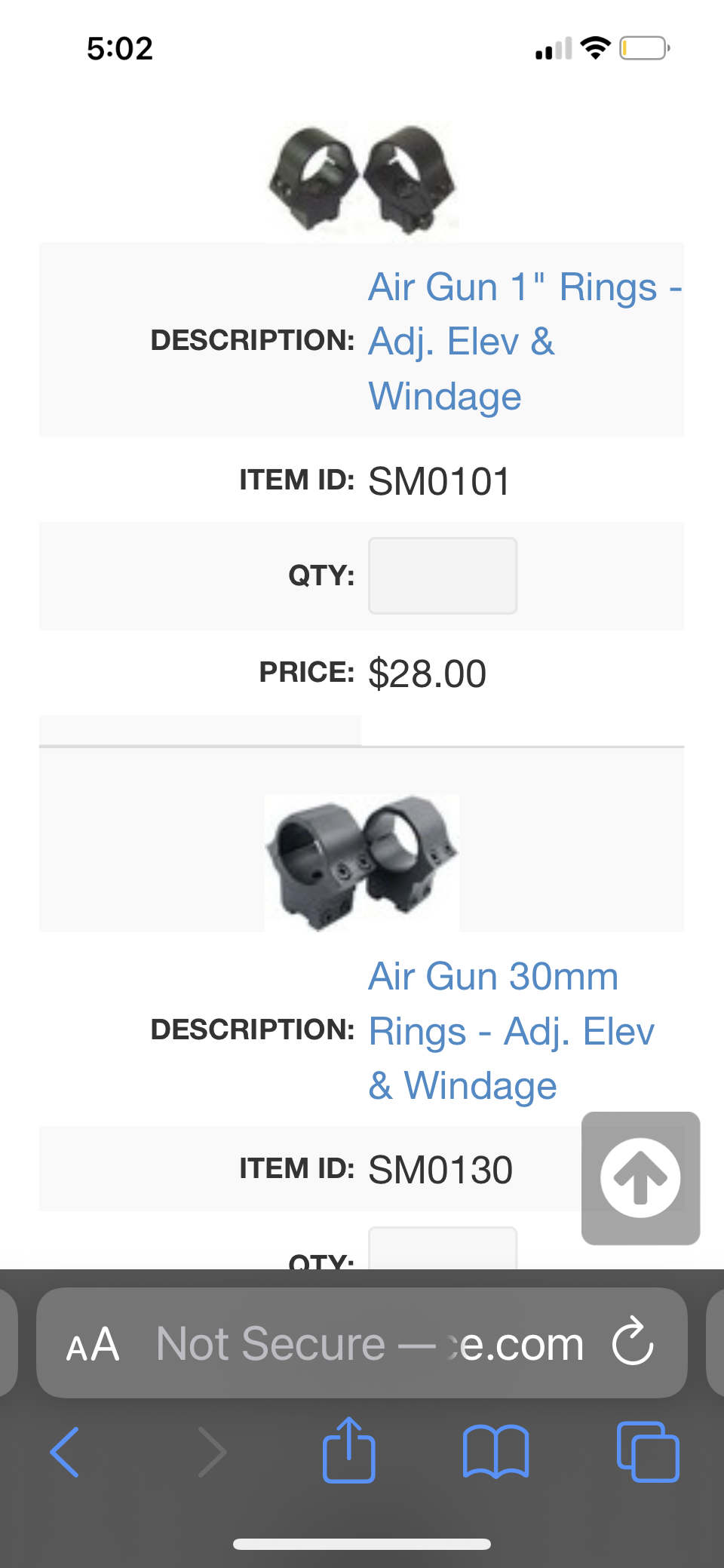

Adjustable Scope mounts. Windage and Elevation ?
Awesome. These are the ones I’m looking for.
Desirably priced !!
Nation,
I ordered a set of the "fully adjustable " Sun mounts a while back. Not only were they not fully adjustable, they didn't adjust at all.
All of my Field Target competition rigs have fully adjustable Sportsmatch mounts on them. A must for every airgunner. Too many times I hear of not enough adjustment on the scope elevation. The Sportsmatch mount solve this age old problem, as well as keeping the scope optically centered at the desired zero range. Sportsmatch all the way.
Tom, what's the story there? I've used the Sun adjustable rings and they are most definitely adjustable for both elevation and windage. Did the vendor just ship you the wrong thing?
In Tom's defense (unless they were indeed the wrong item sent) —
I remember the Sun adjustable mounts being described as so finnicky, requiring tricks and special instructions, that I never even included them in my master Scope Mounting Table of adjustable mounts — just seemed too much hassle.
Maybe I'm wrong, wouldn't be the first time. But the other brands are much more straight forward.
Matthias
I'm not sure if they sent the wrong mounts, but I've heard of others that have ordered Sun adjustable mounts, and they said they were not adjustable. I sent the Sun mounts back, indicating that they were not adjustable, and to send the adjustable ones. I received the exact same non adjustable mounts a few days later. Sent them back for a refund, no problem. For $28 dollars, I wasn't too hopeful to begin with.
