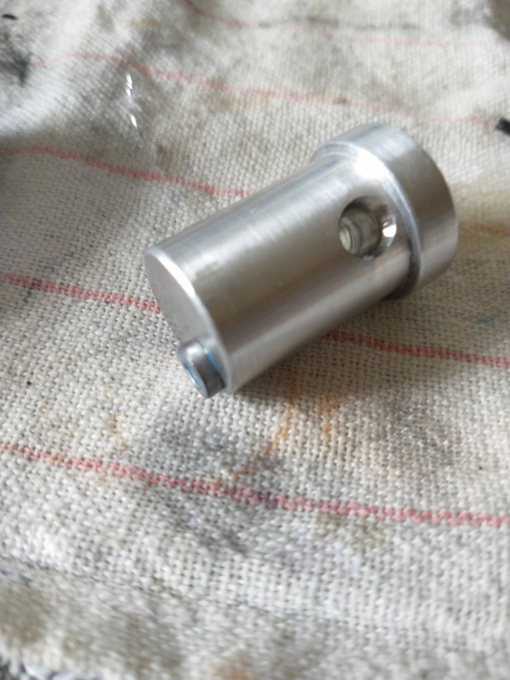

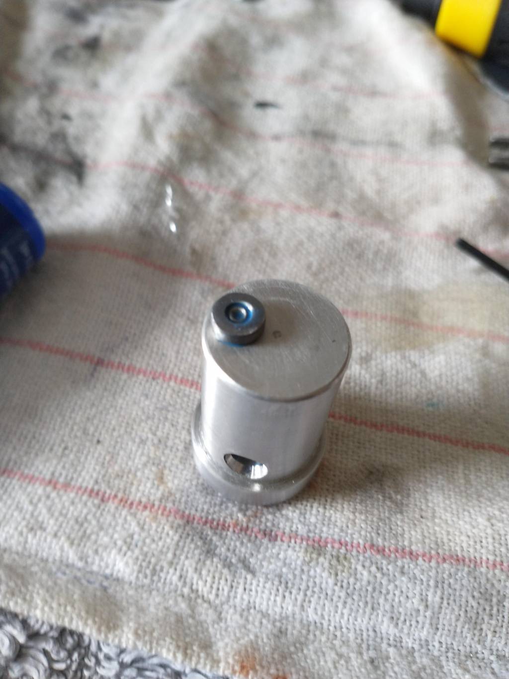

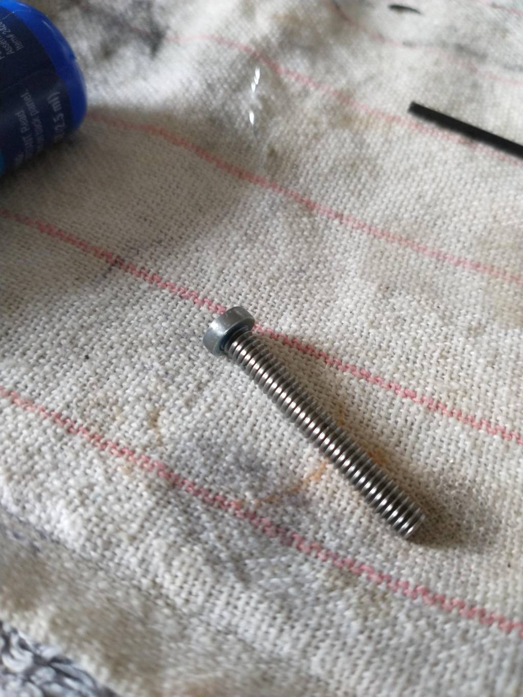

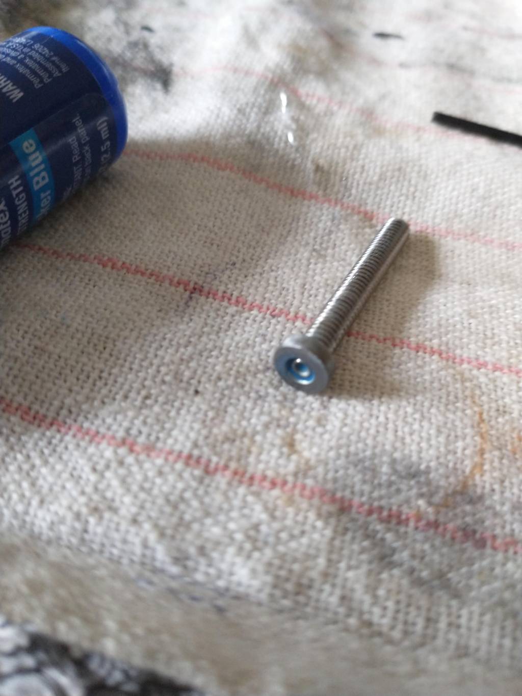

So I'm working on pellet testing and tuning my PCP's. A bottled Marauder, an Air Venturi Avenger, and an Umarex Gauntlet. Since I installed a super tune kit I have a hammer spring preload adjustment. Unlike the Marauder or Avenger there is no positive stop for the adjuster. I have found that sometimes you need a precise setting. For this you need a precise repeatable starting point. So since I had almost 3 full turns before I get any additional tension. So I made one. Machine screw, some locktite. Shaping and thinning on the sander. Cleanup with some 1200 grit.
