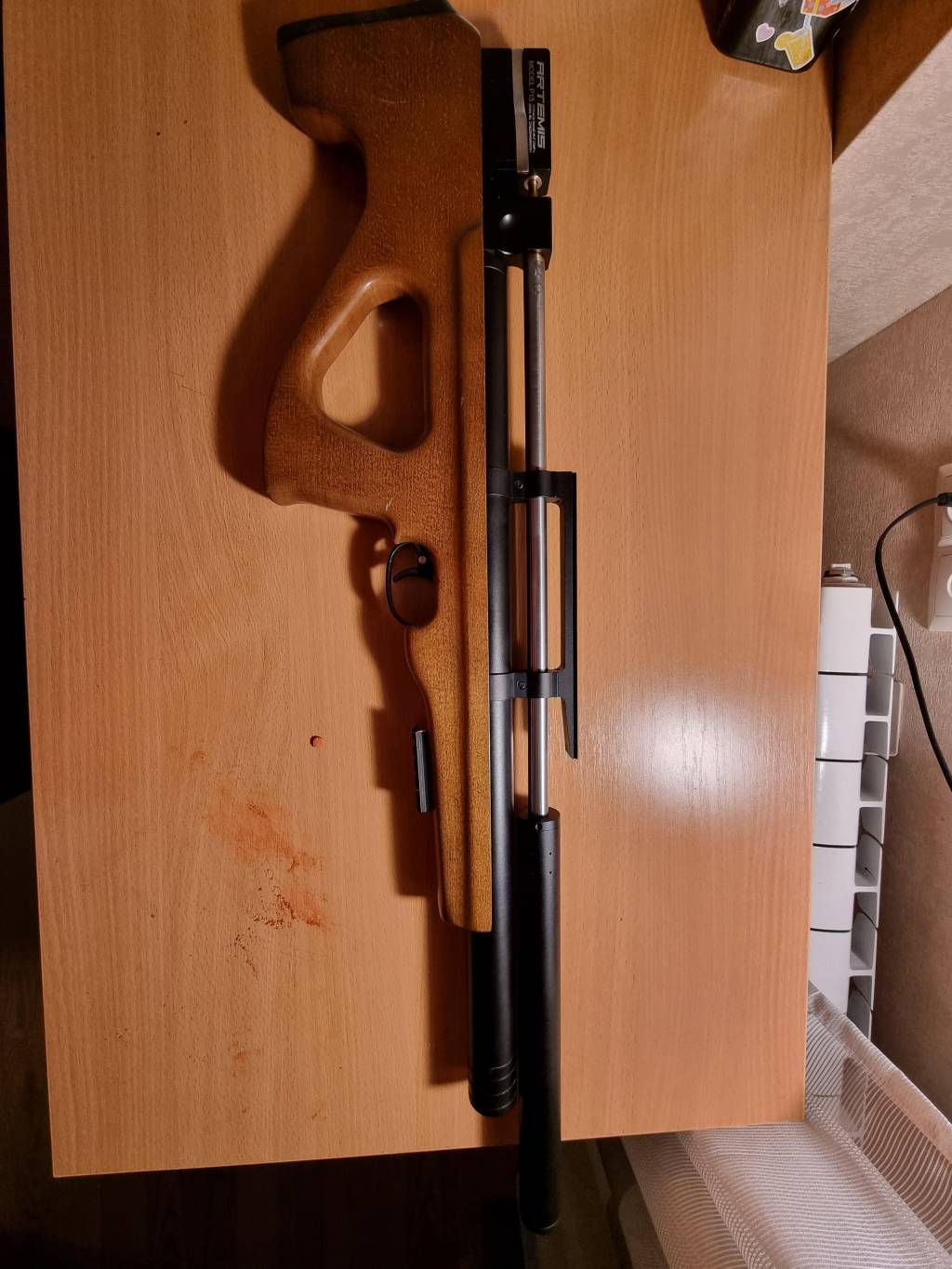

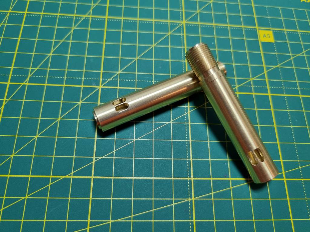

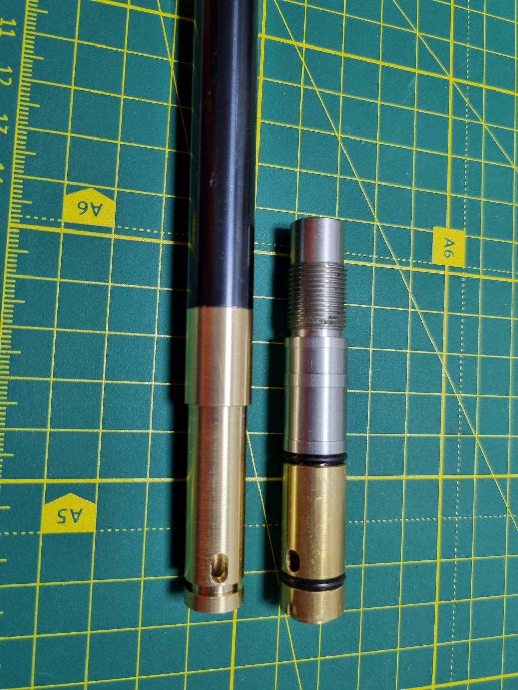

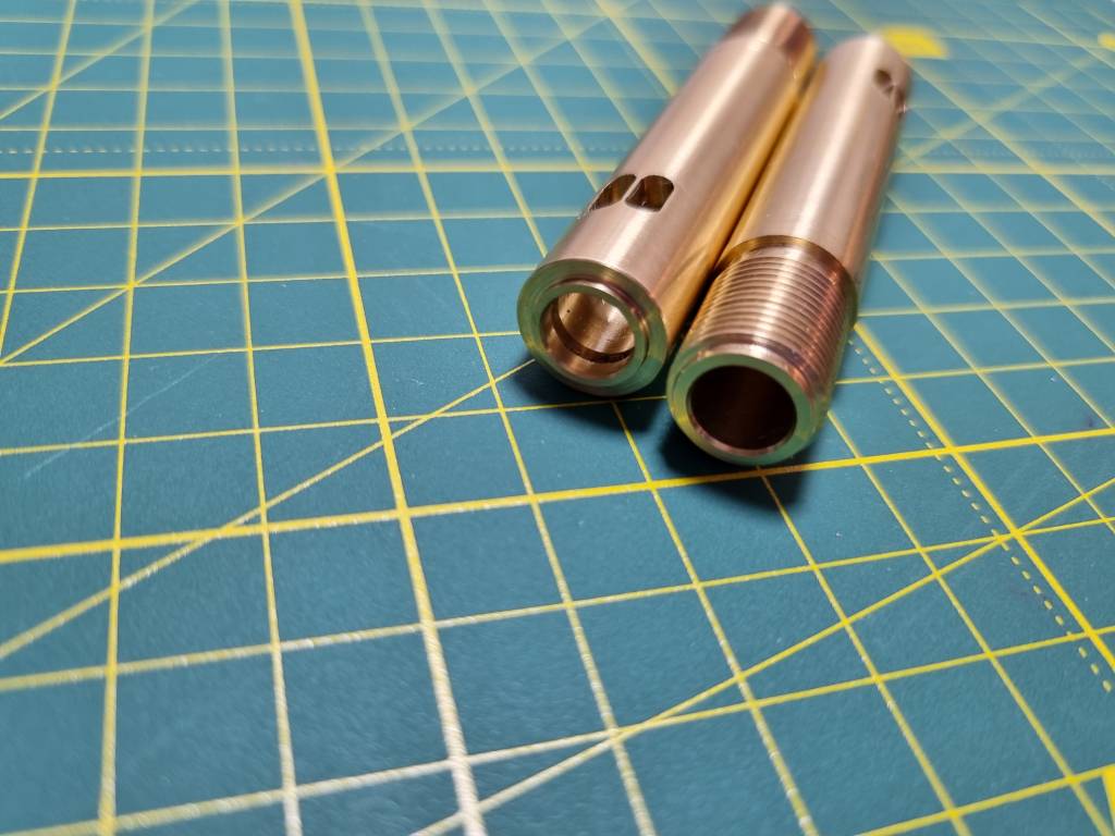

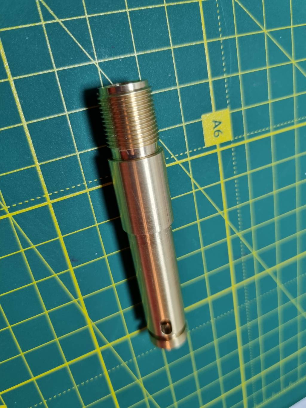

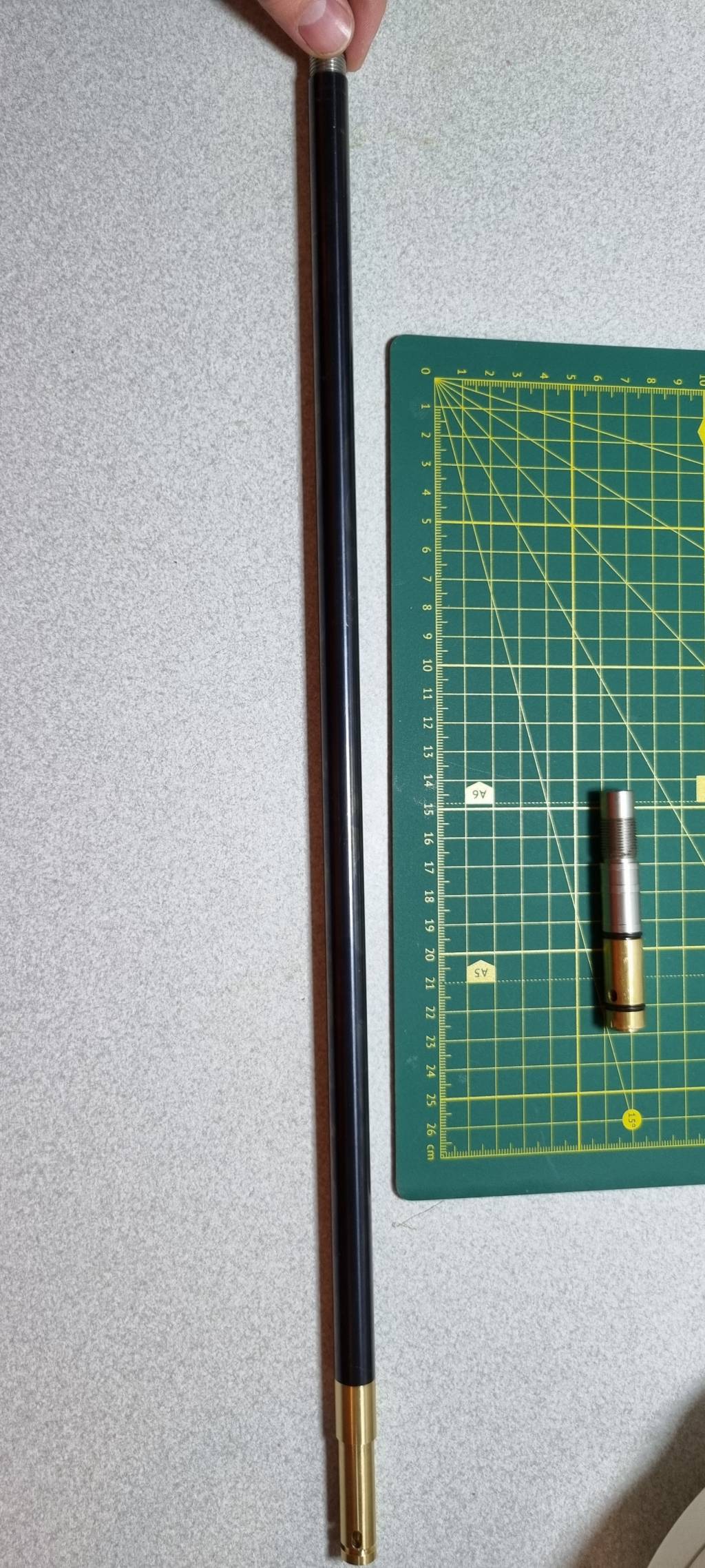

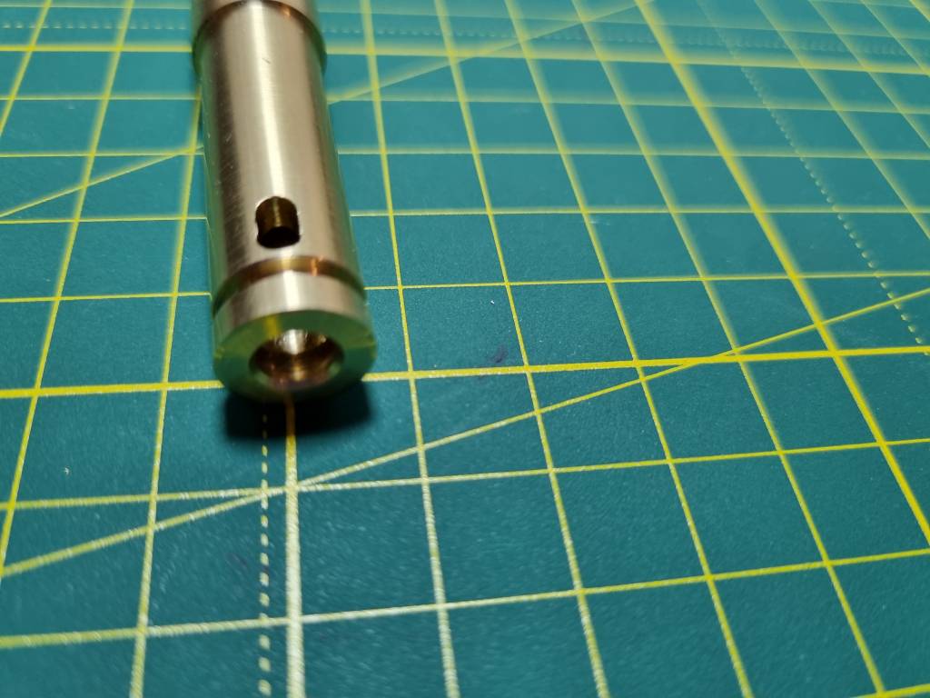

Good news, finally i found on Ebay 13 mm OD capillar tube for My Artemis P15. I made FX liner assembly for it:
frond cap
dual transfer port Made for 500mm FX liner,

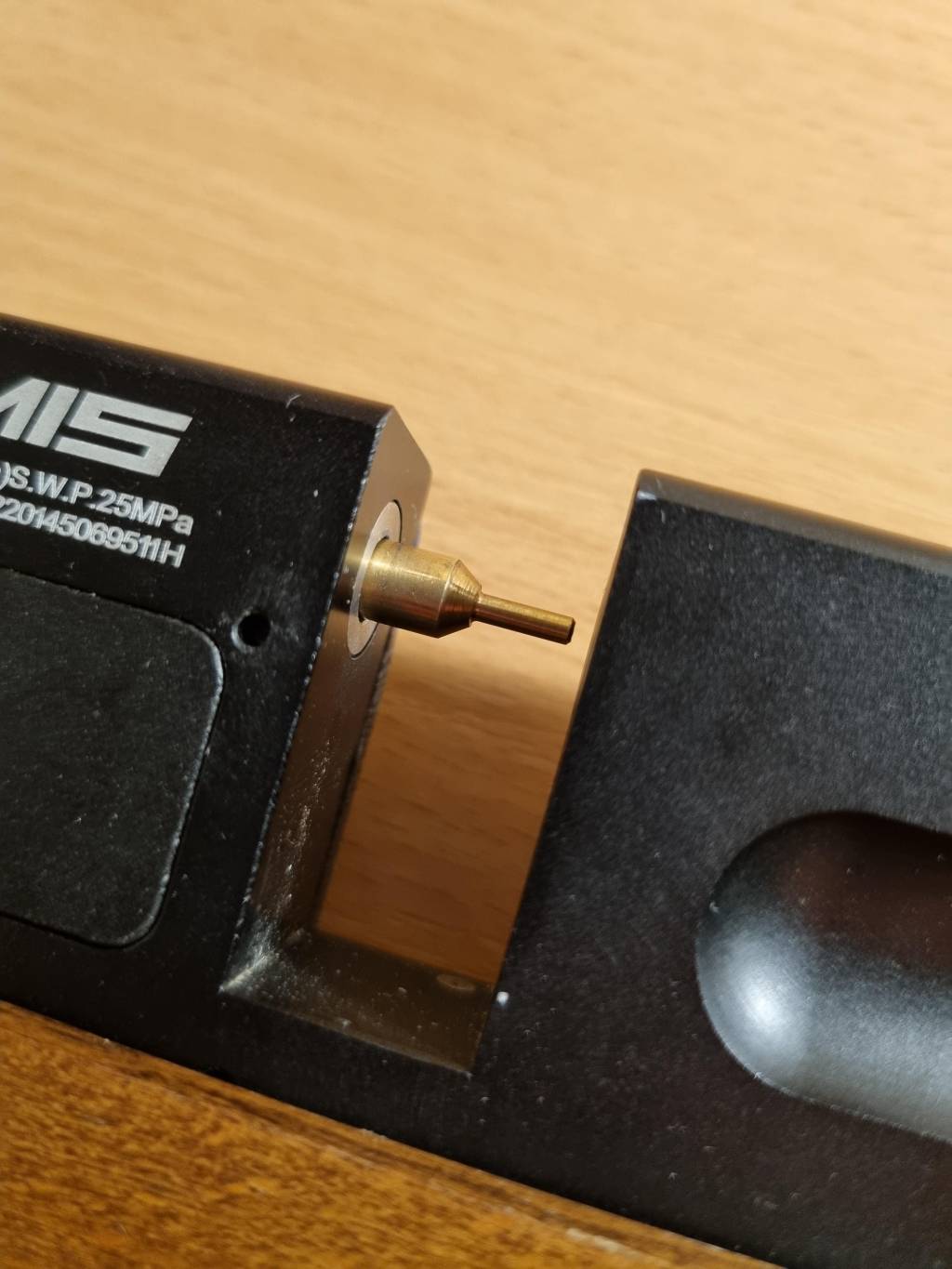

made new slug probe
made new plenum on 28 cubic cm
increased regulator pressure up to 143 BAR an tried to shoot Nielsen .2175 slugs 20.2 grain
Got 40 shots per fill 924-927 FPS(on stock specifications i got only 820-830 fps max)
Next i will shoot on paper and share results with you
