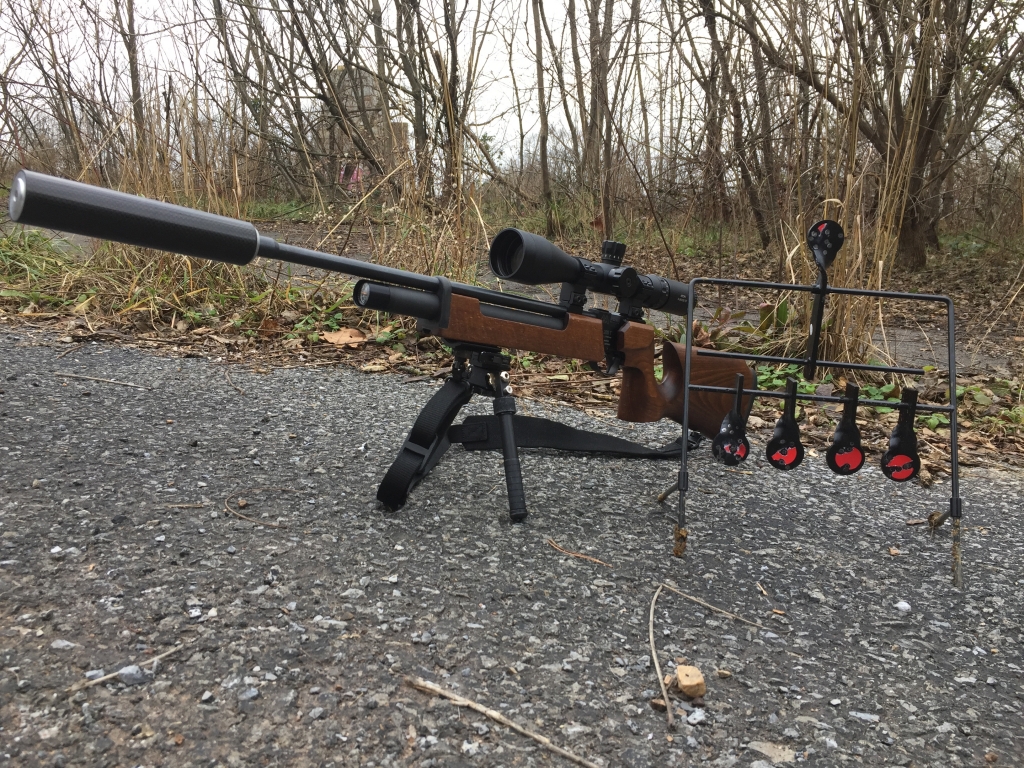

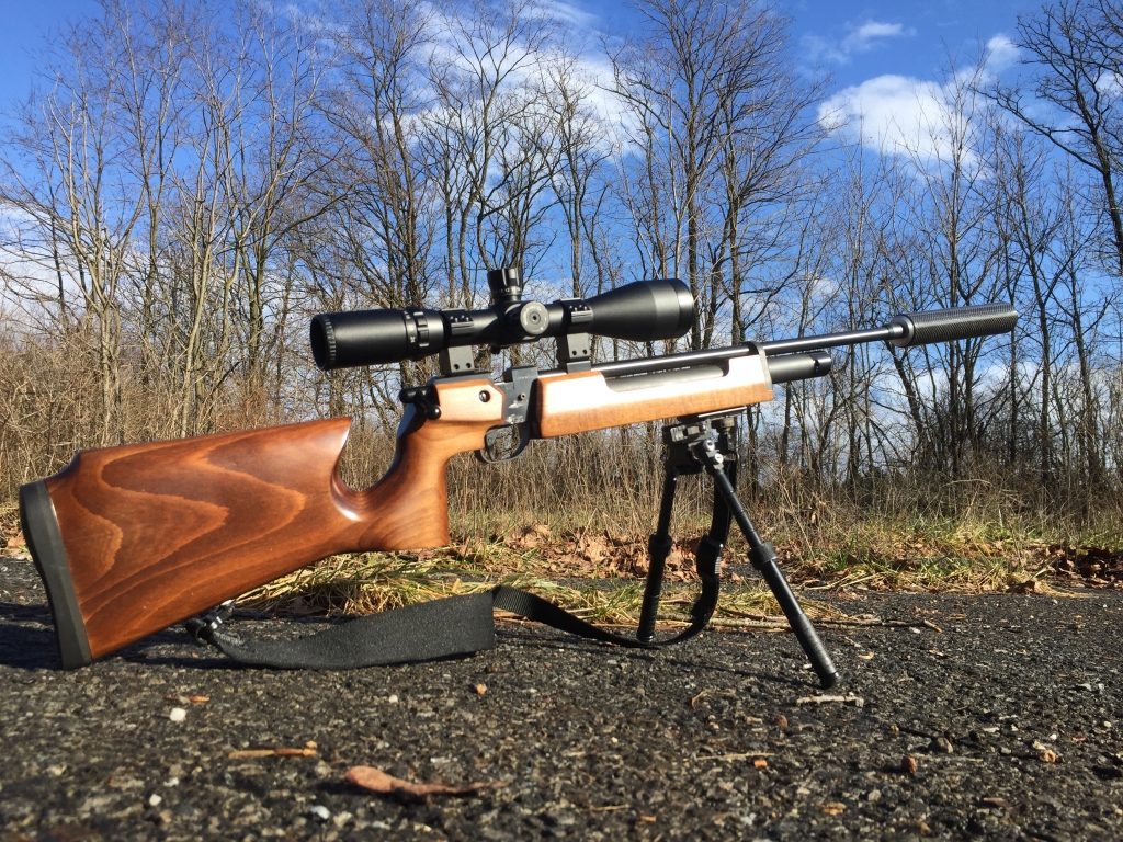

Not for everyone, but this is my .177. I have tuned it for pellets ranging from 10.34 to 16.2. I am now shooting the 15.5 grn NSA slugs. This is a higher power .177. On the current tune the slugs fly at 905 fps. The exact same tune pushes the 16.2 grn Beasts at 933. It is becoming my go to all round pesting rifle. BC on the slugs is approaching .07. They retain great energy for pesting beyond my effective shooting range.

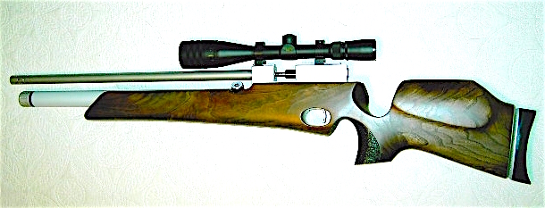

I bought a RAW HM1000 (Hunting Model in .177) 2 years ago and I have not really used my other guns since. I shoot Field Target but my RAW is laser accurate to 60 yards (I have not tried it past that), gets approx. 125 regulated (20 shot ES 11 and SD 2) shots a fill (480cc bottle) and shoots JSB 10.34 at 900 fps for about 18.5 FPE. Accurate and more than enough power for any of the small pests you want to eliminate. Hope this helps.

I've owned several regulated PCPs now, and the only ONE that has not developed regulator related issues requiring service is my RAW TM1000. The RAWs are also top quality, SIMPLE, built like a tank, and will shoot with any PCP made.

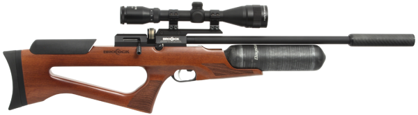

Aforementioned regulator related issues are the primary reason(s) the last hunting-type PCP I bought is a .22 Brocock Bantam HiLite that is unregulated, but uses a Slingshot hammer/valve system that gives near regulated performance and has been utterly dependable. Also available in .177.
