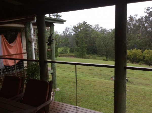

This is a picture of our house dam, the back wall of the dam is approx 95 meters from our back deck. I want to build a pellet trap that is interactive (spinners and such) that is both challenging to hit and stands up to all types of weather.
It must also be able to trap the pellets. I used to shoot tennis balls hung from one of the trees at the back of the dam wall by wire. The only problem with that is that it wasn’t environmentally friendly and it started to look like the scene in Predator when Arnie and his crew cut half the Forrest down shooting at the nasty.
