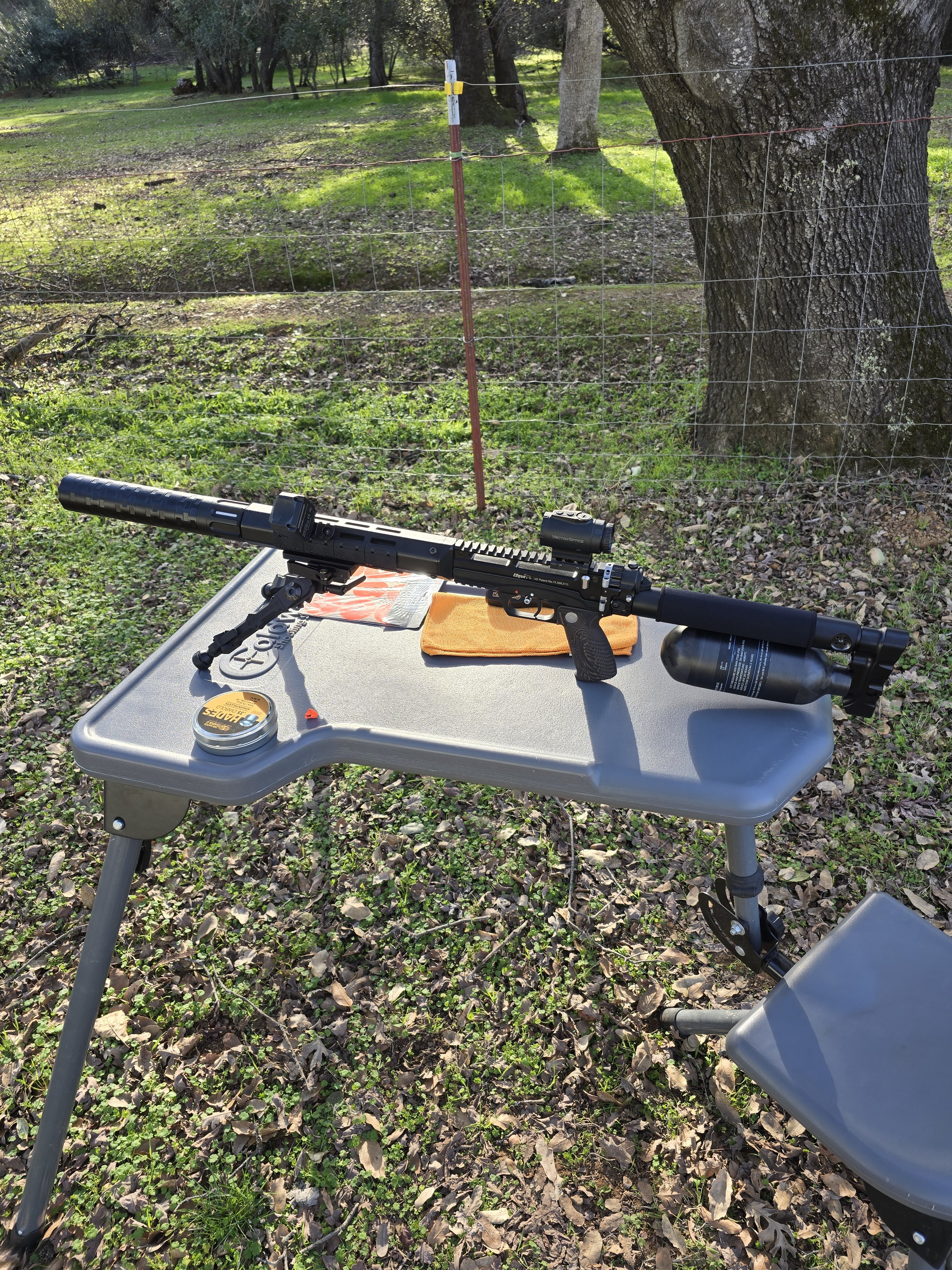

The Stable Table, the $249 one, is a tripod. The way it works is that when you sit in the seat it locks it all up rigid. To swivel the top you loosen a wing nut under the table and turn it. Or, you can loosen the wing nut at the base and relieve your weight on the seat to rotate the whole thing. One of the tripod legs also has a wingnut on it that allows decent level adjustment. Again, it is surprisingly stable for a portable bench. And even at the regular price vs the cost of lumber and materials and gas money to go get it all, Amazon would probably deliver the thing to your door. In fact I just looked and saw it priced at $212.
One thing about it. The Caldwell Stinger feet are kinda slippery on the reinforced plastic table top and with each shot, even a .25 M-Rod, the rifle Stinger rest tends to walk backwards, so then I scooch back and pretty soon I did a somersault off the bench and my wife spit up her cocktail and choked :giggle:. So be warned, the seat has no back! I am probably going to get a piece of hardwood and make a .5X.5 strip and screw it to the top all the way aft to act as a stop. Shooting my several .45-70 Marlin 1895 rifles with Level 2 Marlin "Bear" loads, close to 3,500 fpe, I need some sort of stop to keep me from going flying. It is surprising how much my lightweight .25 M-Rod (aluminum tubes and other stuff) will walk back, there is recoil! Another possibility would be to pop rivet or screw a piece of indoor/outdoor carpet to the top surface to provide more traction.
I do agree that an Arca type head and a good tripod and a camp stool can be surprisingly good. Last year I bought one of those pop up tent blinds at Walmart on close out for like $50. I can get inside the blind with my tripod set up and stool and snipe away at pesky HOSPs, raccoons, whatnot, and they never figure out where I am or what is going on as their buddies explode.
Edit to add, I was reading through some of the reviews, most are five stars but a few complained, for example, one fellow with a bolt action rifle was removing the bolt to sight through the bore while standing. His complaint was that the table was not stable because then when he sat down on the seat, the bore axis was misaligned! Of course it was, the Stable Table, as I noted before, it is the human component that locks the table solid. There is no substitute for a concrete bench ;).

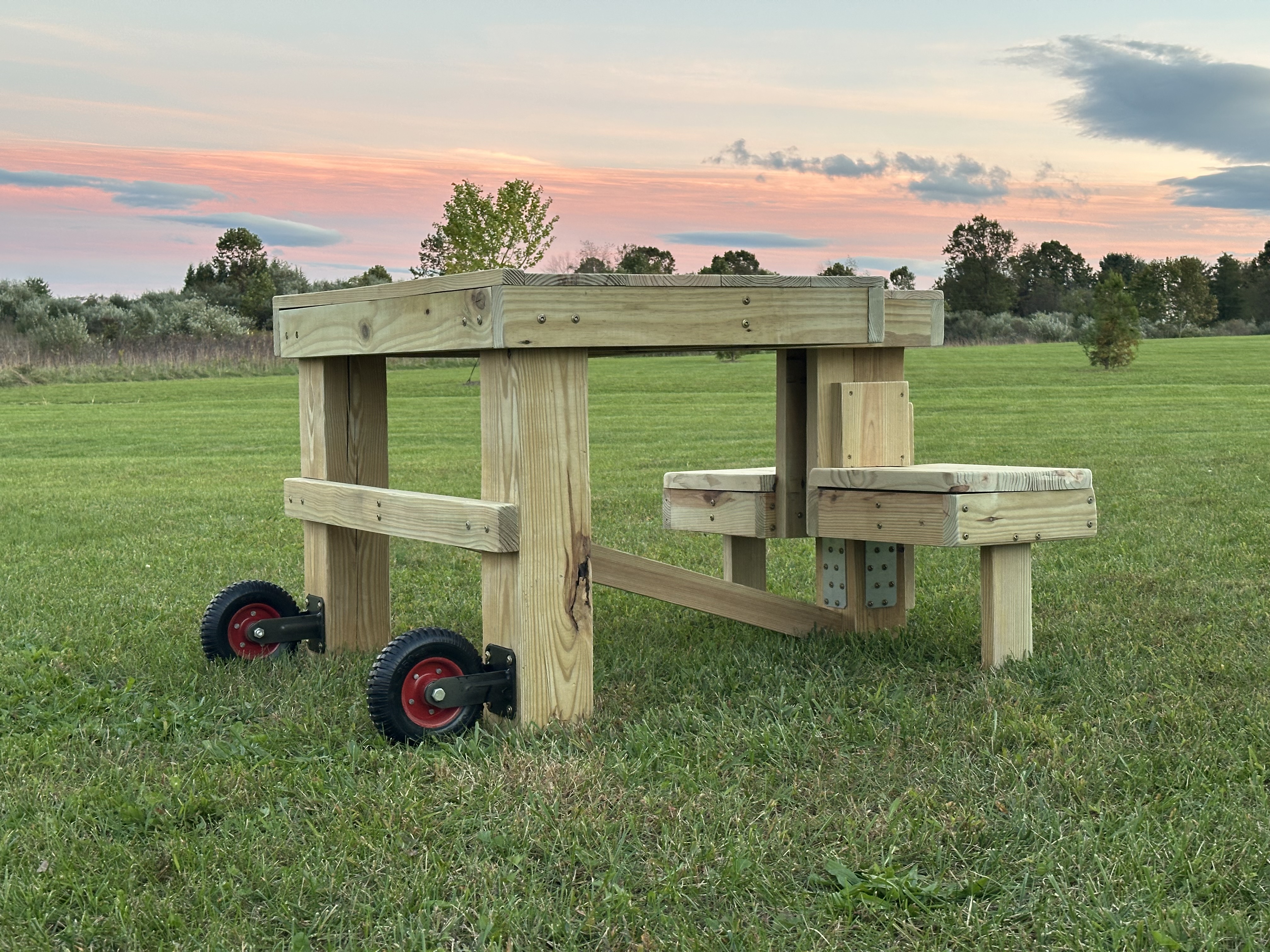

Build one, add some wheels and it’s portable around the yard. Doubles as a great table for fires too!

I really like that bench! where did you get the wheels?
The store that has everything you could imagine and then some… Amazon 🤣 —— Link
Used a bunch of leftovers after building a deck - super simple.. The wheels only engage when you raise the back, so it’s really stable once you’ve got it positioned. Once it’s warmer, I’ll put an attachment behind the seats so I can tow it with the tractor… It stores nicely.
Highly recommend building in a little cubby towards the back. Perfect for holding things (like ammo, a speaker, or beverages) when on an incline.

Great thanks!
I have heard some folks, not in this thread, state that the Caldwell table fell backwards with them in the seat. In order to prevent that possibility for those who might be more generous in their dimensions, position one leg of the table legs more or less under the seat. Now, to be truthful, I have fallen off the seat but have had no issue with the table being unstable with me seated. But I am 170 pounds. The maximum weight is 275 pounds, I could see a 300 pounder flipping thre table if the seat were located between two legs rather than over an aft pointing leg. If that makes sense ;).
