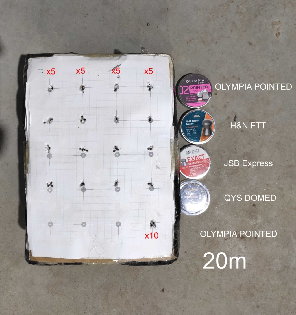

Red Wolf .177 / 12 fpe and 22 yd. ( 20 m )
x5 per point and last x10 olympia pointed heavy
outside bad, was a wind - so only the picture
