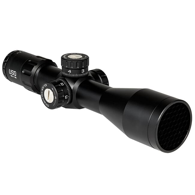

I have one of these coming next week for mine. I currently have a Nightforce NX8 2.5-20 on it. It is great but heavy. I like about 6-10X most of the time. This one may fit the bill. Fingers crossed. BTW... the TS 12X is 9.6 inches long.
US Optics 3-12x42mm Non-Illuminated FFP MHR Reticle .1mrad TS-12X-MHR
How far are you planning on shooting? Do you have a preference over the amount of magnification you want/need? You just said you want more than 6x, but that still leaves a very wide range of available magnificaiton. For that rifle, I assume it is more of a stalking/hunting type of tool, also based on your other comments. If so, you won't need a lot of magnification, and if that is the case, you most likely also don't need to spend $1k. This is coming from someone who likes $1k scopes, but not in lower power scopes.

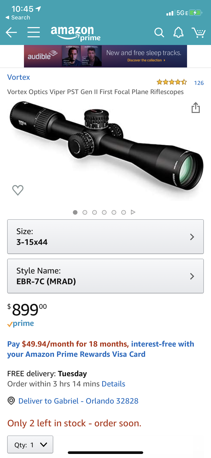

I hear you. I have the money, but it doesnt mean i need to spend it. And i am really double thinking it. I based it off what many centerfire friends would tell me. Many of them carry nothing but nightforce on their guns. Talk about money... ugh :( Crazy, but awsome for them :)
Tac Vector??? let me look at it. I think i am going to put the Dedal on the Leshiy for now. And see what you all have recommended. Right now i am leaning to a Atholon. lower midrange of their models. Get used to the rifle and using a scope better. When i get bettter, maybe i can justify getting more. I am trying to stick to FFP. It is really helping me with my eyes as i am aging. The reticle enlarging has been a blessing on higher magnification.

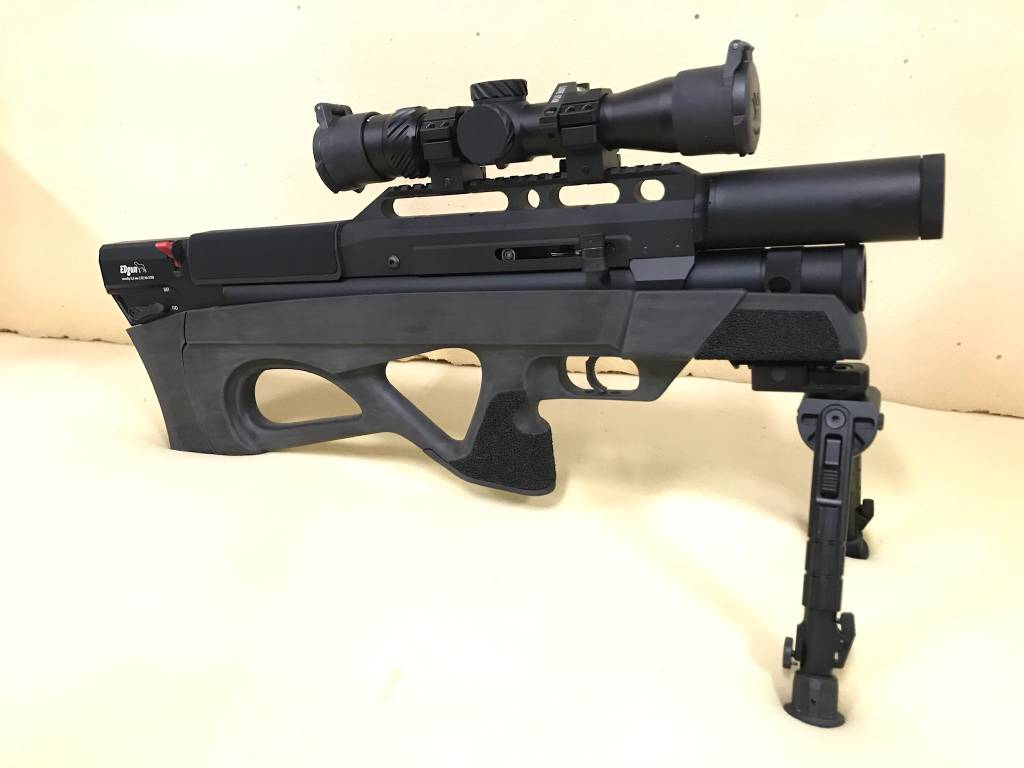

I went with an Optisan 3-12x32 https://www.airgunnation.com/topic/optisan-cp-3-12x32p-with-the-mil-mh10x-reticle/
Here’s what it looks like on my Lelya
Wondering how this ended up working out on your Lelya 2.0?
I find the turrets and reticle to be accurate. The glass is quite clear and reticle is crisp. Size and weight are on point for a short Bullpup.
The reticle gets too fine at and below 6X. I would say it is usable at 6-12X.

I don't want to pull an ODoiyle here and offend anyone, but that US Optics scope is the same 'glass' (maybe not turrets and reticle style) as the Discovery 3-12 scopes for $200. Not saying there is anything wrong with it - I use a Disco FFP version on one airgun.
