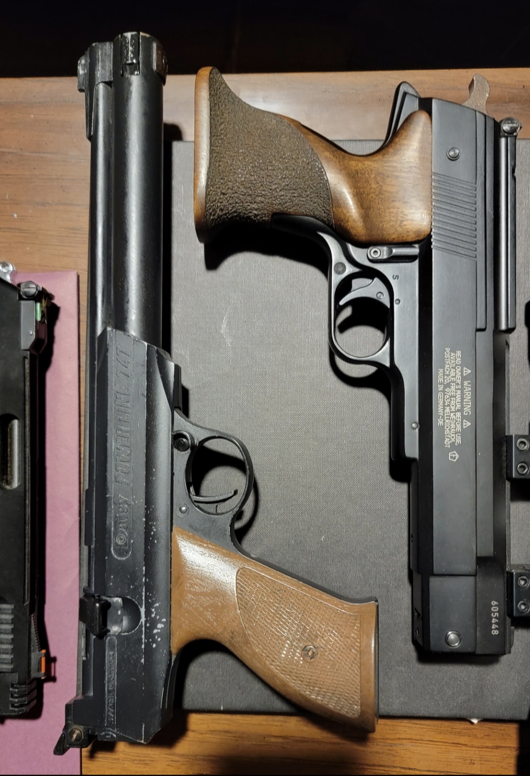

There a GREAT pistol the Alfa Proj ... starter or otherwise !!!
Same for the IZH-46's

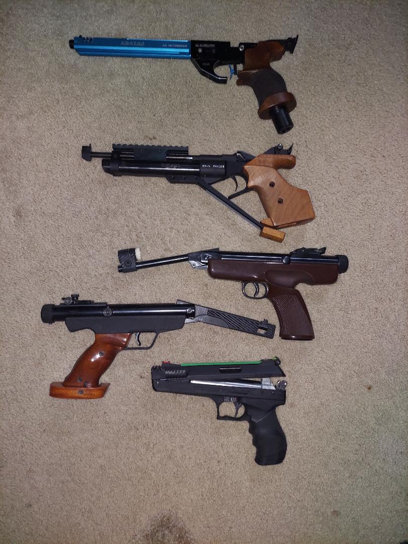

Personally have 1 of each along with a Winchester 365 version of the Diana 6M giss
