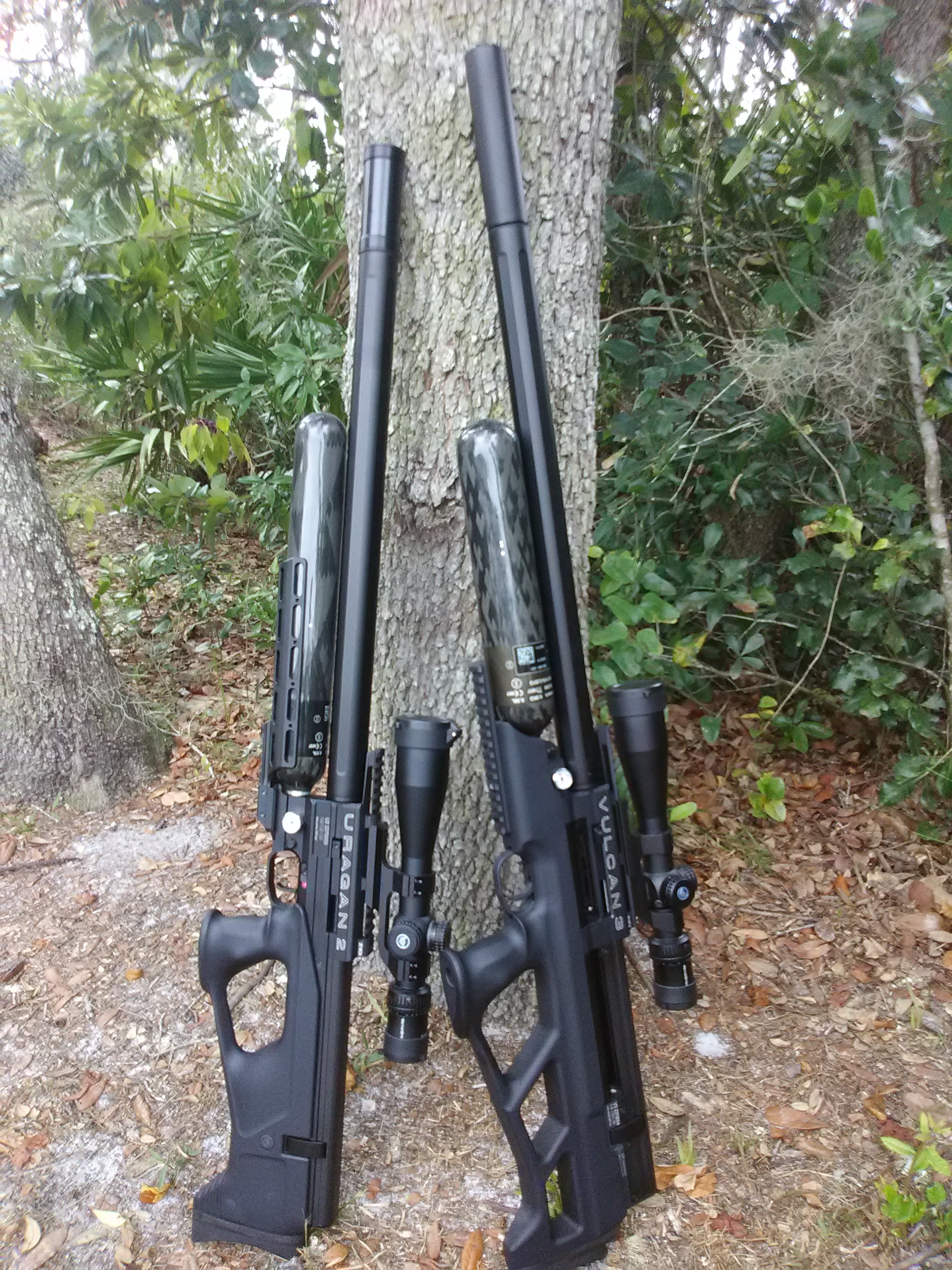

Either of these will work, both .30 (700mm). Bought several months apart from Krale, shooting JSB 44.75s in 980s, out-of-box. Prefer Uragan 2, smoother, quieter, less ammo fussy. V3 likes NSA 61.5g, both shoot ZAN 59g dead-on @ 50yds in 800s @ factory settings. RTI Mora or High Power Vulcan 3 will shoot slugs faster. WM

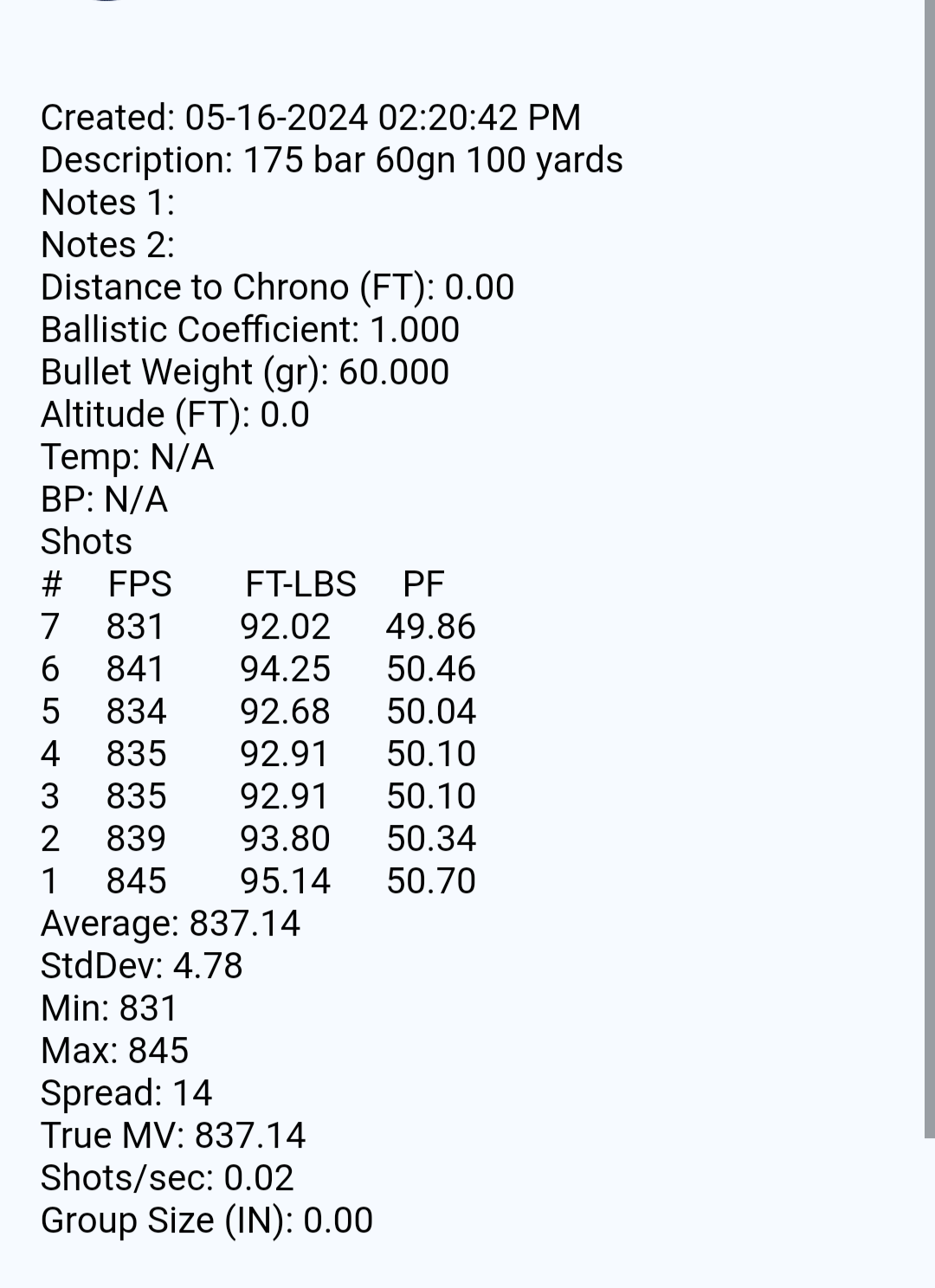

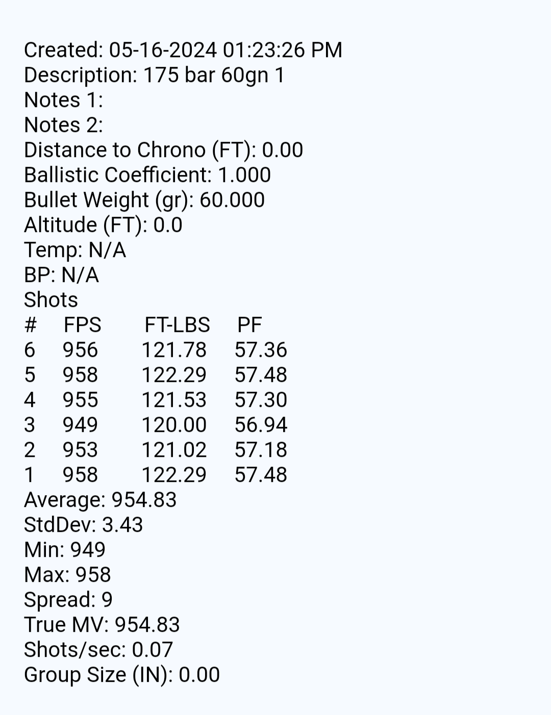

I have a 30 caliber AGT Vulcan 3
I was shooting 55gn slugs @ 960 fps ( 112 ft lbs) when I took this rabbit... Entered his eye, then proceeded to remove all brain matter from skull.
@ 100yds it's still moving @ 843 fps (86 ft lbs)
Recommended ft lbs of energy for hunting coyote is only 50 ft lbs so this is way above that even at 100 yds.
I actually tuned it down a tad, was shooting 60gn slugs @ 954 fps (120+ ft lbs)
