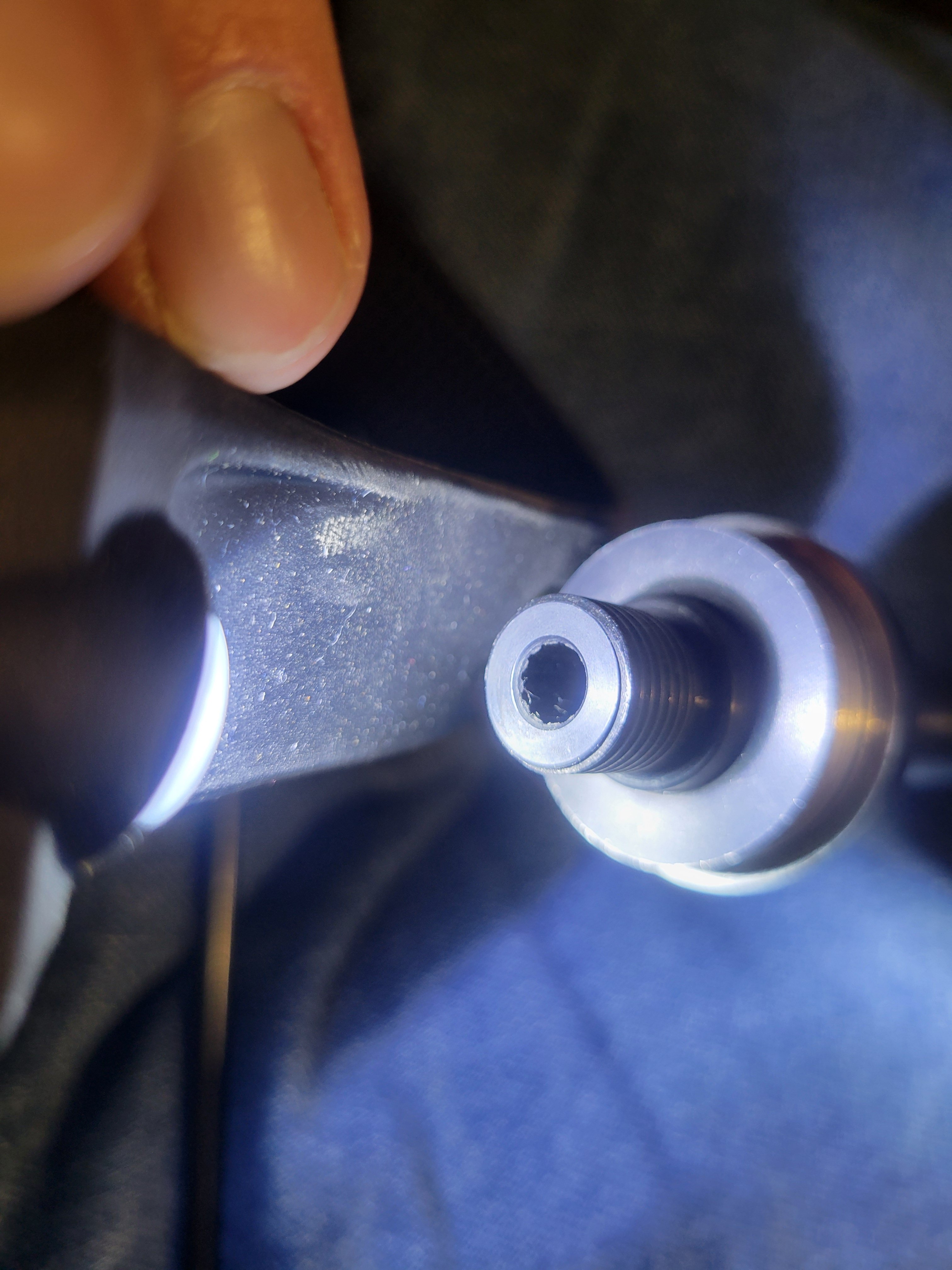

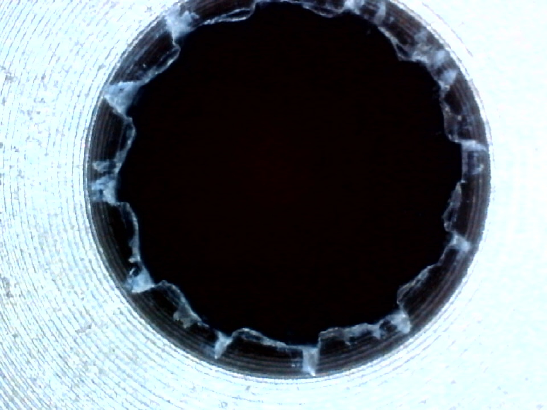

I have recently done some work on my .177 Veterans barrel crown, polish barrel, and worked on the transition from the aluminum transfer port to the lands of the barrel . The barrel was not finished very well in that area just like the crown. When I slugged the barrel I first sized the pellets by pushing them thru the aluminum transfer port and into the barrel stopping several pellets In the breech end and pushed them back out the breech those pellets showed quite a bit of damage from engaging with the sharp lands so I did a little work in that area until test pellets showed improvement, of the work done on this barrel I think this is what made the most improvement. The gun went from extremely pellet picky to a social butterfly.
I have three guns with this same barrel (CZUB) two Veterans a .22 and .177 and an AGT .177 Vixen although not as pellet picky they will all get this treatment.

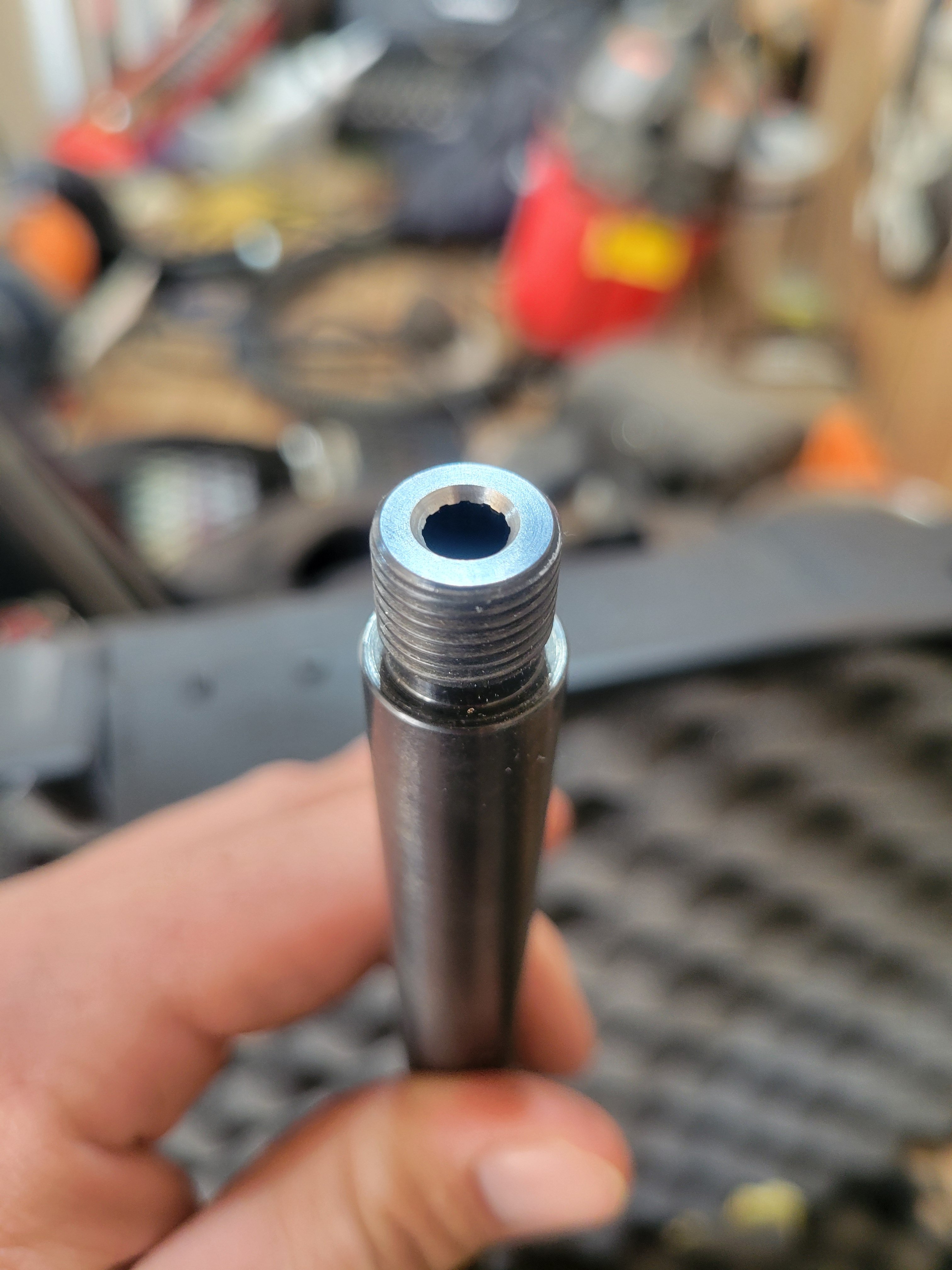

Lol I had to crown my .22 Long also. Haven't checked my .22 short as it shoots very well as is. But this was mine. As you can see i had to remove alot of material. Pushing a pellet throught the breech end though wasn't too bad at all. I'm sure alittle dress up of those lands wouldn't hurt but really it shoots so good don't want to mess with it. Day and night difference in accuracy and pellet pickiness also.

That crown is gorgeous! That is definitely a LOT of material removed. Did you use the brass screw method?

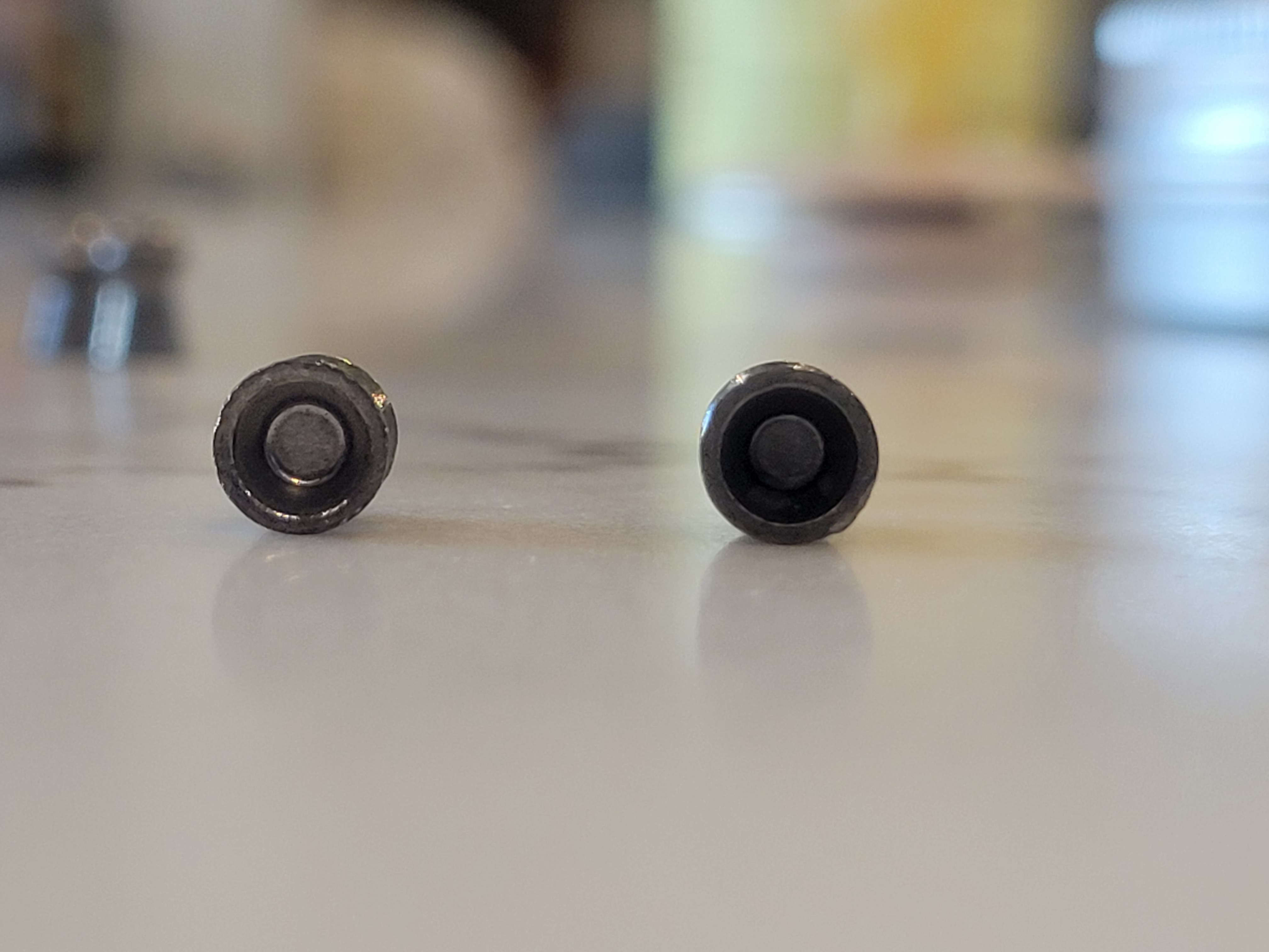

They arrived today.

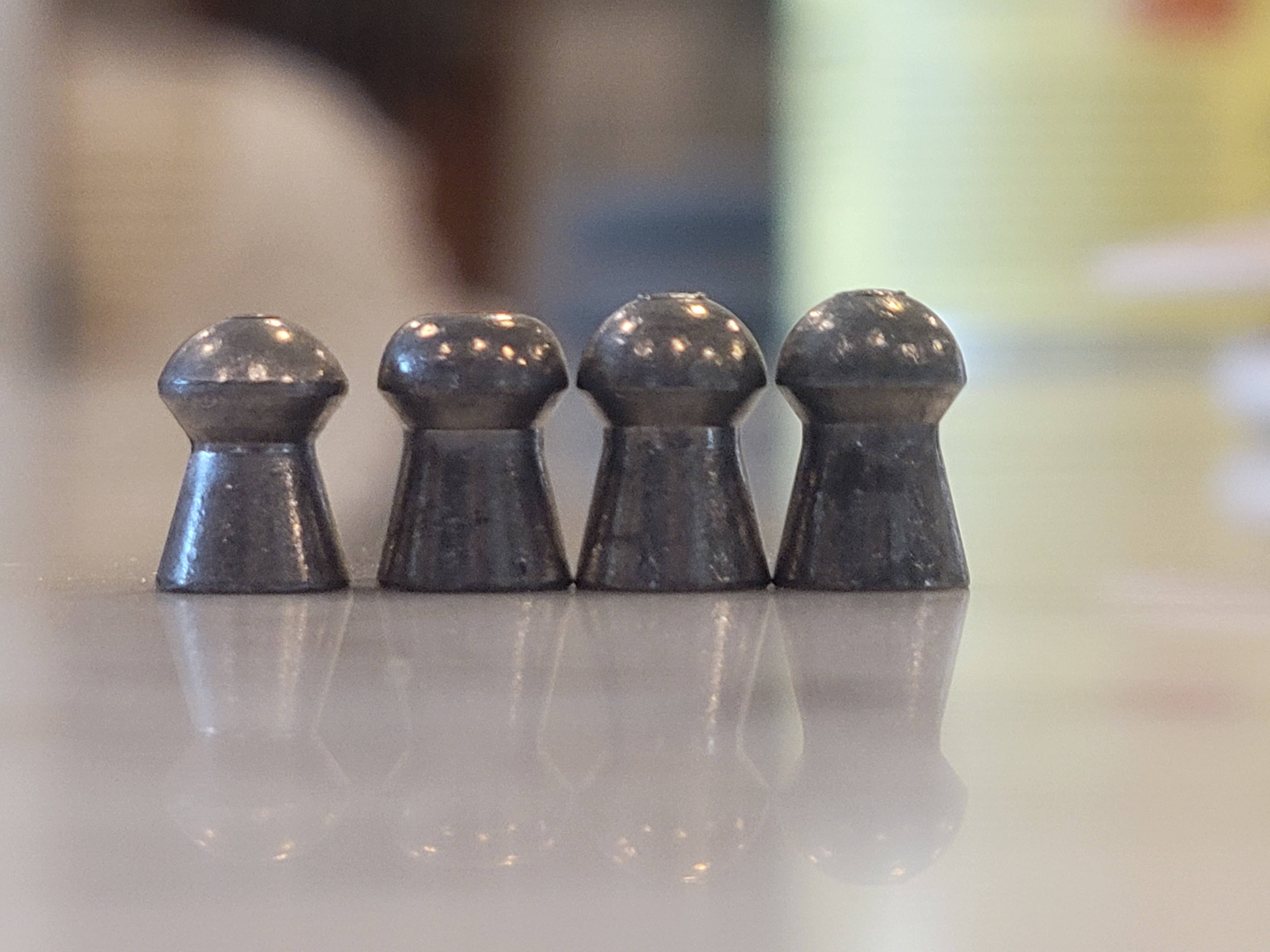

Left to right
JTS 18gr, JTS 21.53gr, JTS 22.07gr AEA 21.9gr

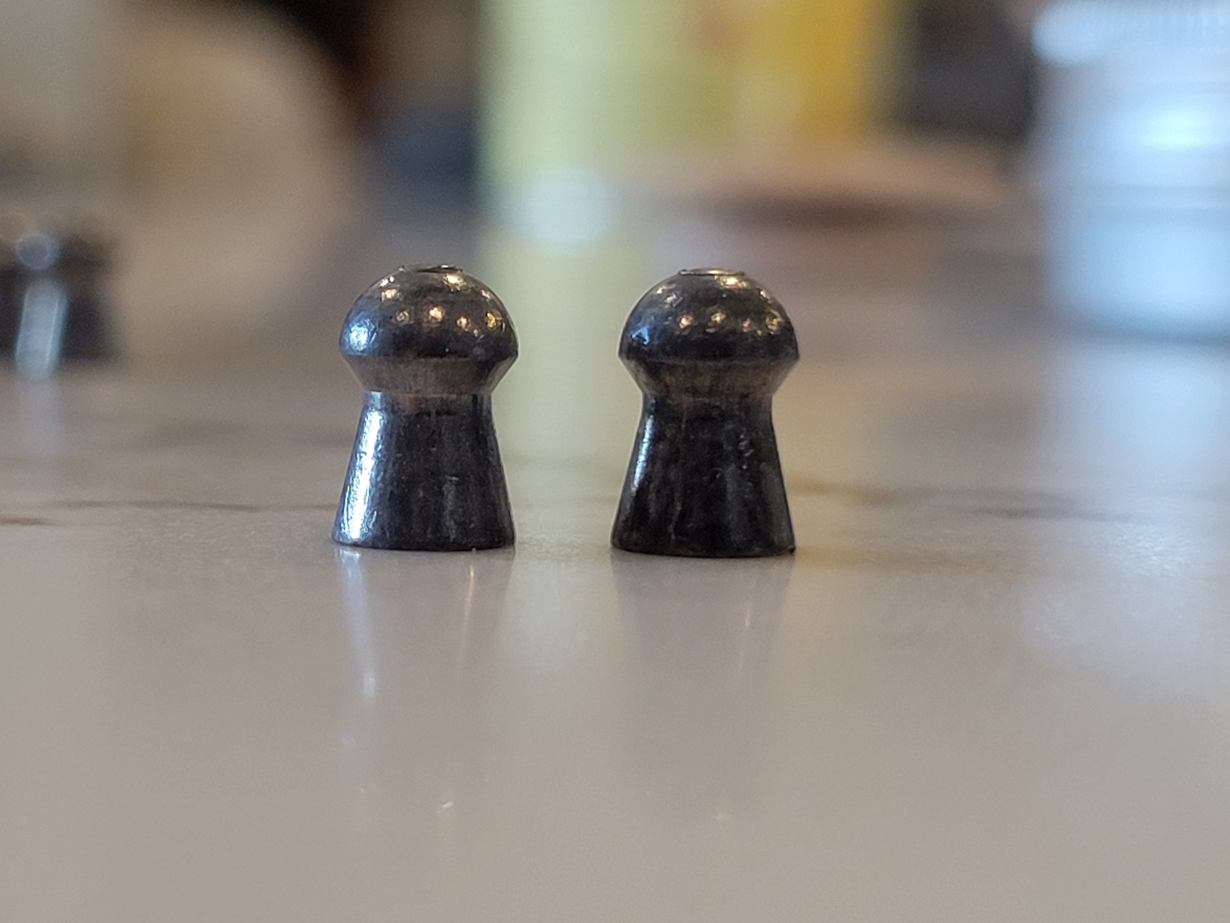

JTS 22.07gr and AEA 21.9gr
It's very hard to tell any difference between the JTS 22.07gr and AEA 21.9gr. AEA has a thicker skirt and deeper than the JTS. Other than that they look identical.
JTS 18gr is around a .217/.2175, the 21.53gr and 22.07 is. 218/.2185. Then the AEA 21.9gr is .2185/.219.

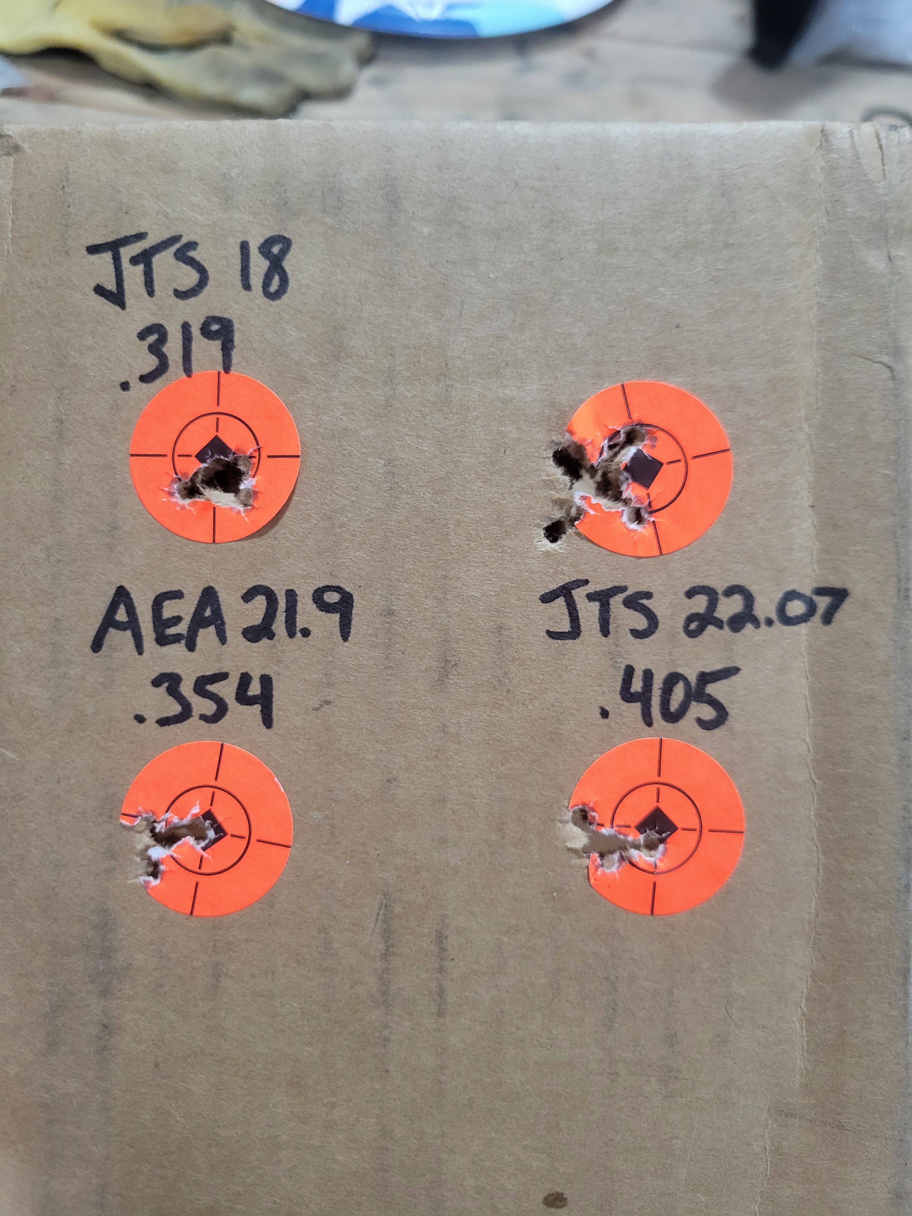

Had alittle time before work to do some comparison at 50yds. Top left JTS 18gr gun sat for a week without being shot even rode in my truck for a day or 2. First 5 shots just dead on. Top right was my "seasoning" target and shot 5 shot with AEA 21.9gr then moved to bottom left for official 5 shot group. Did the same for the JTS 22.07gr. 5 shots at "seasoning" target then 5 bottom right for official 5 shot group. As can see there is some definite potential here and likely warrants a speed increase to see how they do with more speed. Avg speed with my 18gr was 920fps. Avg for the 21.9gr were 833fps. The real test will be 100yds. I don't think I'll have time for that today but if I do I will try to.
