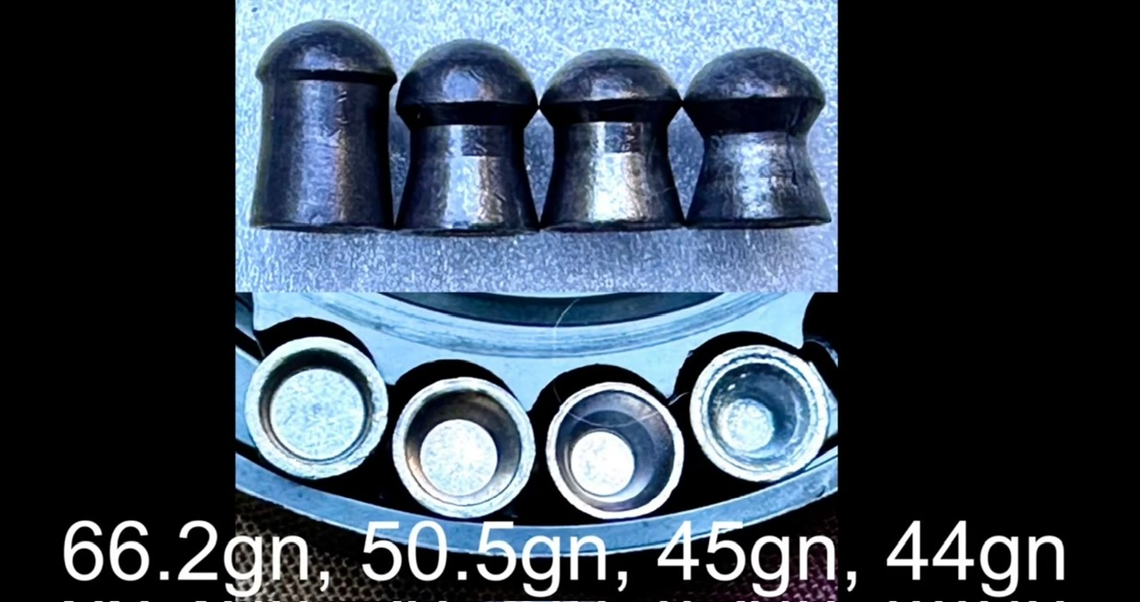

AEA .30 caliber 66 grain pellets!!!

I would have to analyse one to find out where the aerodynamic centre and CG are. If they are too close then you will need less spin, but group sizes may suffer. If they are very close/ in the same place, then you have a projectile which is neither like a slug nor a pellet and will not be good at all, as the aerodynamic centre may move from one side of the CG to the other.
If they are a perfect fit to the barrel, then you may get acceptable short range behaviour. Seeing pellets with shallow base cavities always makes me nervous.

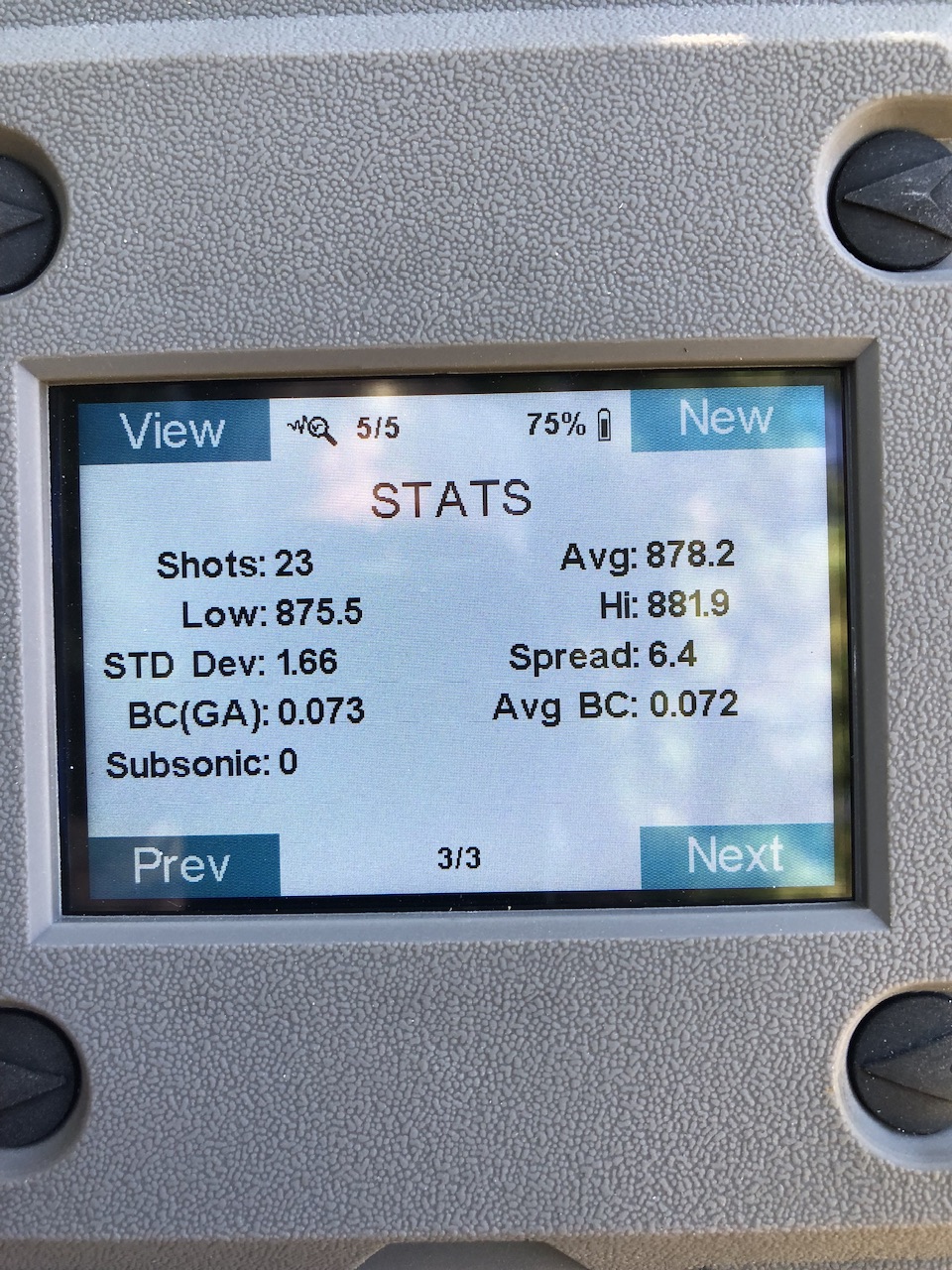

I tried these out this morning at 100 yards. Adjusted Skout Epoch to 1925 psi HP reg for about 875 to 880 fps. Could have gone faster but didn’t want to adjust 1st stage reg (need to remove bottle for that).
It shot well about 1/2 and the other 1/2 were spirals. I think probably a slow twist 1:40 is not good with these Pell-Lugs. My guess is if you have an older 1:22 twist .30 caliber liner they just might shoot well.
That’s the main reason I didn’t jack up the pressure to increase speed. It wouldn’t have helped.
Here’s what I saw on the chrony.
BC is a disappointment and no better than the AEA 50.5s. Probably lower than expected due to the spiraling. Since they are so big and going at only 880 fps it was easy to watch the spiral to the target. About 1/2 of them spiraled. The ones that didn’t hit right where I was aiming.
I’d guess they will shoot well in 1:24 Pandy or 1:26 SubMOA barrels…
Glad I only bought two tins. Afterwards I shot some 50.5 AEA without adjustment and they were going about 990 fps! NOT accurate at that speed! Dialed back down to 910 fps and shot 3 ten shot cloverleafs so that’s what I’ll use for this next season…
