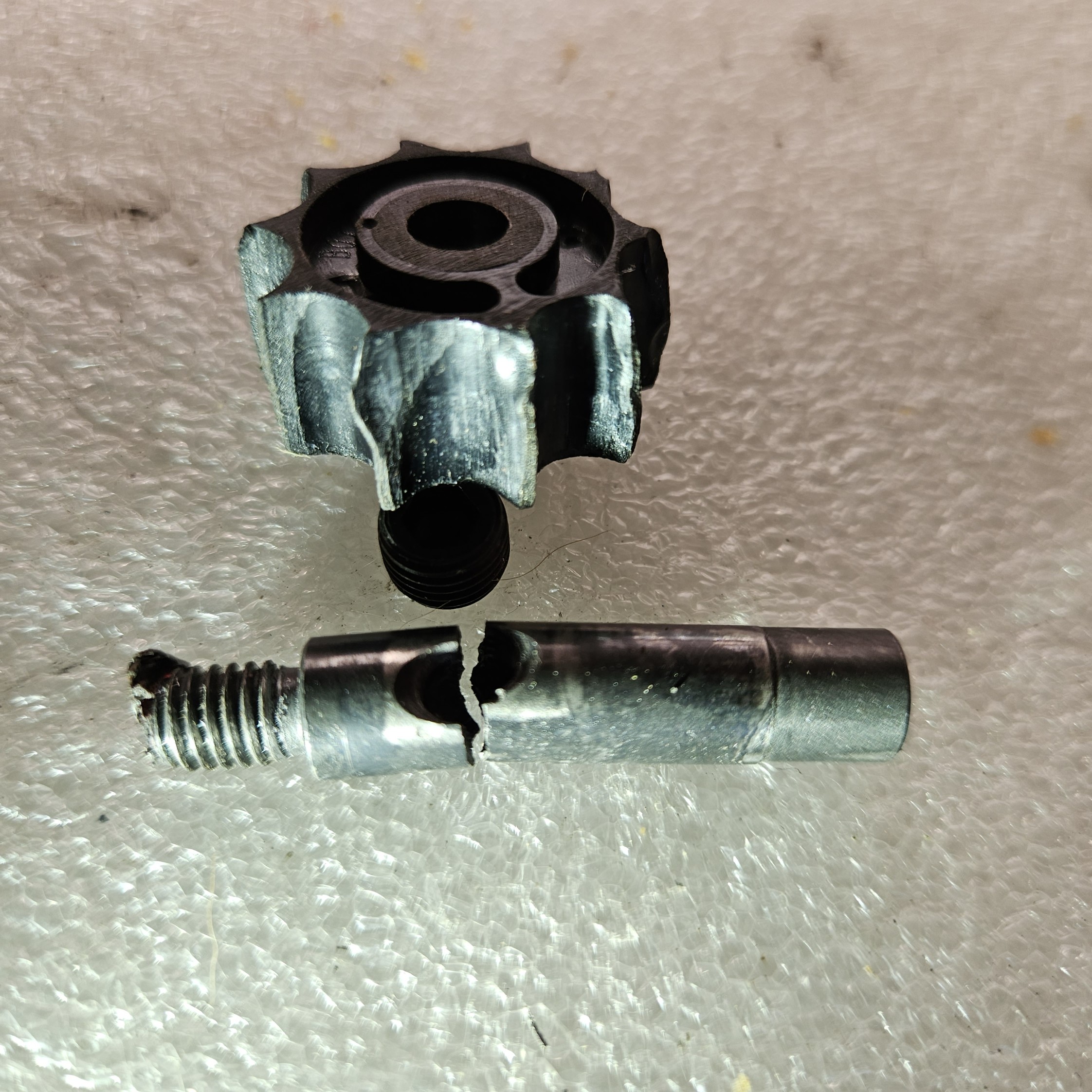

The magazines carosel or star wheel becomes deformed after some jams. This will index the pellet out of alignment and cause further and increasing jamming. It is seldom one issue contributing to the gun failing. IME it is a combintion of dirt, ammo , seal failures, mags and pellet. I have mine cranked up to shoot hard. I have found slugs work much better than pellets I also found the longer the pellet or slug the better it feeds. Camfering the breech slightly may help but good mags is what you need for these guns to operate properly. Pic is a bolt from a HP Carbine and star wheel from the mag. If they are damaged or deformed you can see how they will index off center.
