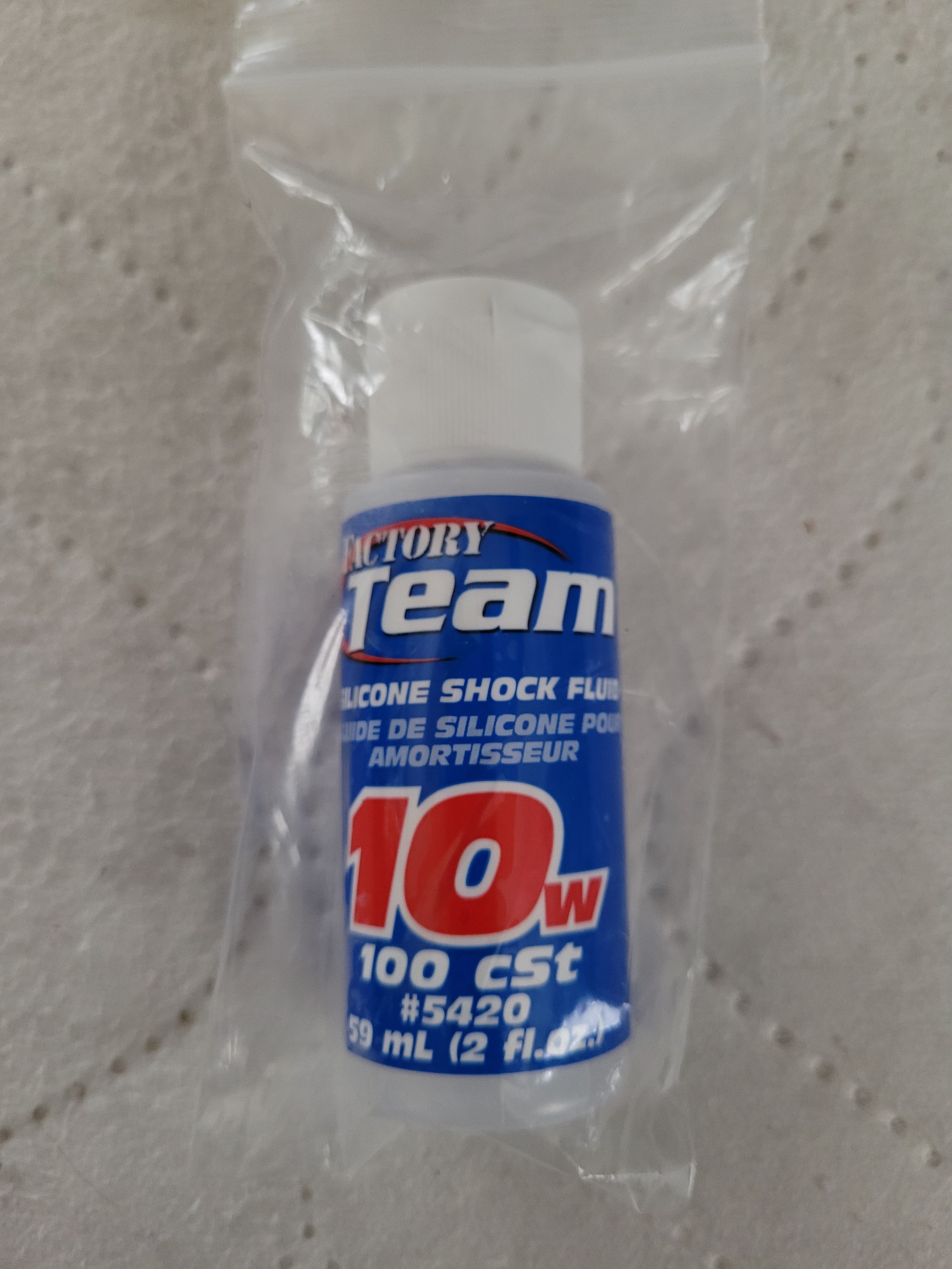

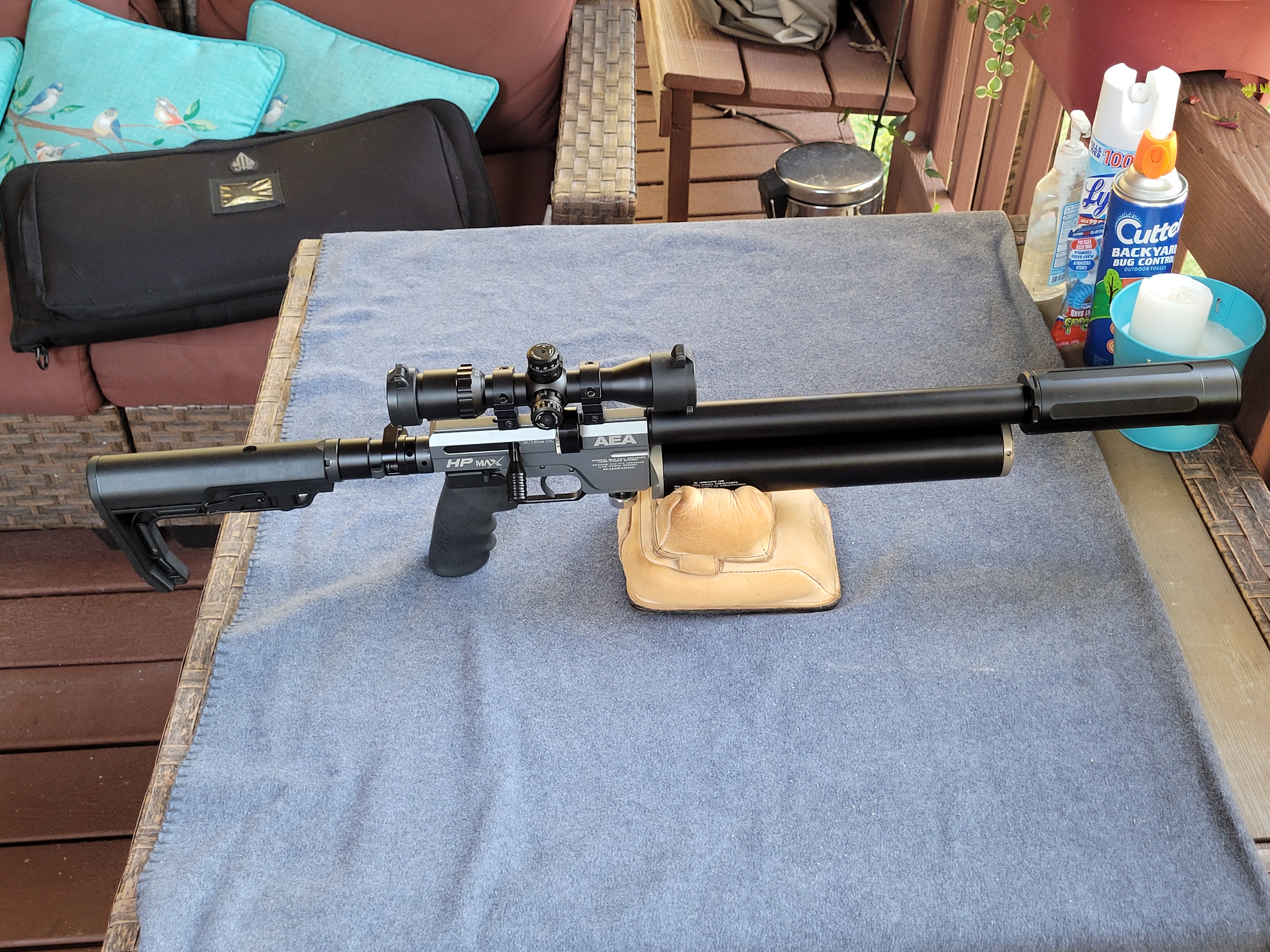

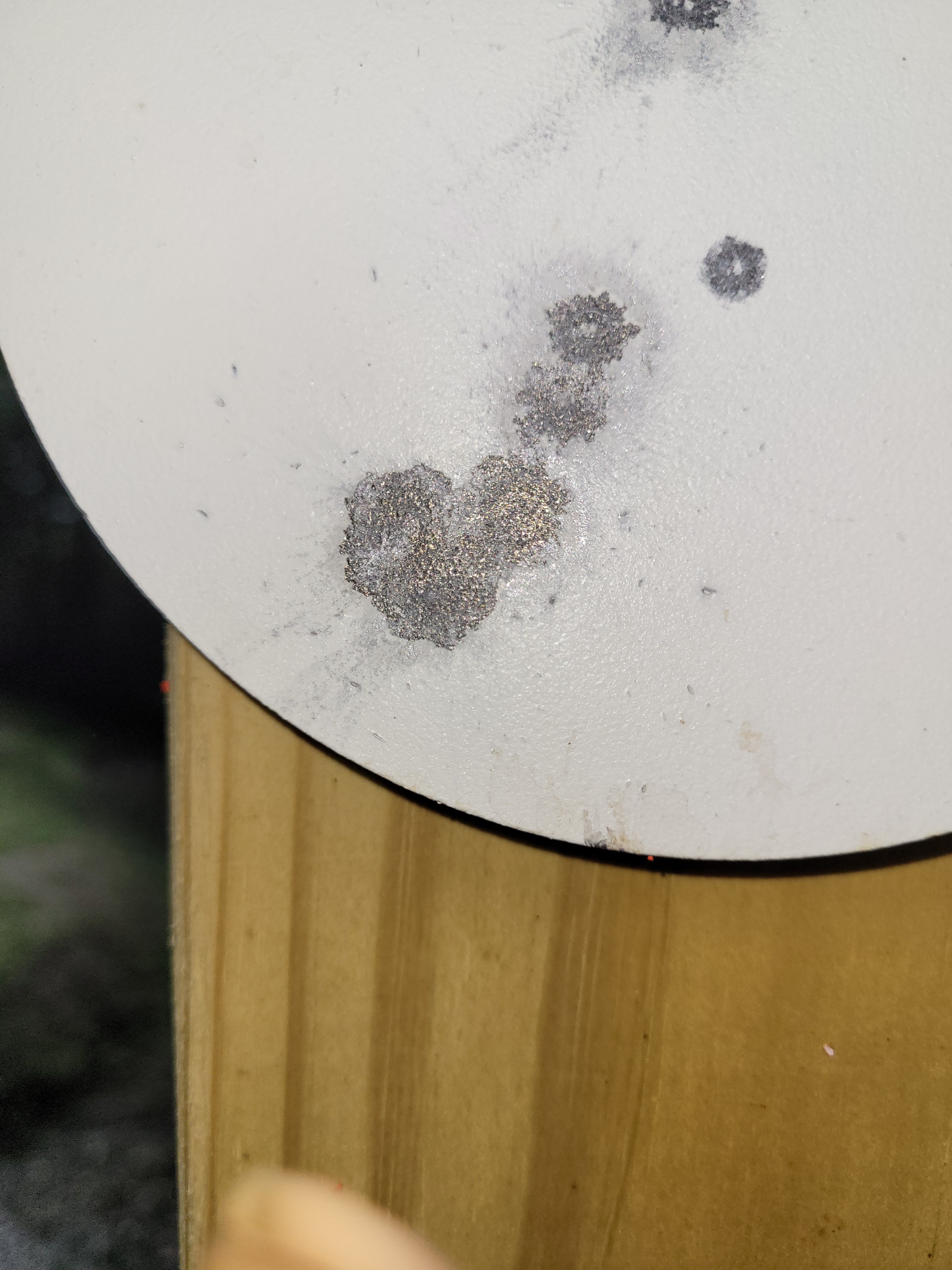

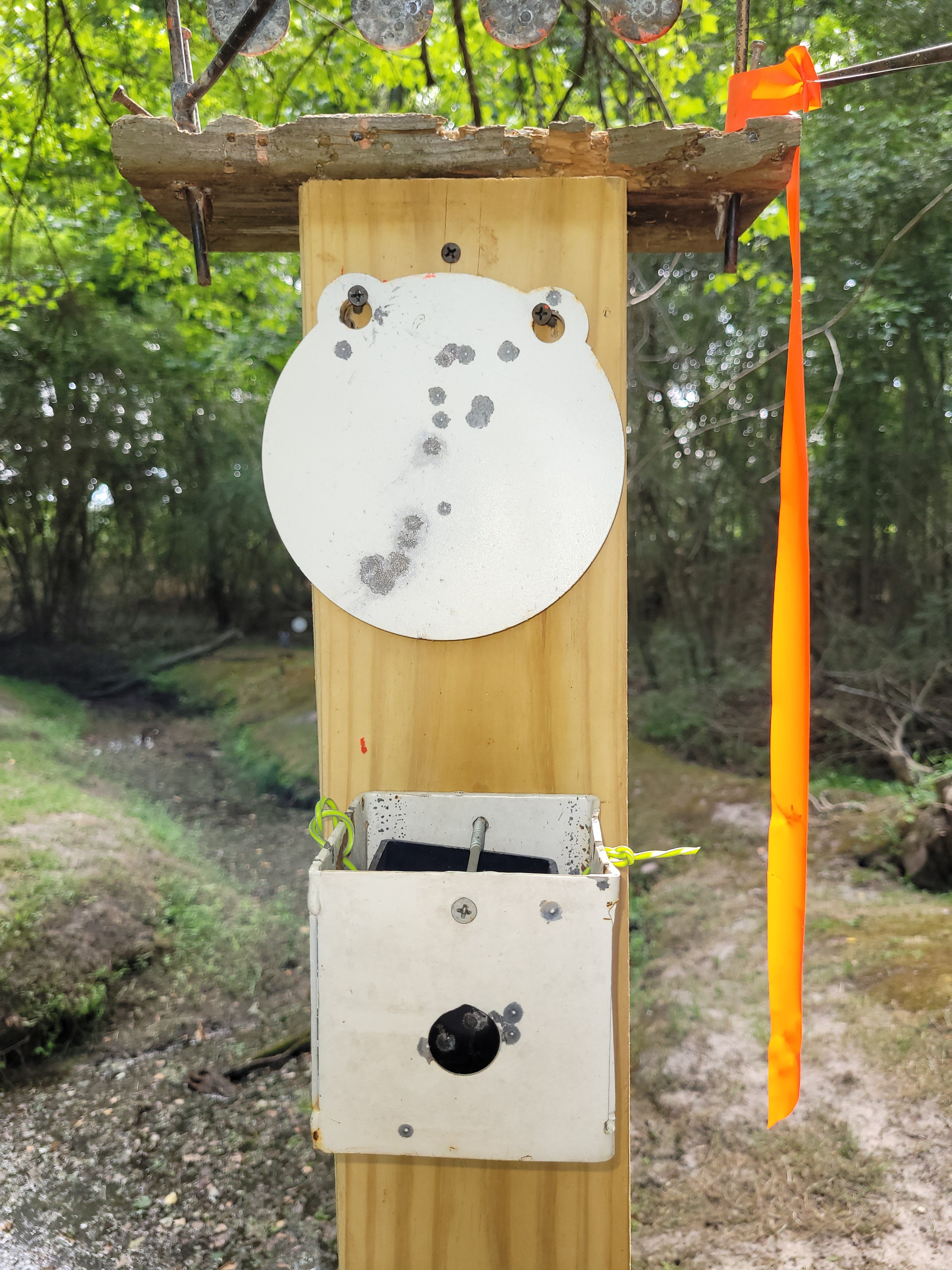

My aea hp max .30 bbl love the nsa 47.2.. 303 slugs also. You need to keep the bbl clean and i lube with 10w silicone shock fluid. They shoot very good from a 13" bbl. This target a 55 yds. After scope adj got the cloverleaf @ 900 fps ave.
Pretty encouraging results good sir. I really look forward to getting the 47.2 slugs and giving them a go. Thanks again for the tip on using the silicon shock fluid. I have some silicon oil, but would like to try some of the 10w you mention. Where did you pick up your bottle?
You can get that oil on Amazon or at a hobby store I use the same stuff on my rc car shocks

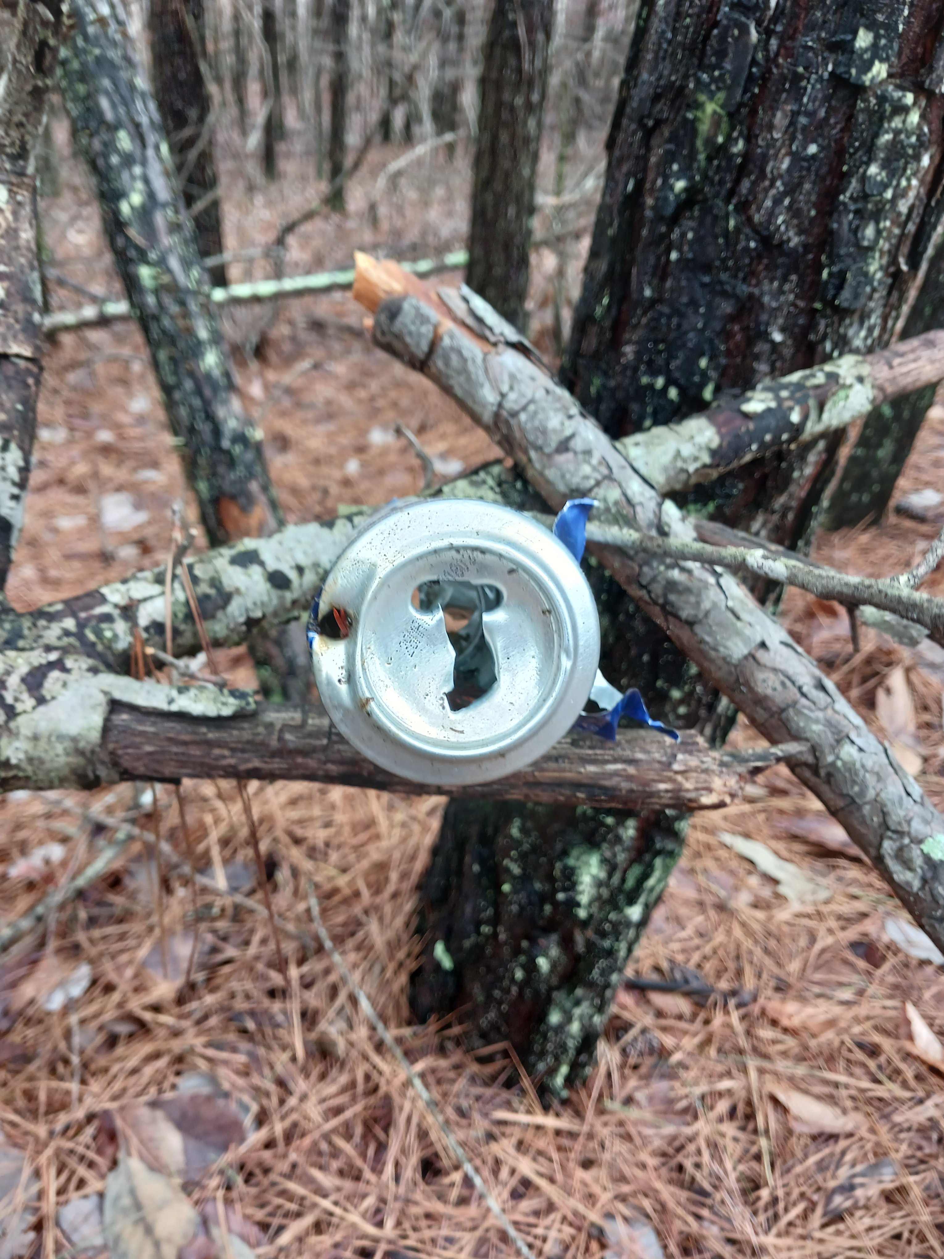

Made it out to the WMA this afternoon for a short walk about. Found a good spot to do a rough sight in for the 47.2 gn slugs and a hoppy beverage can for a target at 40 yards. Standing, steadying against a tree, I was able to adjust the 2 moa Sig Romeo5 red dot optic on my Challenger and shoot the group below. I know these will be tighter with proper sight in, but I was very pleased with the performance of Nick's 47.2 .303 slugs in the Challenger. Looks like slugs in .303 are the ticket for AEA .30 cals.
