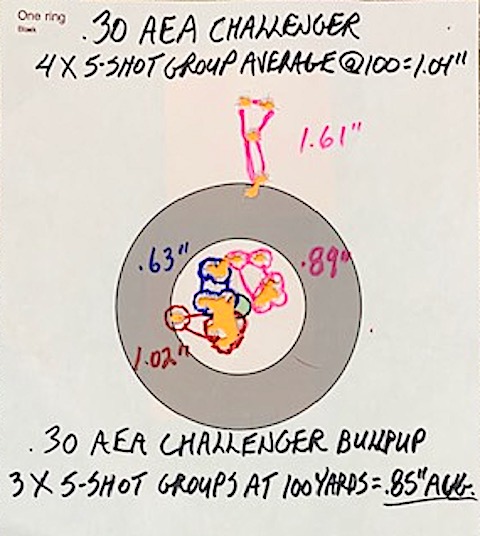

I bought my .30 AEA Challenger BULLPUP not only to get a 32" barrel in only a 41" rifle, but knowing that long-ass barrel would allow a lot of DE-tuning of the beast down in power to still shoot .30 pellets about 900 FPS. I did this to see if such a cheap-ass Chinese PCP could be transformed into a viable Extreme Field Target rifle (100 foot pounds maximum). With more experience DE-tuning Korean maxi-blaster PCPs into competition-worthiness than anyone, I recognized similar potentials in the .30 bullpup.
It took a LOT of doing; including lighter hammer and trigger springs, moly-lubing the firing and trigger actions, JB Bore pasting the bore, and polishing the muzzle crown, but the result was this-

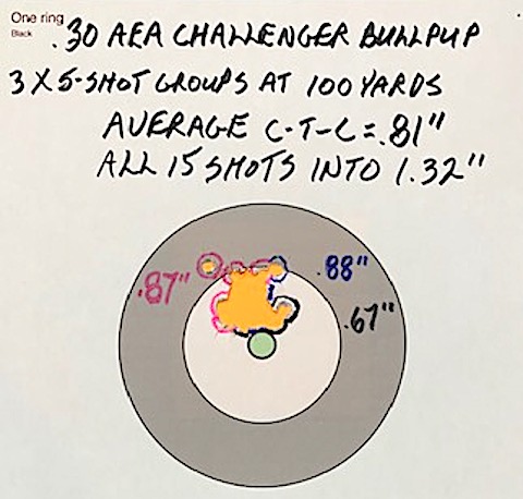

Unfortunately the 300 cc chamber-tube returned only 8 competition-worthy shots per 120 BAR/1750 PSI fill. But since she was as accurate at 100 yards as any airgun at any price, I invested in a Huma regulator to bring the shot-count up to 24 from a 280 BAR/4100 PSI fill. I eventually achieved the finest 100 yard accuracy I've ever recorded in 30+ years of testing hundreds of airguns-
Some keyboard warriors have questioned my results, sanity, and/or honesty in reporting these results, no doubt because they possess neither the experience, airgunsmithing, nor shooting skills to achieve such accuracy... with any airgun. I don't bother defending myself from their insinuations, as my record speaks for me.
