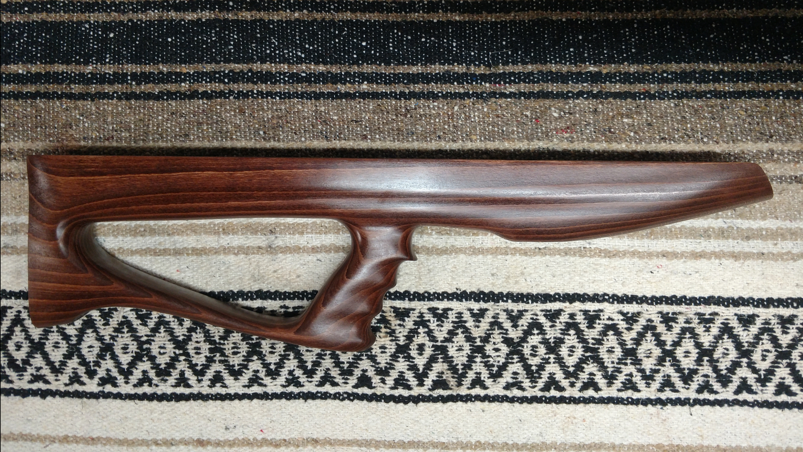

There is a guy on Reddit who took off 11 ounces his Challenger Bullpup stock. Looks factory cut too. He refinished it and brought out the pretty woodgrain. I might do that. Too bad I dont know how to make carbon fiber stocks, that would be so trick.
Reactions: Ranchibi
This is the reddit guy's stock.
I'm currently working on a new chassis for my big bore 357. I'm not not sure if it will fit the non-bigbore version of the bullpup. It might as long as the air tube has a the same diameter. I already made a chassis for my standard .25 long stock and I was able to take about 12oz out of it vs the wood stock. Also much more functional with an adjustable butt stock, m-lok rails and standard AR grips.
