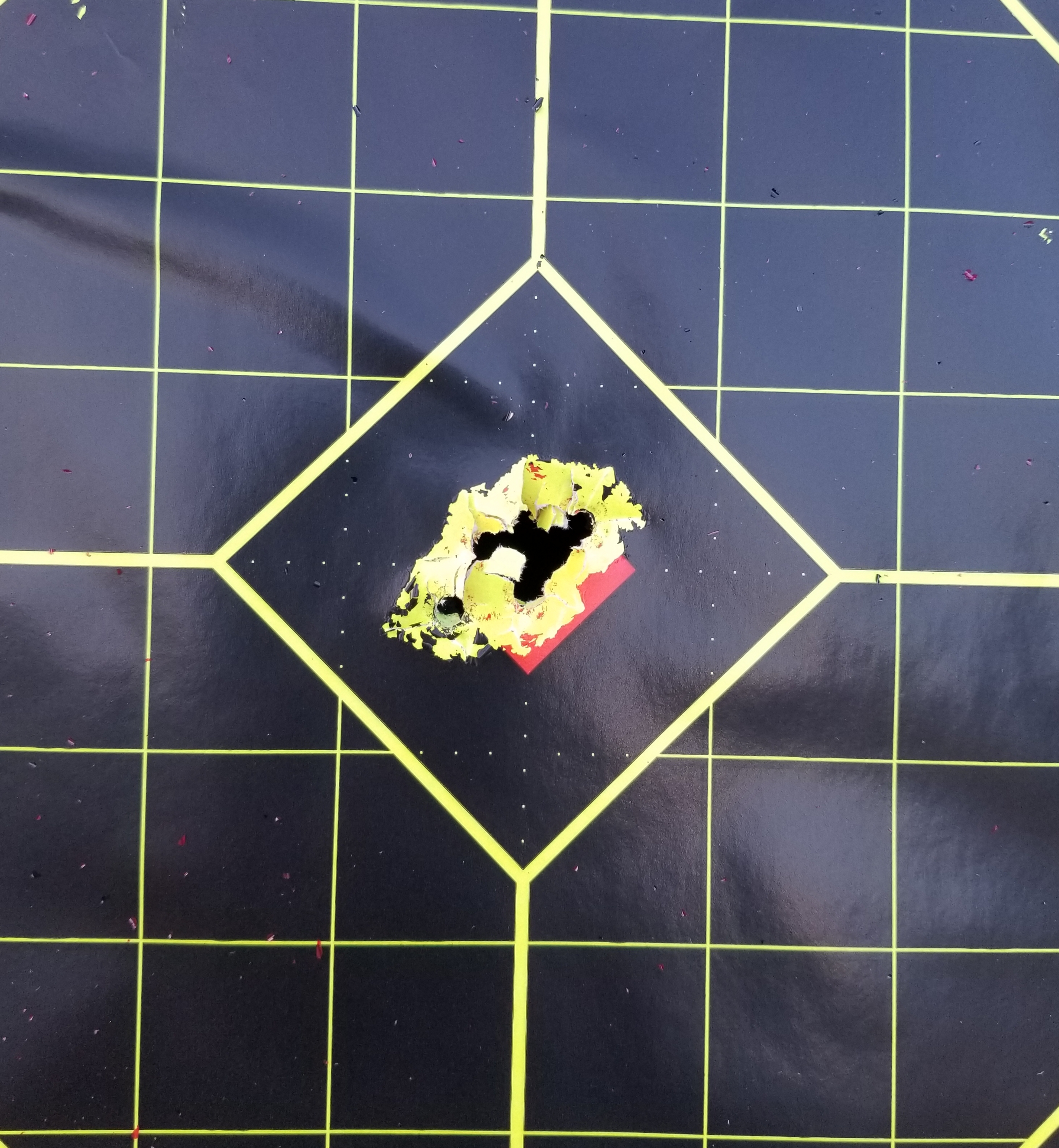

I have my standard pro slinging 95 grain slugs 920fps, 180fpe. And she shoots with masterclass accuracy. Here is what my 100 yard groups look like...
Standard pro most power you can get is 180-200 fpe depending on slug weight and design.
Nice group! How many shots per fill are you getting at that setting? How is it on your ears?
