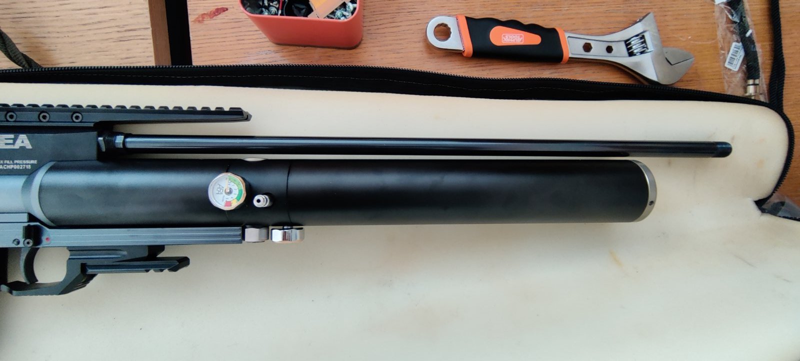

A friend purchased his first PCP (AEA Challenger Pro .22) and he wanted to make a nice photo of it. He put it on a fireplace mantle and of course the gun fell on the floor.
The damage he did (or at least that I can see) is that the barrel is bent downwards. No big deal as I've printed him a barrel band to center the barrel.
Everything else seems fine except the power. When the gun first came the reg was set to 90. His rifle is the new model with an external adjustable regulator. As the manual still shows the old rifle he didn't want to tinker and brought the gun to me to fix and check. Well the gun spews bullets. They reach maybe 4fpe on a good day with 300fps. So something is wrong.

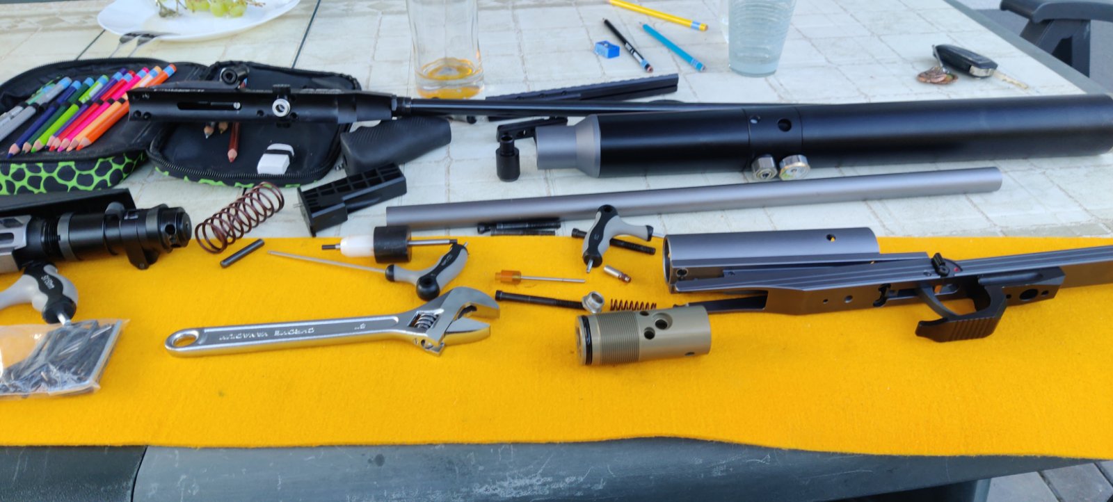

Then I tore the gun apart and checked everything and I do mean everything (well I didn't open the reg as the reg gauge shows the proper number based on two different gauges so the plenum should have the proper amount of air). I even swapped out the gauges in case they got damaged. I can't find anything wrong with it.
The only thing I did find out is that the gun is so weak I can plug the barrel and the air won't come out of it and it will blast backwards that's how weak the gun is. I wouldn't do that on any of my rifles but there's clearly something I'm missing.
I have shot a few blanks to see if the air is leaking somewhere else but it's not. At least I can't find it. Also all the orings are in perfect condition (duh since the doofus broke a day old gun).

The barrel is bent slightly downwards.
I have stripped the gun and it's not the transfer port. Neither is the cocking hammer or the pin.
I will have to check the inner oring in the barrel as I highly suspect that the inside oring is busted. Although the gun is new and it should work. When closing the cocking handle you can't even feel the oring setting in place. As said in my first post I did the paper test. I can plug the barrel and I can feel the air going the back way but shooting the gun doesn't cause any noticeable problems. Also the gun is really quiet. Shouldn't it bark more if transferring the proper amount of air? I don't know about the loudness as it's not my gun and this is the first AEA I'm working on.
@gxs - I'm not trying to argue with you or doubt what you've done, but I've owned and worked on 4 Challenger Pros (plus a Varmint and fixed a HP Carbine for a friend) so know what I'm talking about. So this will be my last post on the topic:
What I see in your first photo is barrel droop. That was common with all the AEA rifles I've owned and worked on. You won't know if the barrel is actually bent until you remove it and do the roll test as I described before.
A missing breach o-ring would cause the extreme loss of power you're experiencing. A bent barrel would not.
I never said that the barrel is the one that is faulty (I just said that it's one of the things that was faulty due to the drop). I suspect an oring I'm missing somewhere and I do agree that it could be the one in the barrel itself.
Also I did the roll test before posting on all items including the barrel, sliding hammer pin and the valve pin.
But thanks for the help and confirming that the severe loss could be because of the inner seal. I'll try to change it later today and we'll see if it improves. It's not my gun so if this doesn't work hell just have to deal with a service center to fix it.
Cheers
Here is my final report about this issue. He will be sending the gun back.
As far as I can see there are no faults. The hammer works and the valve is ok and opens. The barrel had all the orings replaced and I got 50 more FPS from it. Which takes her to 350fps on 150BAR reg with the heavy spring. Something is wrong so the shop will take a look at it and/or replace it under warranty.
