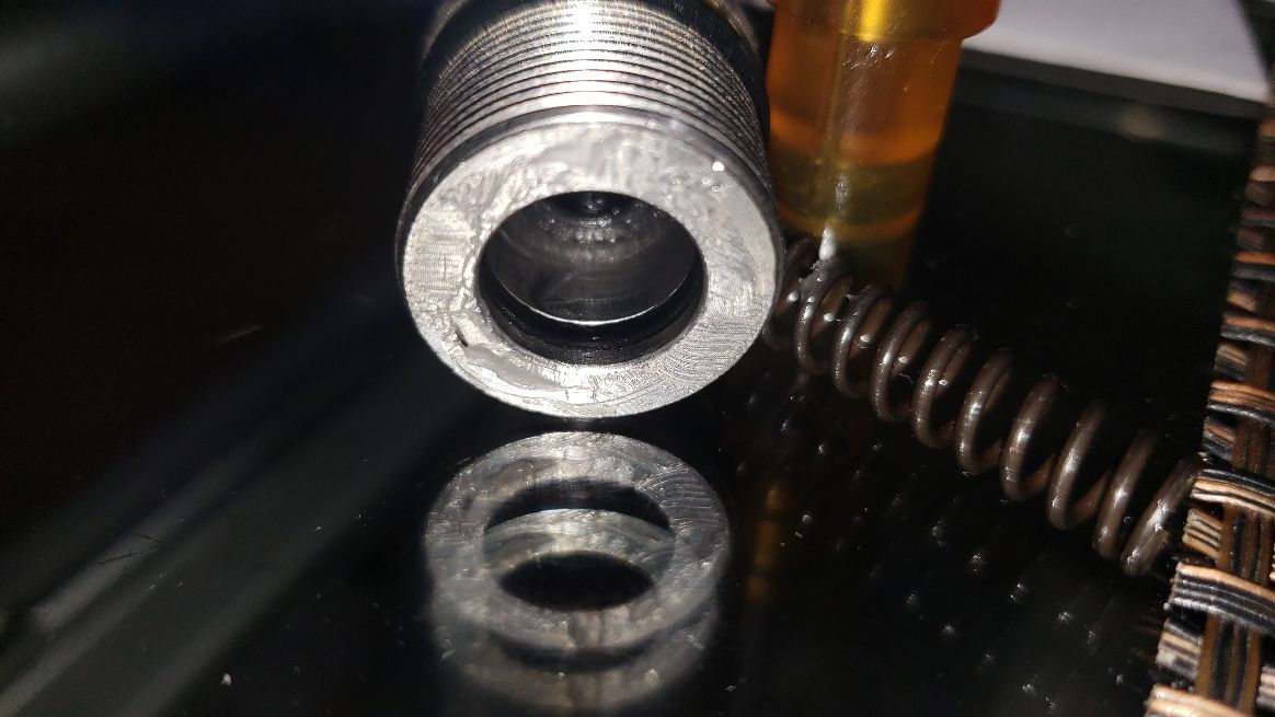

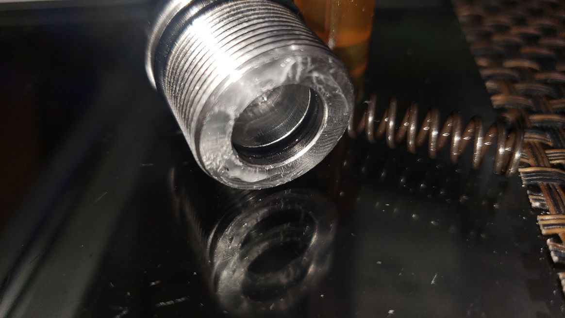

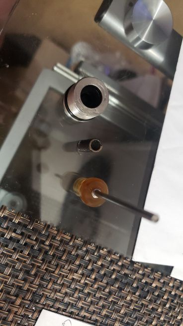

This morning took 3 shots from 4400 to 3000 psi. Using about 500 psi per shot now. First shot was 811.3 then 909.0 and finally 851.5 fps. With 180 gr slug ( first ones I grabbed ) I got about 300 fpe average. Not too bad I think. I removed the valve pin and end cap that holds valve pin. Found the pin rides up in the cap and the cap has an oring that fits tight on pin ( see images ) . I took the end of valve pin and lightly sanded it then lubed up oring till pin slid in and out easily. Valve was sticking inside cap holding valve open longer. May need that oring inside cap replaced. Will still call Ben today to see what he suggests. I think I read somewhere they redesigned valve pin to cut down circumference of head to fit looser.
