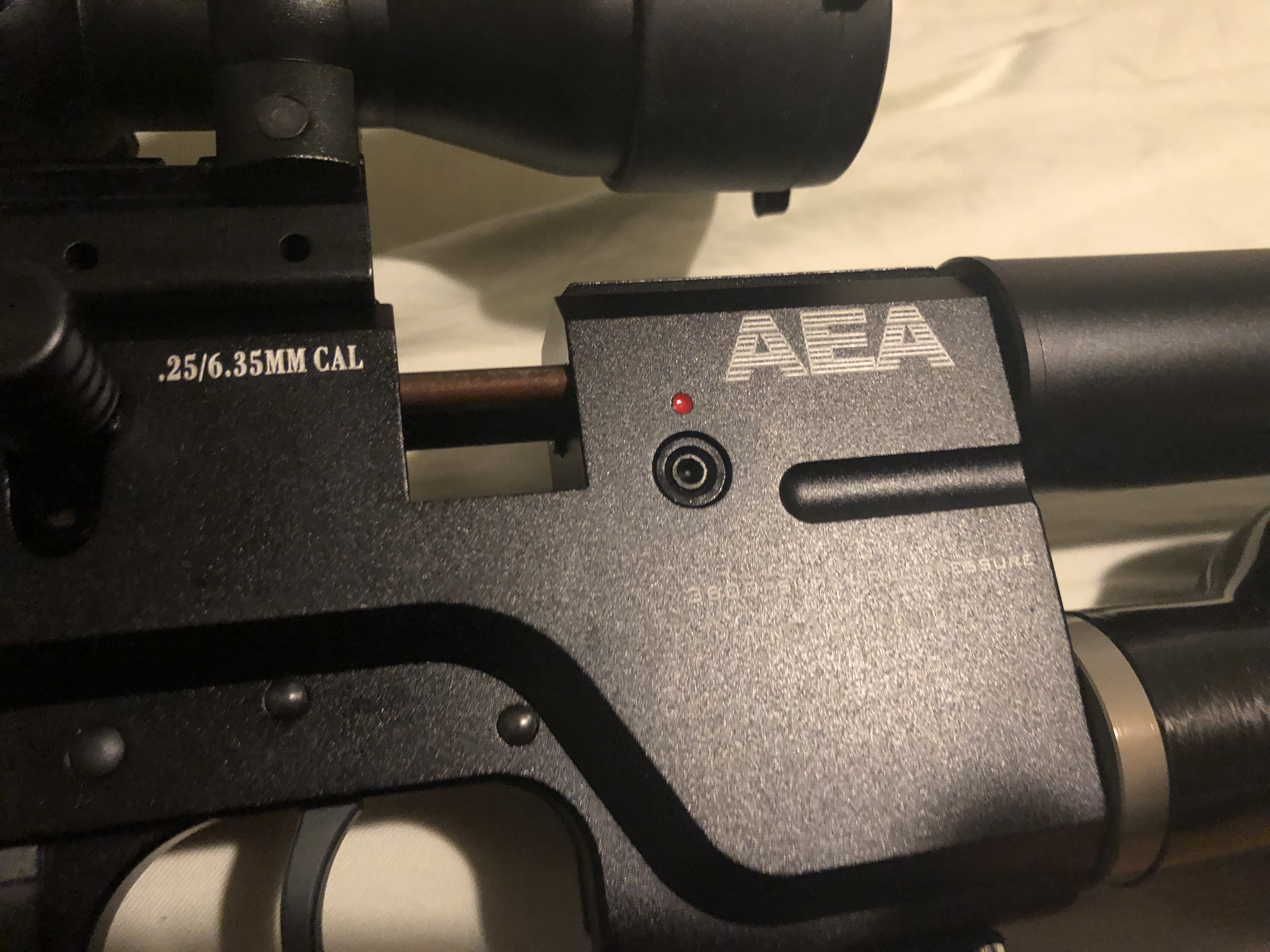

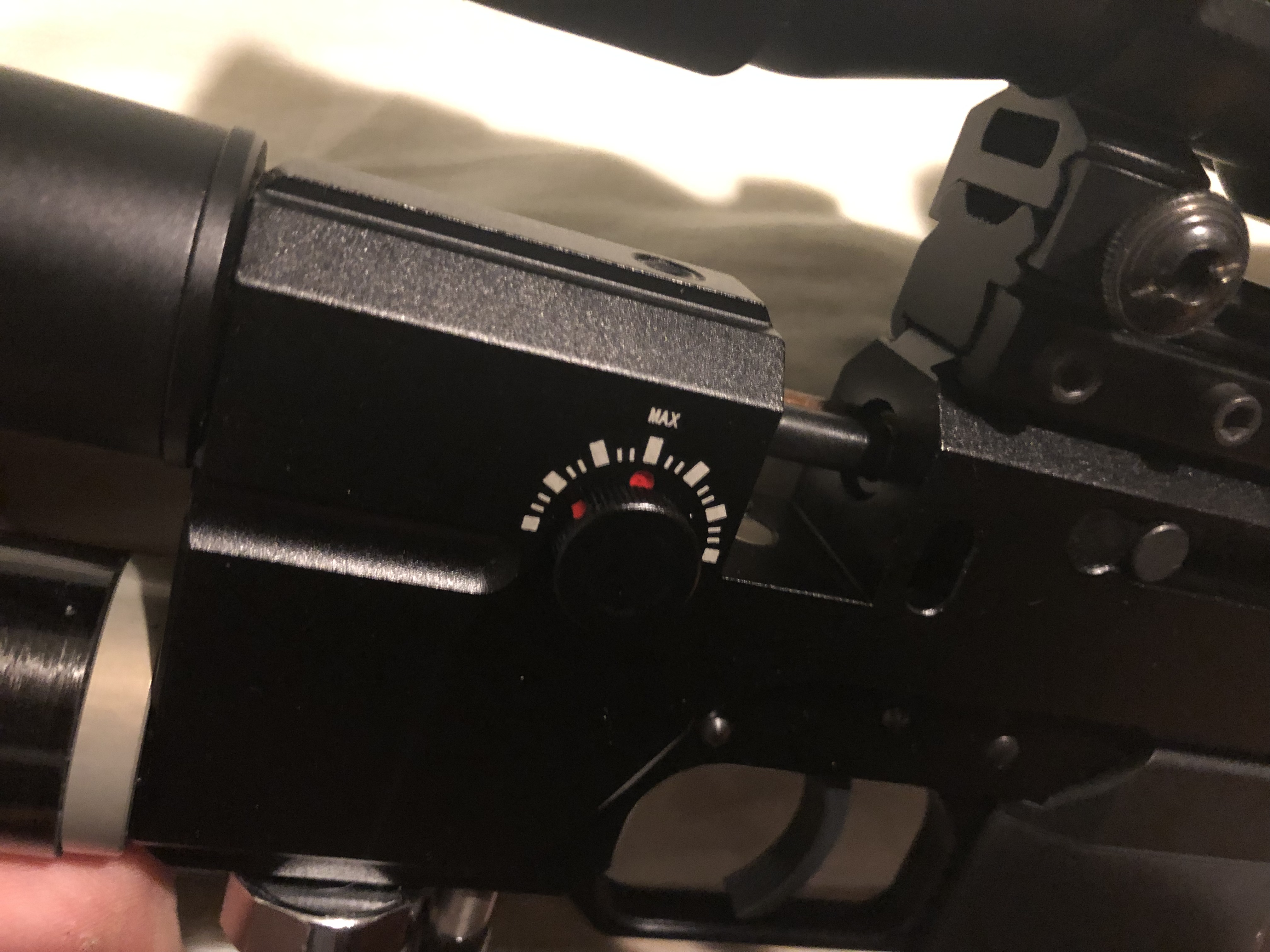

Hi, just got an AEA hp carbine and the power knobs wanders. After about a mag and a half it will migrate from 12 o’clock to about 8 o’clock . At which point the action won’t cycle. I’ll turn it back to 12 and it works again. Anyone else have this issue?
Also there is no way to tighten it, I notice the older ones have a slot screw on opposite side. This new one doesn’t.

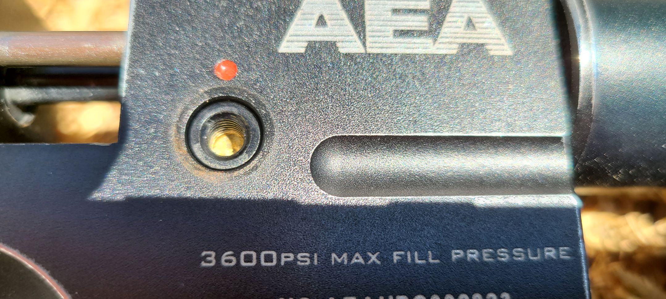

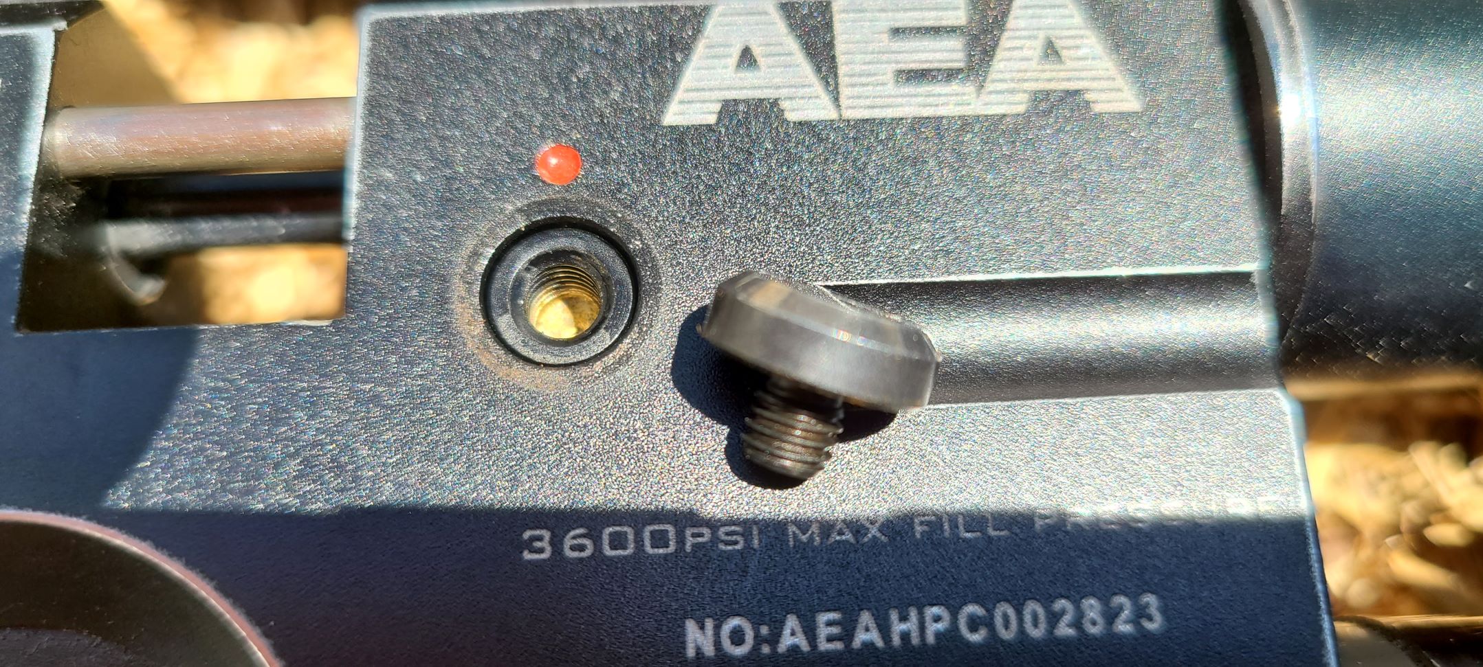

I think there is supposed to be another piece on the opposite side that tightens it down. I can’t tell for sure if yours is just missing the piece or if it’s actually a different design but it looks to me like you mean just need to get the missing part.
You may be able to tell if you watch the YouTube videos that show you how to check the transfer port, and they will show you what it looks like when you remove the part on the opposite side like seems to be the case on your gun
