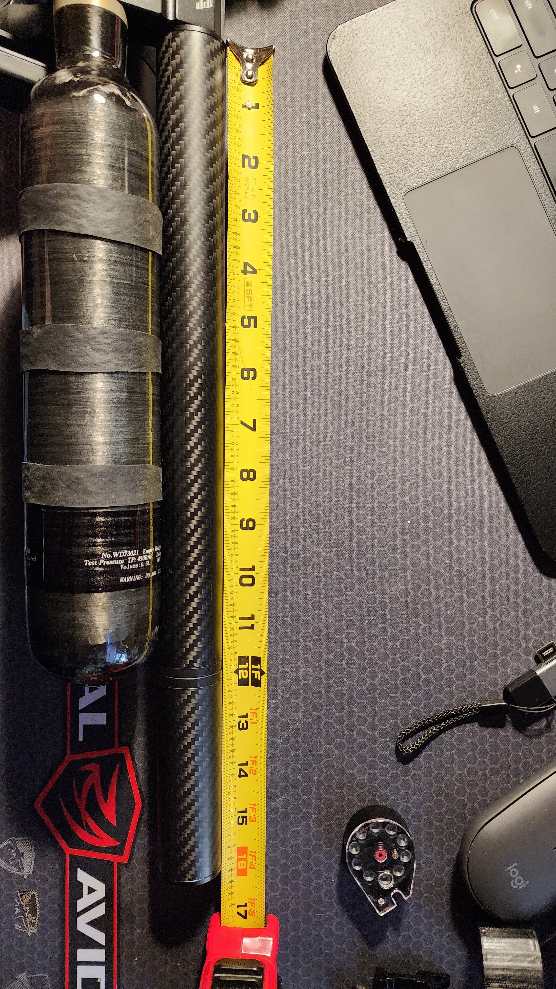

Shorter shroud....10"?
Mine currently has a 12" CF shroud on it.

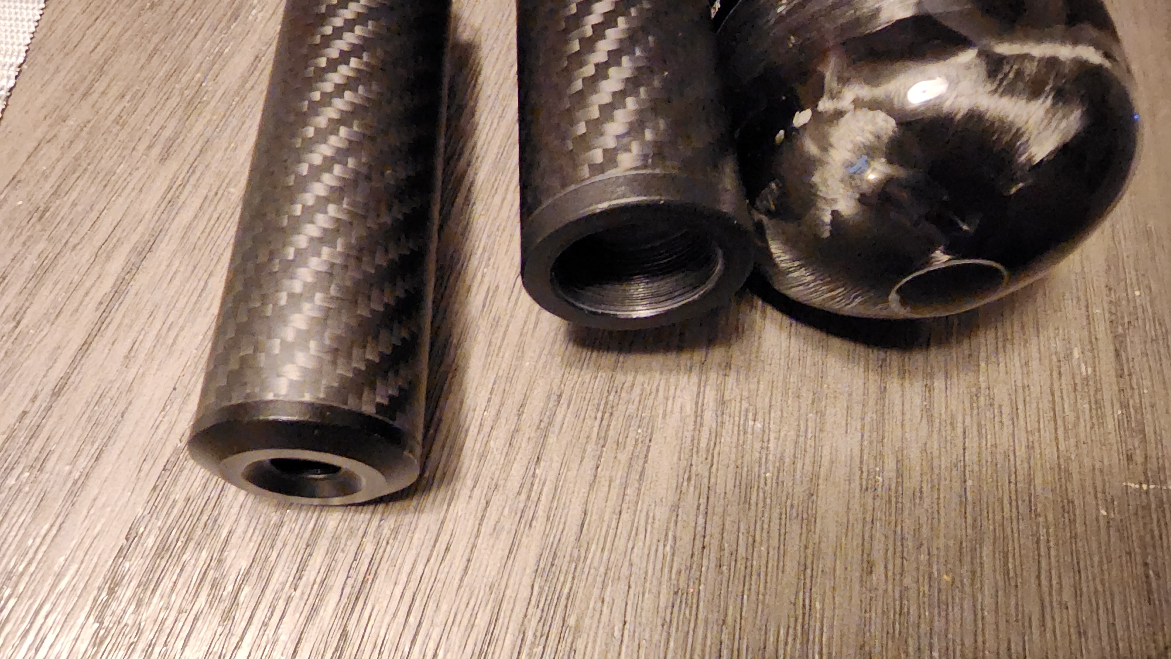

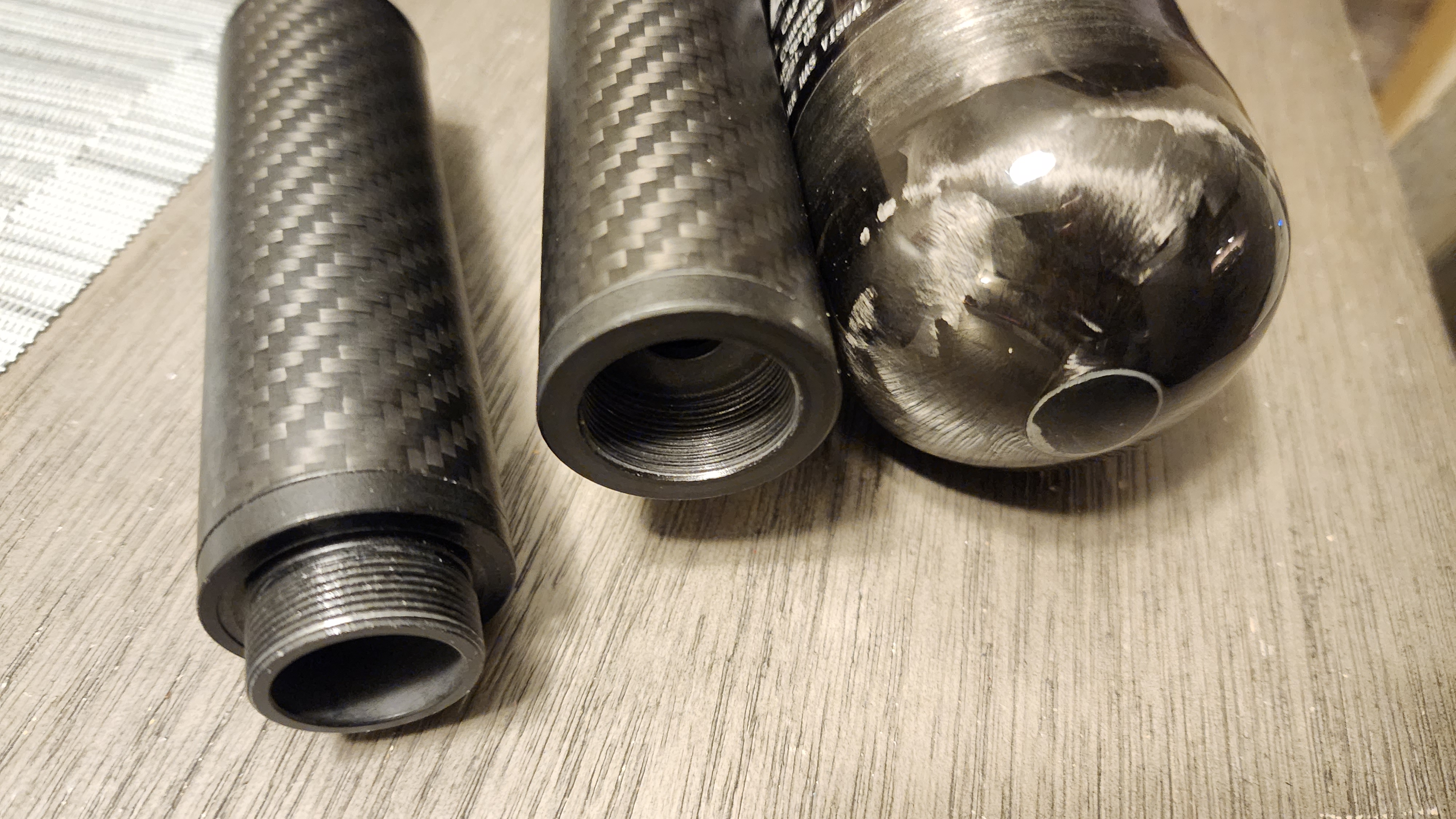

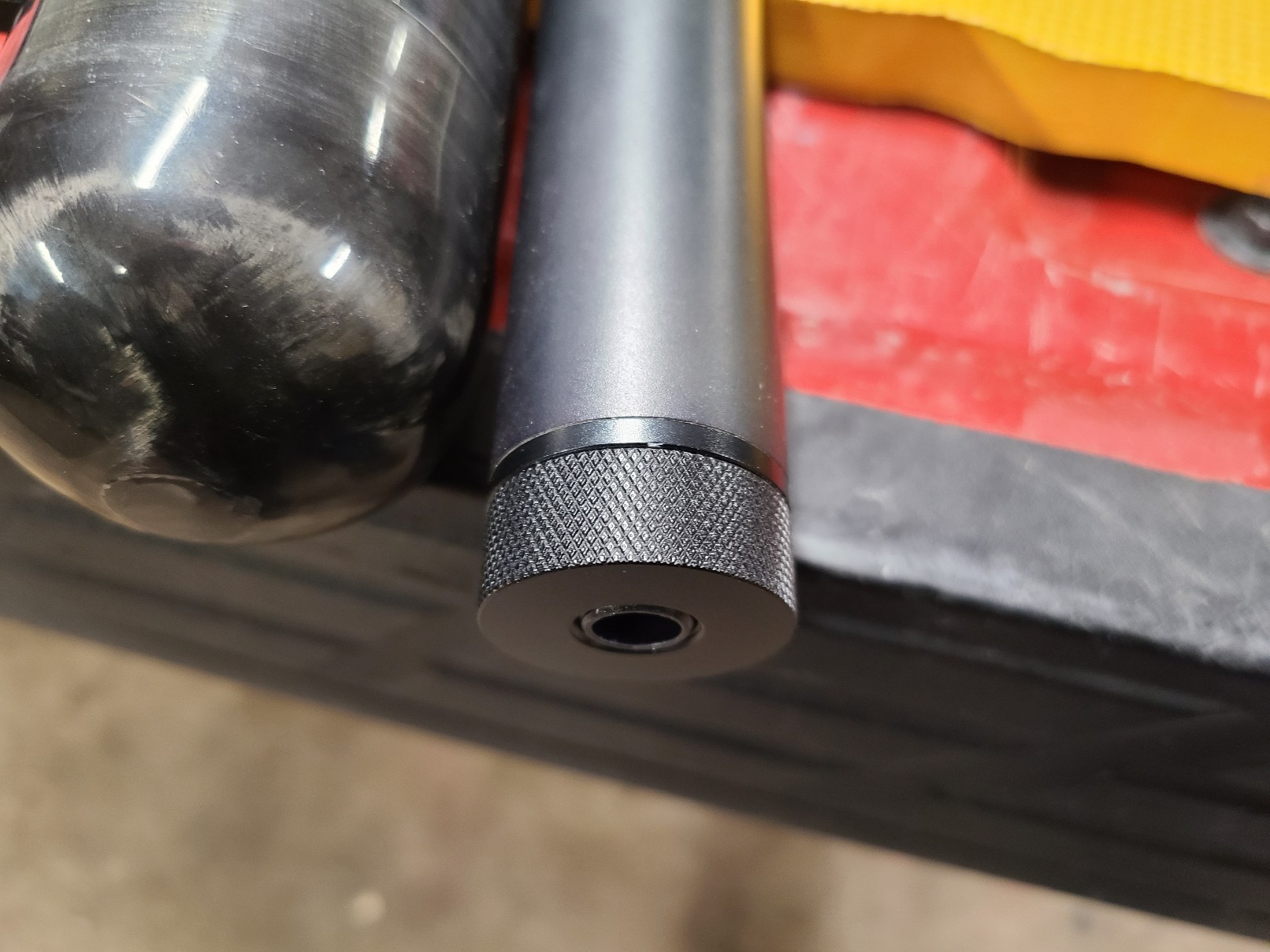

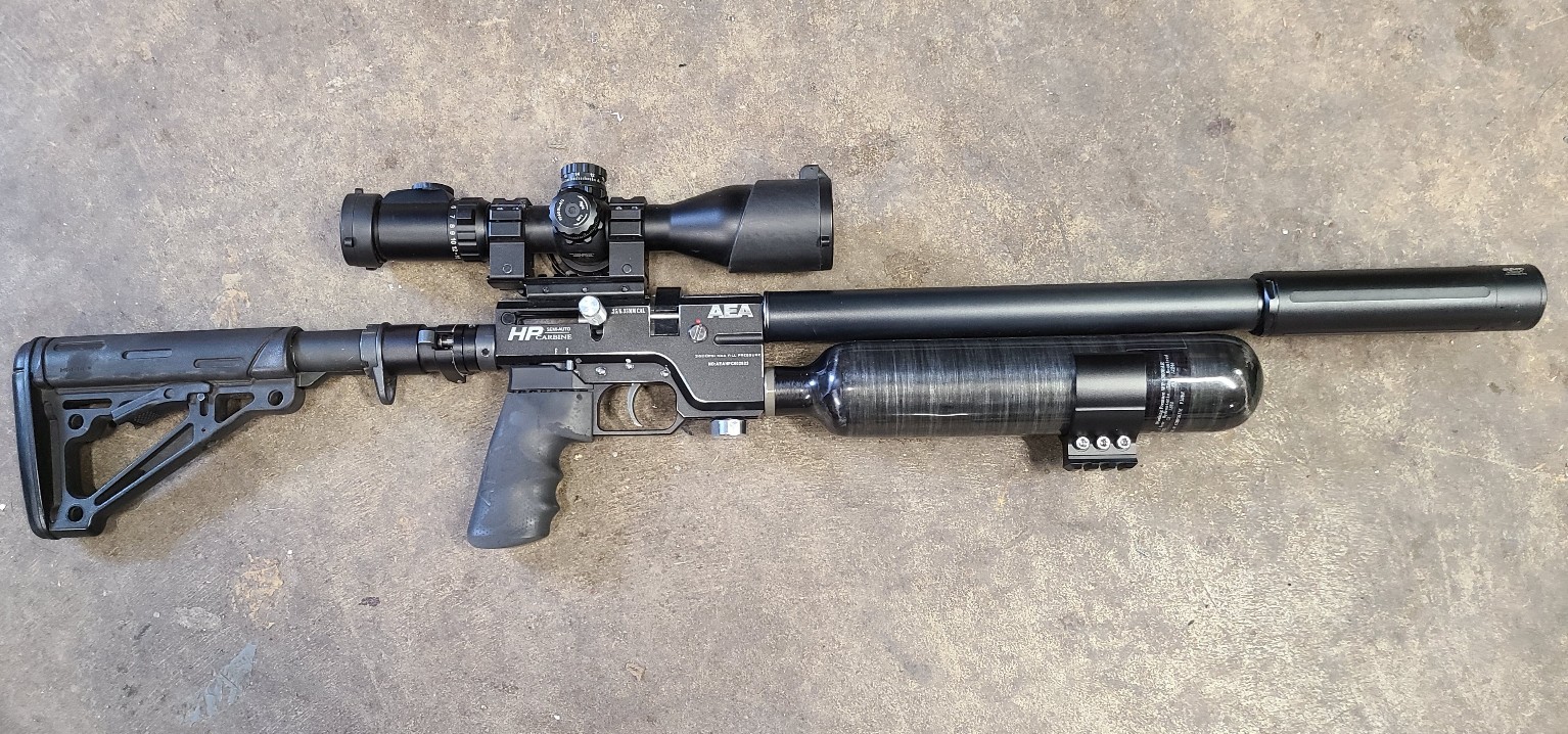

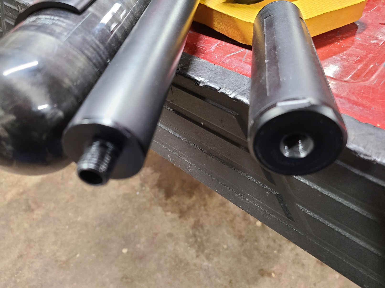

Looks like you have what you need now. Pictures do wonders. What does the end of the shroud look like when you remove the moderator? This is mine with the moderator off. Mine came with two shroud ends. One is a thread protector that screws onto the threads on the adapter (pic 3) The other screws into the shroud if the adaptor is removed. With either installed and even with just the adaptor only (pic1) rifle should fire semi auto. Mine does.
Ah, I see now. That's because you have the Donnie FL adapter with the Donnie FL moderator. I have an earlier model just before they stopped with the carbon fiber shroud in moderator, according to the guys at The Pellet Shop.
It seems as though I may just need the Shroud adapter. Looks like that would provide enough back pressure to cycle. Mine has too big of an opening evidently. According to those guys, it should not fire in semi-auto without the moderator

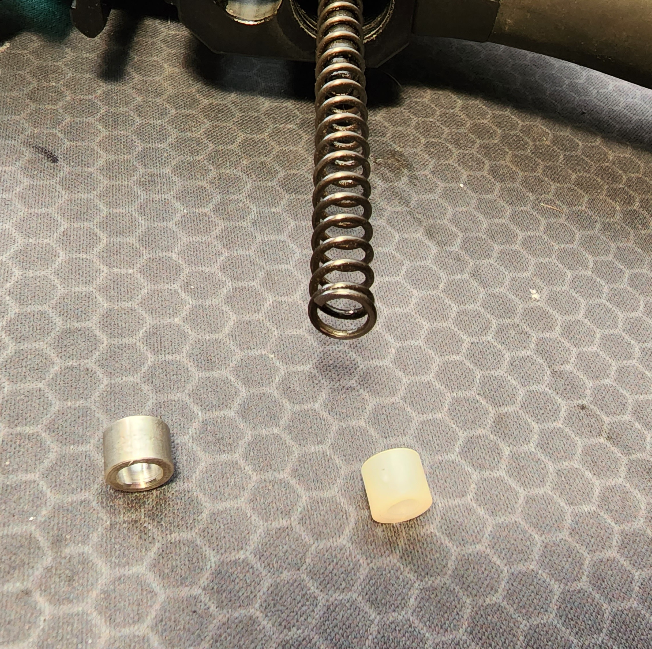

In all fairness, I am starting to believe that my hammer spring might need a little boost. That might her with just enough to get her to cycle. I know my numbers comparatively to others, are looking like 10-15 FPS less than it could be
The hammer springs get week. I have mine spaced about 3/8". Velocity on mine dropped about 100 fps a while back. With this spacer its back to where it was 27 g slug at 900 fps. I think you have enough pressure with your setup.
I detuned mine some so it would not cycle so hard. I had it so light that it would not cycle without a pellet in it. Couple months later it became unreliable and didn't sound as strong. When I checked velocity it was down. That is when I realized it needed more hammer spring, I ground down A 5/16 nut and stuck it inside the stock end. Later I made some bushings on the lathe of different widths.
I would try spacers first. I polished the spring guide rod and hammer. Use a good lube and lube the cylinder inside the shroud too. Sorry to lead you astray. Pictures helped me I thought your setup was different. The hole in picture one is a bit over 3/8" looks like that is what yours is from what I can tell.

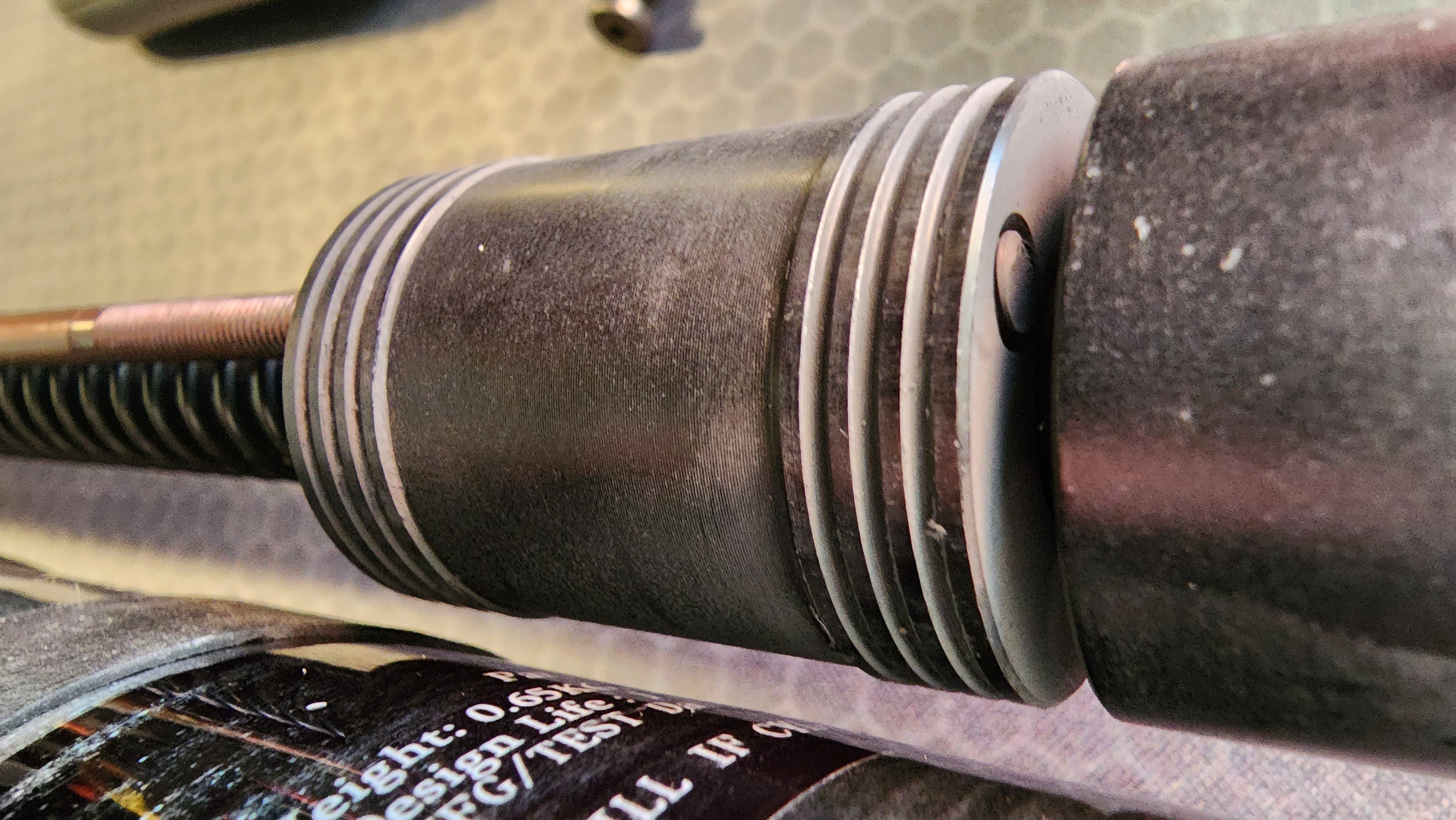

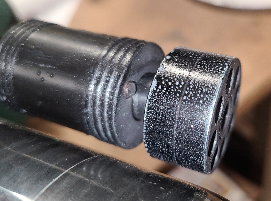

Here is the sweet spot for me on the cylinder adjustment. You can see about two threads of the rod going past the cylinder. Also this cylinder can get sticky and slow down the cycling. I like running my dry as possible.
