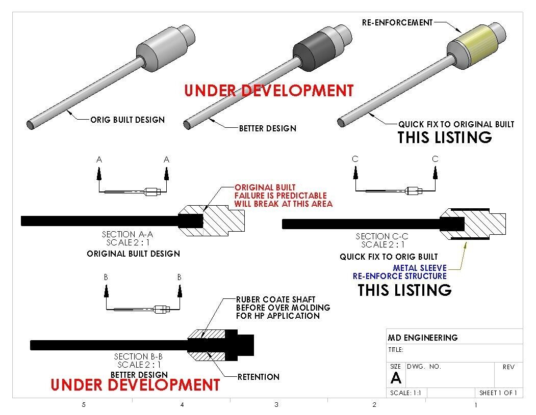

Same question as customcutter…….looks like a stronger material for sure. But I also think that the shaft should go all the way to the end of the head considering that that was always where it broke off.
You really dont want the shaft all the way to the end, it will protrude through the seal.

I've had my .25 TD carbine for a year now. Close to 4K rounds through it without a valve break. I notice mine though tends to stick when filled for the first shot and sticks some when it sets. I too have a PEEK rod to make a valve. What is the diameter of the shaft? My plan was to press fit the shaft in with some high grade super glue. PEEK will stop the sticking. Do you have to burnish the PEEK valve prior to installing?
Rounding the base of the shaft would help. I think what is splitting the valves is the shaft is gradually moving forward inside the plastic creating pressures that eventually split the plastic. I'm going to try adhesive on the shaft to minimize this movement. I had planned on rounding the end just to make the press fit easier.
Jim, I bought my .25 TD carbine used from an iguana removal guy. No telling how many shots it had fired. I might have put 500 rds through it when the original valve broke at the bottom of the shaft. I made a new one out of peek. Don't recall the stem diameter, but it is slightly larger and knurled under the delrin. I don't see how it could move on the shaft. I formed the PEEK section and had it in a collet on the lathe. Then I drilled the hole for the shaft using a chuck in the tailstock. It was a couple of thousandths under the shaft size. Then I chucked up the stem and press fitted it into the PEEK section while it was spinning in the collet. It heated up and seated itself.
Somehow it wasn't properly aligned with the bore of the PEEK. I placed the stem in a collet and re-turned the sealing face of the PEEK and burnished it with some 1200 grit. No problems since but I've probably only shot less than 200 rds with it. I did notice before if the gun had sat for a couple of days sometimes the first shot sounded a little weak. No problem with the PEEK valve.

What is the green material? Are the shafts shaped like the original shafts with a fatter head under the green part?
No. Other than outside dimensions with the exception of the tapered sealing face being extended for less turbulence it is a redesign. Ive adressed some issues with other designs. Delrin and precision ground tool steel and it stays right around the factory valve weight to retain the tune and air efficiency.
I hated my aea from the day i got it(fx snobbery) op rods, charging handles and valves breaking. Burping pellets down into the trigger group. Several friends have them too and had similar issues. So i decided to brute force solve it within reason for the valves which will eventually become cheap enough that they're like oring re sealings. I will also stand behind my re design. If you break it (within reason, not 10 years and 20k rds haha) we will get you running again for a nominal fee. Pricing falls between the factory part and the exotic valve out there.
