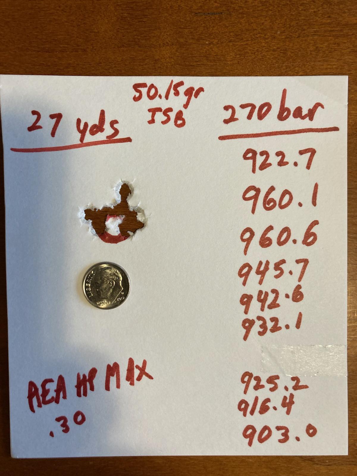

I have a .30. I backed off on the hammer spring to try to stretch out my usable shots. After figuring out my max fill and refill pressures, my gun starts out around 880fps then up to around 930 then back to 880 ish. I think two mags. The thing is surprisingly accurate. How’s it holding up? Good because I don’t shoot it much. It’s my break glass in case of emergency gun. Not a recreational shooter. If you want to shoot a lot, spend more and get a good gun.

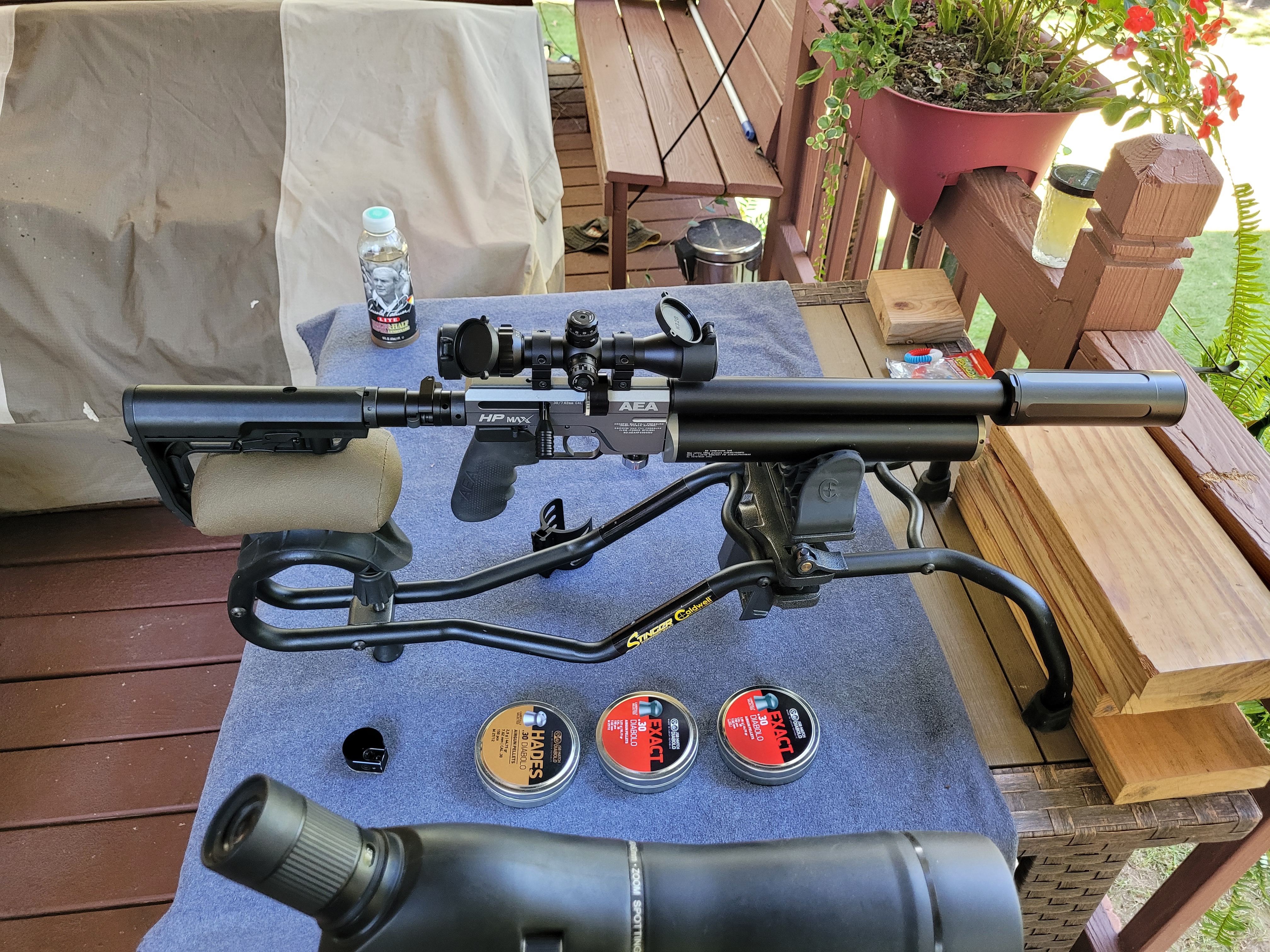

Beautiful gun. How long have you had it and how many rounds have you put through it?
Jumped on it when they first hit market. 3 tins. It's not a cheap package when tricked out. Don't even think of firing it without moderator. Donnyfl Ronin or similar minium. Live in truck. Shoot the Raw .30 a lot.
