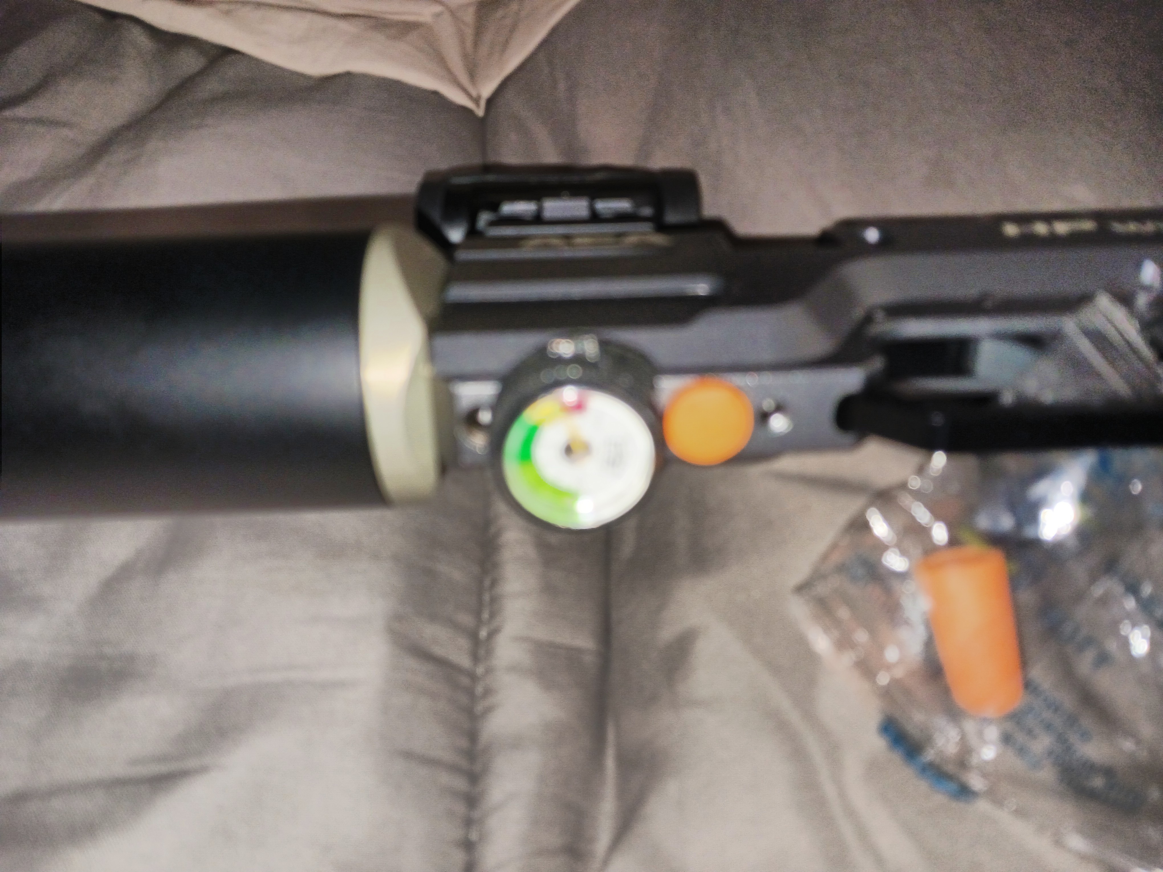

One thing about this model is that there is no cover for the probe port. Major oversight in my opinion.
I just use a foamy ear plug.
