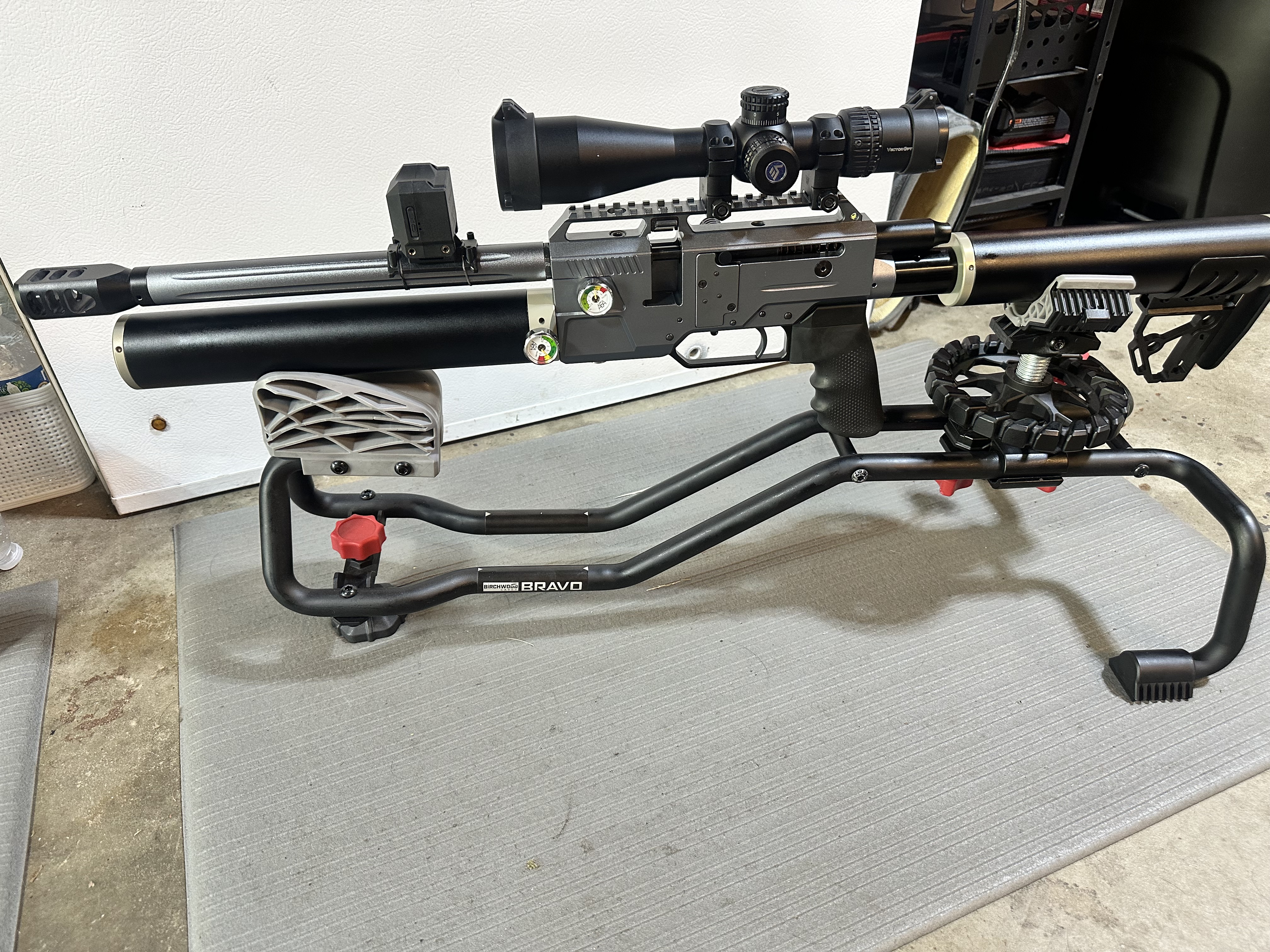

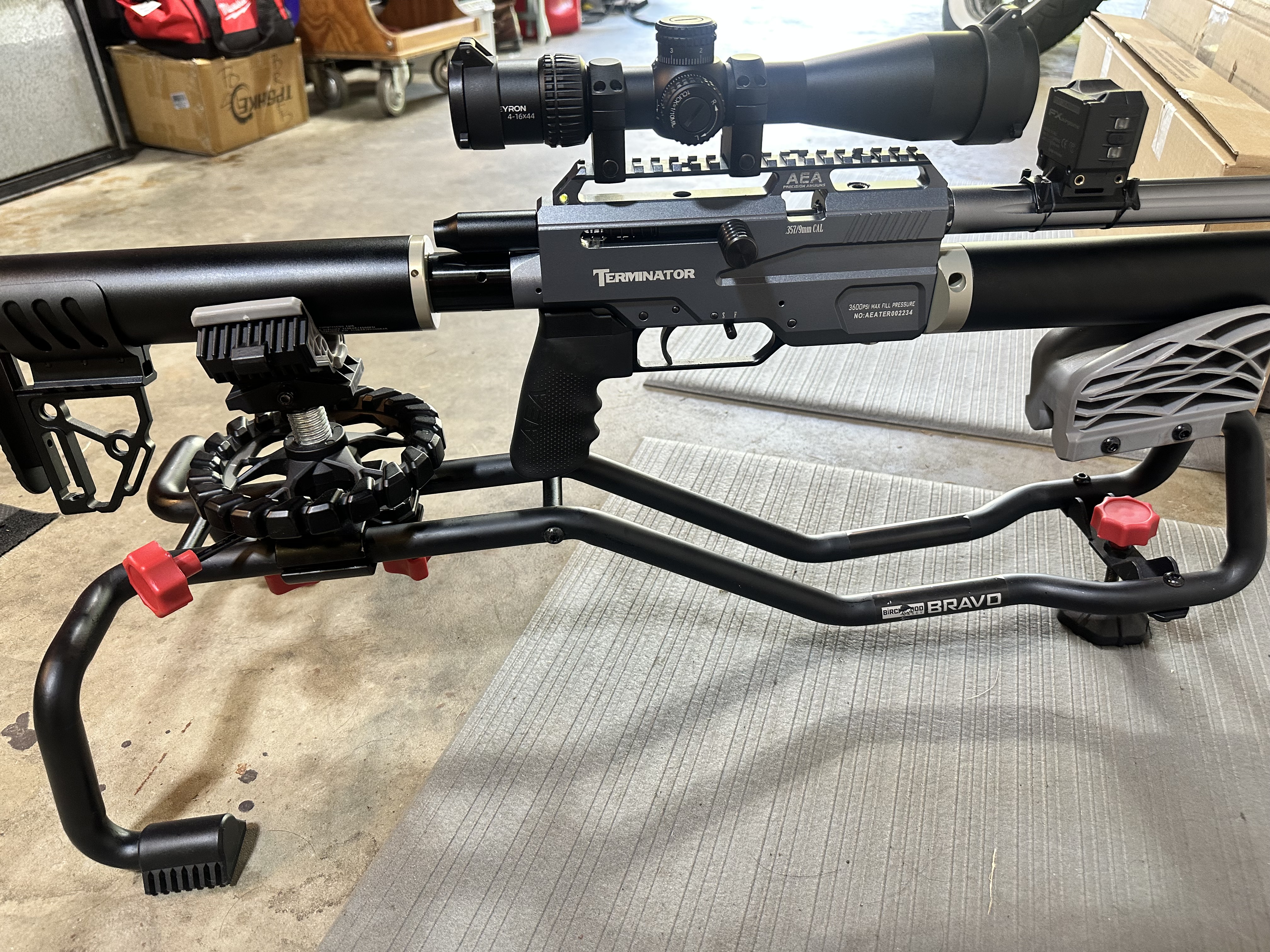

I enjoy my 3 AEAs. Reliable , accurate, fun and …. Powerful
Didn’t break the bank either
And they are good looking guns in my opinion
