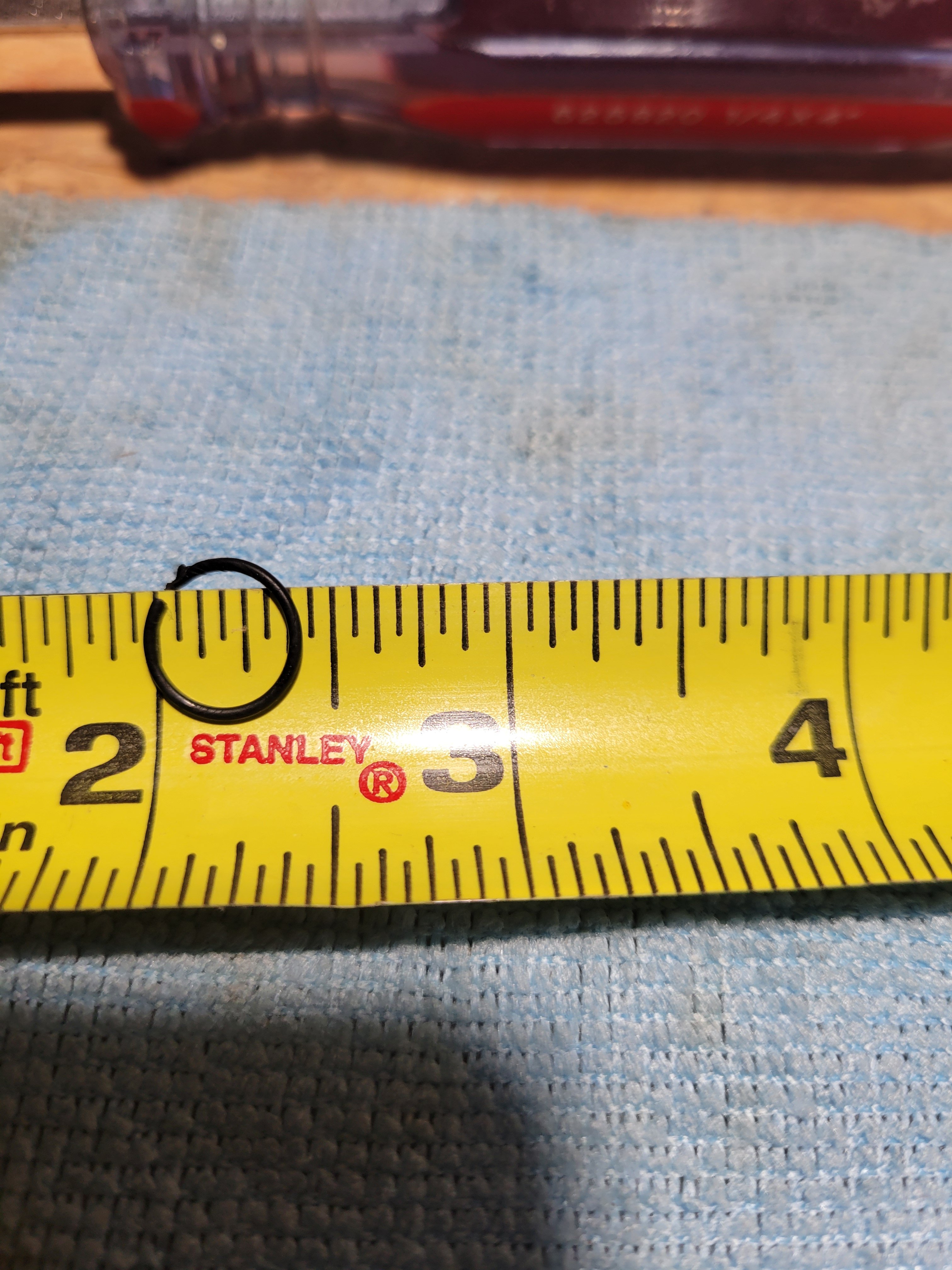

Been alot of talk on O Rings and now I'm in need. I can't find any with a half mm .50 cross section. I also am getting no help from any of the distributors of this gun (AEA hp ss) on sizes for various O Rings. Members here have mentioned O ring factory and some other distributors. When I go to their website they have o rings made for all types of applications and made of alot of different materials. I have a couple questions.
1. What o ring material should I be looking for?
2. Did I get the size right? Any way to tell from the Picture?
ID 6mm
CS .50mm
Thanks

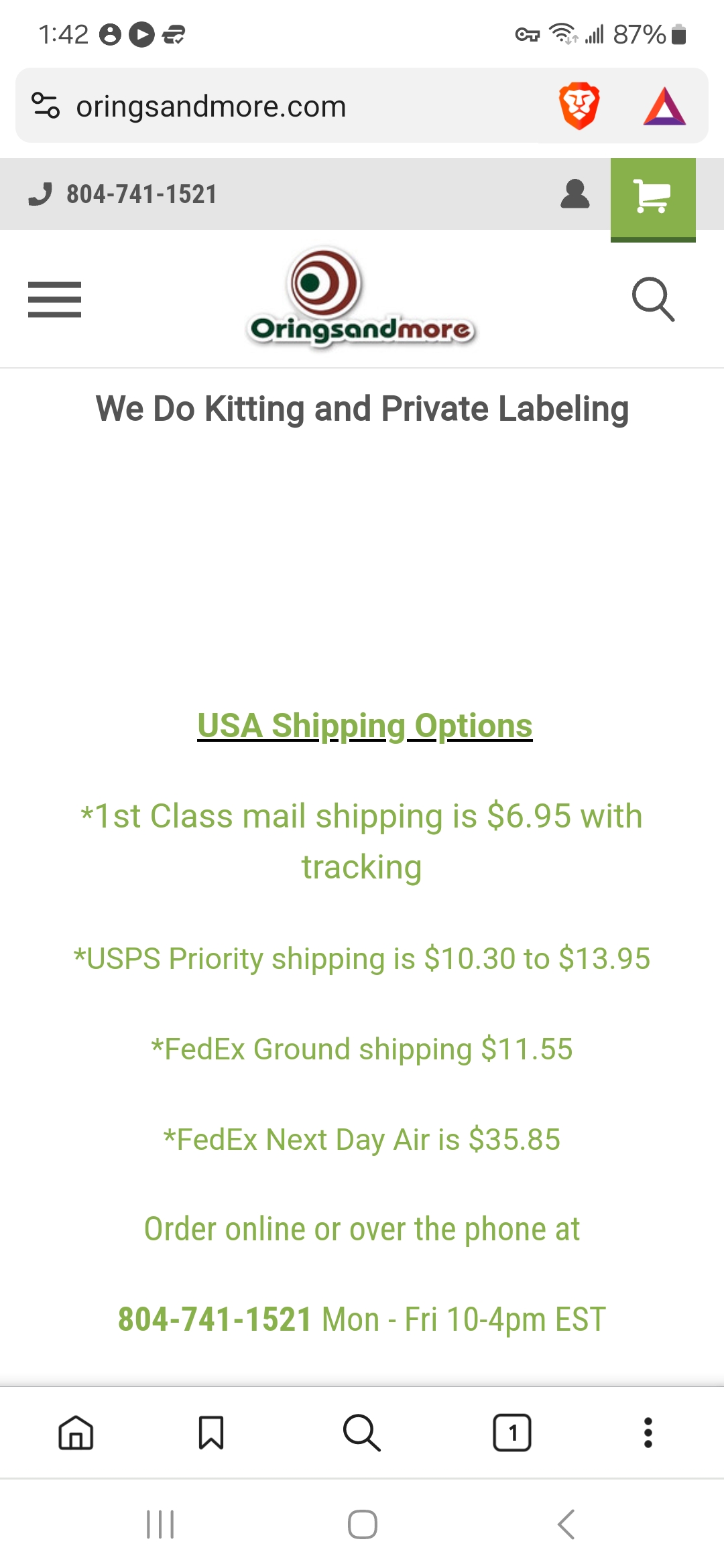

Oringsand more. Call them and she can help you out. Buna 70 is probably the oring material.

that Oring is easy to find but not cheap because of shipping but i will get to the Oring in a second
how to measure an Oring
you need two tools Digital calipers
and a 6 inch stainless ruler
if you don't half either buy them you will find you are using them all the time
6 inch ruler
General NO.311-me buy 2 and you can thank me later
https://www.theoringstore.com/store...duct_info&cPath=368_12_2185&products_id=95033
now what you have is to say because and inch tape measure doesn't help much
05mm = .0197 inches and 1/64 is .0156 inches
your ruler goes to 1/16 which is 1.588mm
you are looking for something that you guessing the size of
so, my point is know what you are looking for and have the right tools

The O-ring Store, Mcmaster-Carr, O-rings and More are at least 3 places that should have what you need in the way of mm size and durometer rating. You can get 10 or 20 for the price other places charge for 1, ESPECIALLY OEM (Original Equipment Manufacturer).
You can generally buy 100 from o rings and more for what the manufacturer will charge for 1.
Reactions: Gerry52 and Hopper

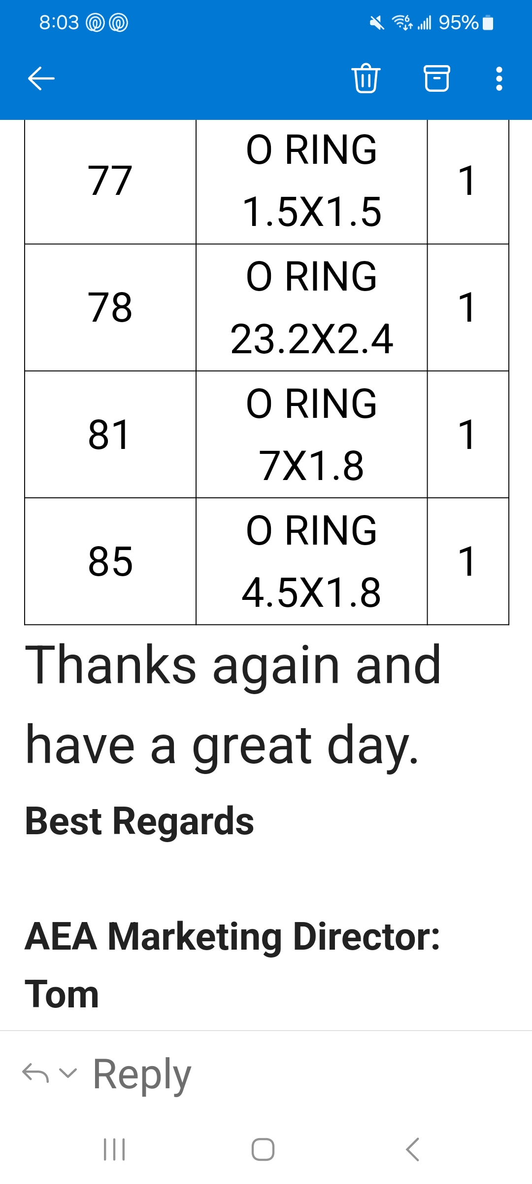

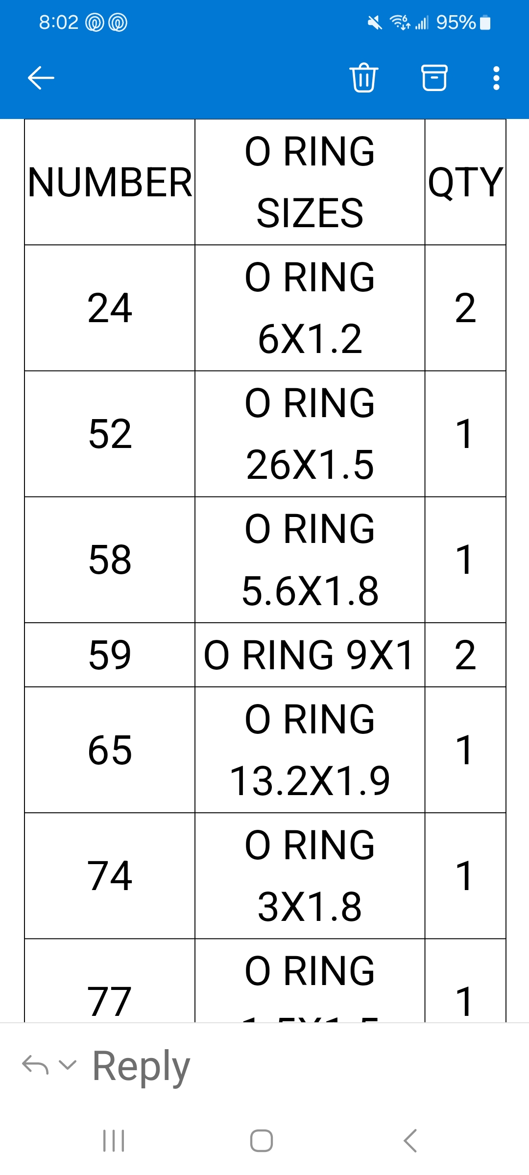

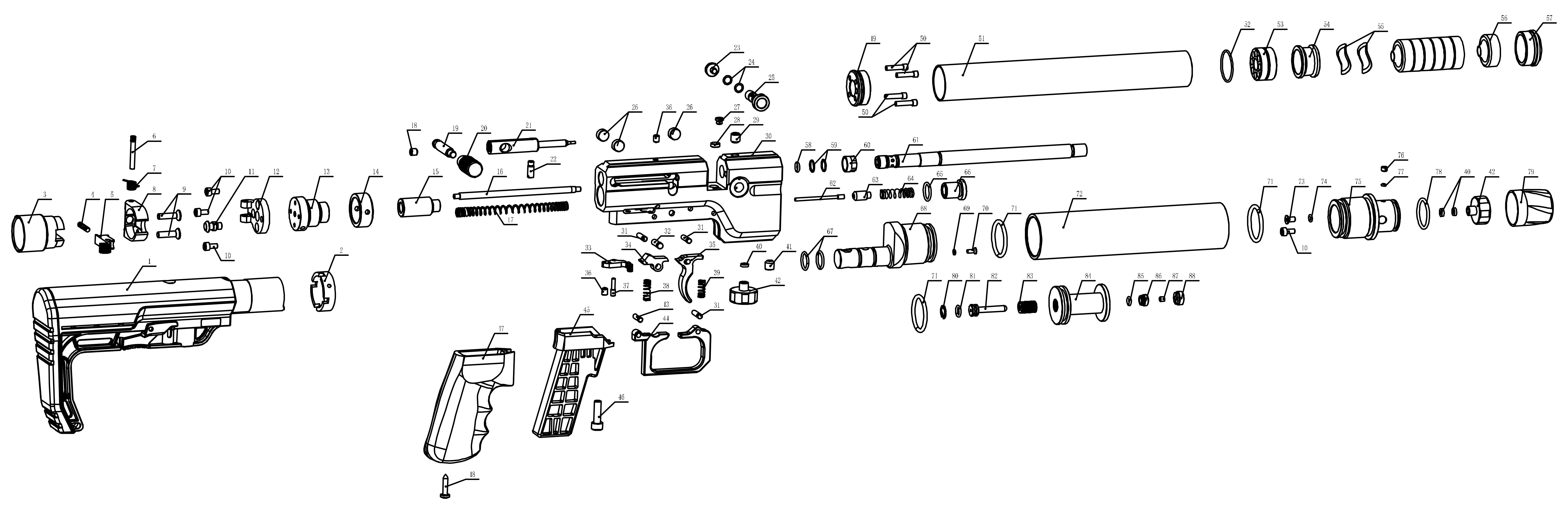

Wow. Contacted the place I bought the gun and probably 3 other distributors including bintac to get o ring sizes all by email. After a week or so with no response on sizes I found the AEA Precision Airguns. INC website. Contacted them by email and within 24 hrs Tom director of marketing emailed me back with a numbered shematic and a list of All orings with sizes. Maybe this will help others with this gun.
thanks again for all yalls help.

Then maybe post the chart/ list / whatever of the correct info is to help others in need ? Why hold that hostage ..lol
Reactions: BluegrassBill2020
You got it. The way he sent the chart was not in a pdf of format I can save. I suck at technology but will get it figured out. The best I could do at the moment was to list were and who I got the info from.
Reactions: Hateful McNasty
Take a clear picture of it with your phone & post it here if you can't figure out the format thing.
