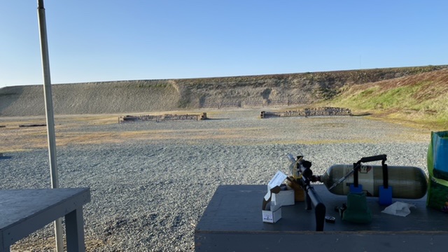

Finally took my new AEA HPSS Plus+ in .25 to the range today for couple of houses. And boy is it a fun gun!
As many of you already know it is a semi automatic with a very stiff trigger. Zeroed at 25 yards and with the TP 1/3 below max the NSA 26 grain .25 slugs flies pretty darn consistent 775 fps average or about 35 FPE. I get 4 full mags or 40 shots from 3500 to 2200 PSI or the preferred pressure or the green range on the gauge so quite happy with that.

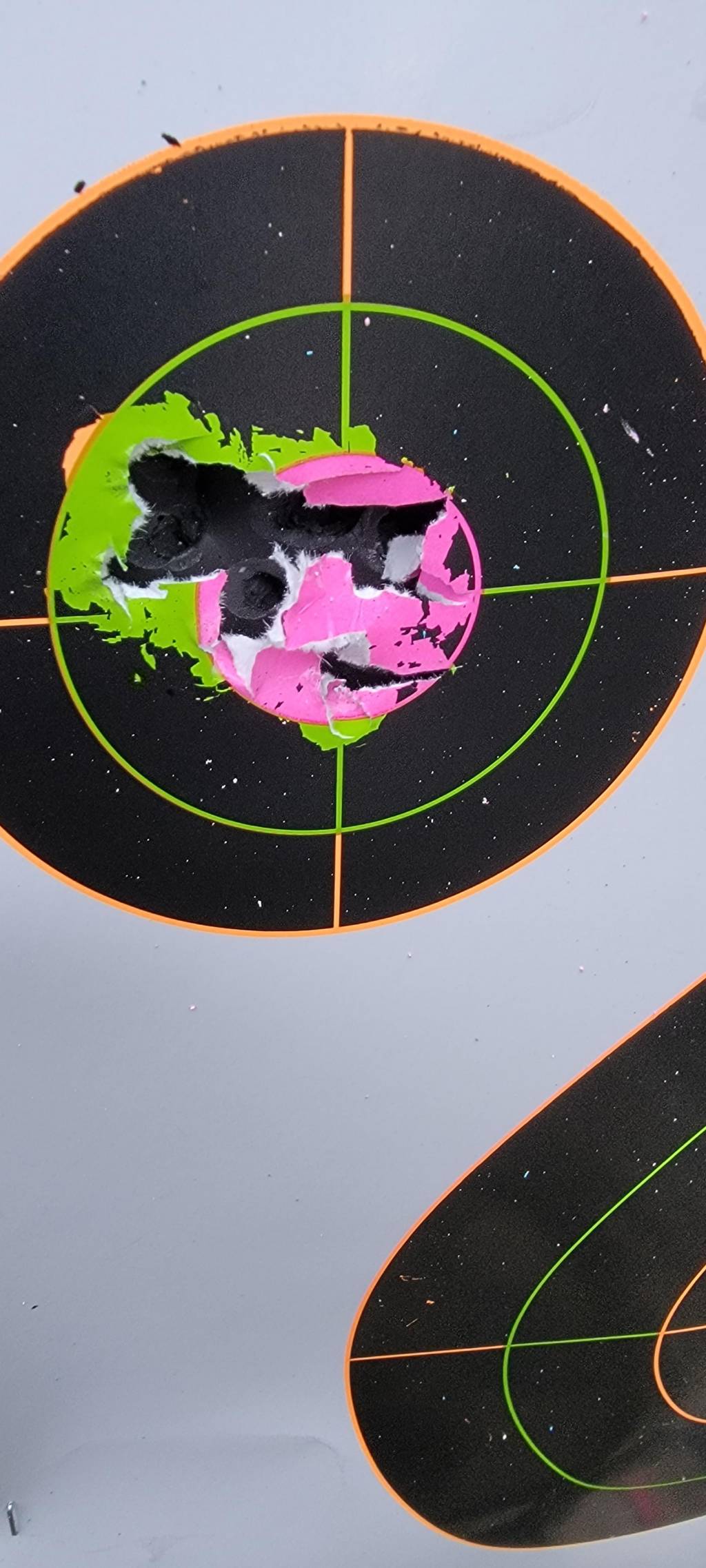

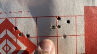

Accuracy is pretty good but not easy to shoot a group because trigger is really quite stiff but I didn’t buy it for shooting groups. Best groups at 25 yards, 1/2 inch i think.

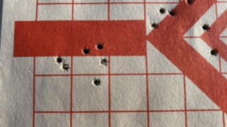

At 50 yards it’s not all that bad with that trigger, averaging 1.5 inch groups.
Also shot at rocks on the berm at 120 yards and to my surprise it’s pretty descent. My guess is about 2 inch pretty consistent, no issues hitting bigger rocks.
packed up and moved to the silhouette range and that where the gun really got started.
Rapid firing at 25 yard steel targets, knocking them down one after another, I was giggling like a little girl. I was even knocking down 50 yard reel targets freehanded because shooting while testing on the tank was too easy! The targets are fairly large at 50 yards, most are 4 inch squares. With a rest I can consistently hit the 2 inch steel spiner. This thing is just too much fun!!! Need to order at least 2 more mags.

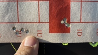

@qball I did the same as you, thought I ordered a 22 cal and got a 25. Even bought a bunch of 22 pellets for it at the same time, not sure how I did it but did. So far the gun has worked perfect. I agree the trigger is stiff but reminds me of a stock ar trigger. The magazines are the the only real downside to the gun. I am getting 4 magazines also per fill and is a blast to shoot. I shot a group yesterday and did pretty good shooting the baracuda hunter extreme 28grain at 25yards. Seems to work fine with all the pellets and slugs I have tried.
Reactions: qball
@Ezana4CE: I will definitely email darko about the mags!!!
@nelson86m: I swear I ordered the .22 and you experienced the same thing so I’m guessing there might have been a glitch in the system. Although after using it I’m fine with it being .25 since the much heavier .25 ammo is good on steel targets, doubt some of the heavier steel targets will fall with 14.3 pellets at 50 yards. That’s an excellent group with that “stock” trigger.
