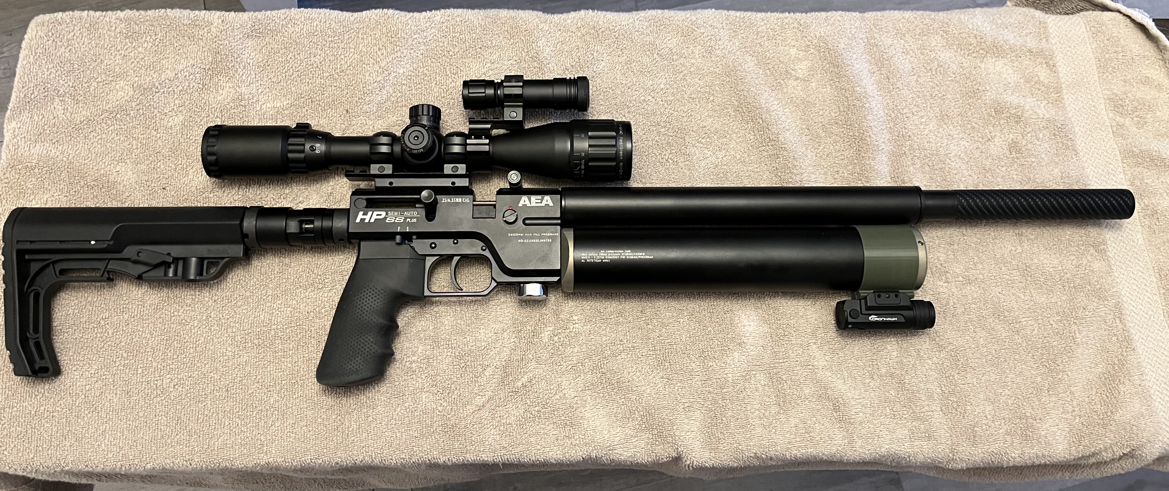

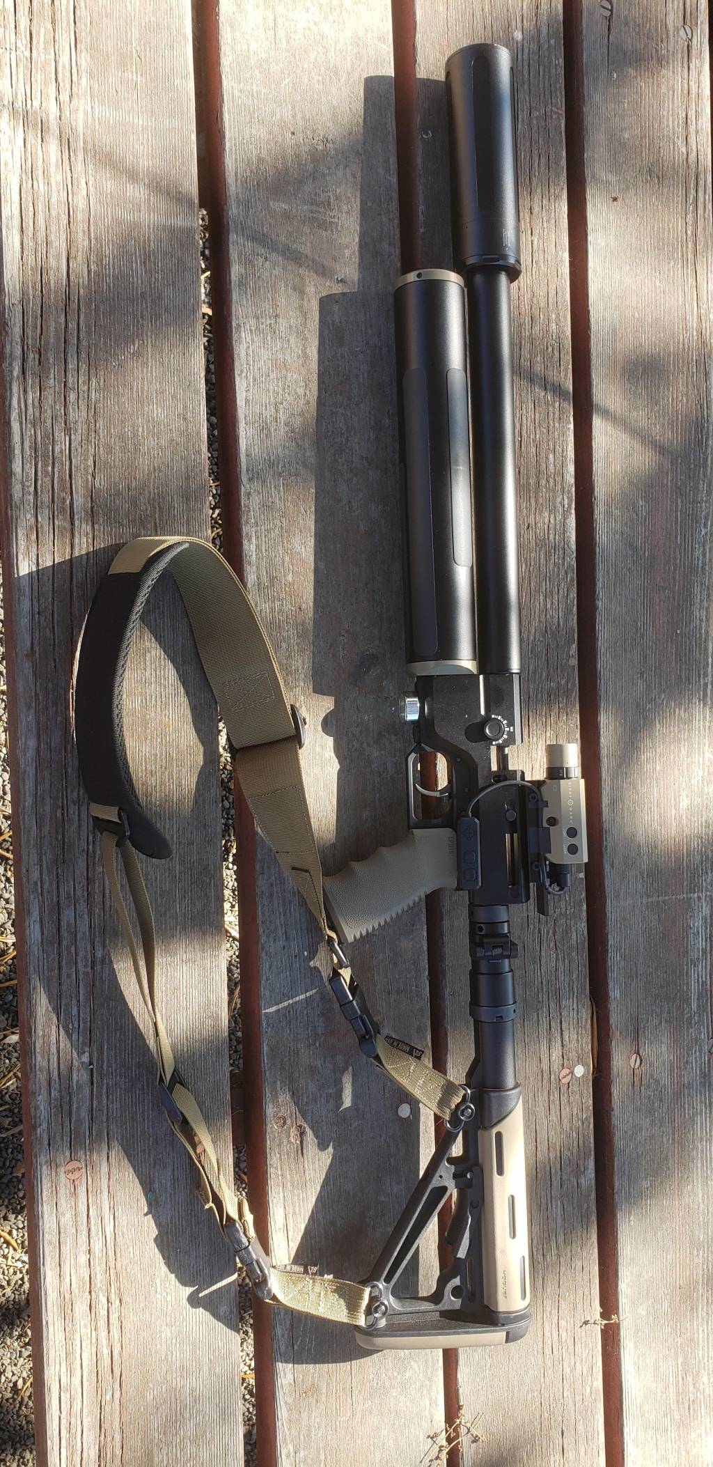

Update on the cut down barrel too much flex in the barrel hurt the accuracy so I made a shroud with 3/4” aluminum tubing and rubber grommets. It shot Hades inconsistently so I tried JSB Heavies 33.95 and this is my results at 25 yards definitely benefited by making it more rigid
View attachment 168989View attachment 168996View attachment 169001

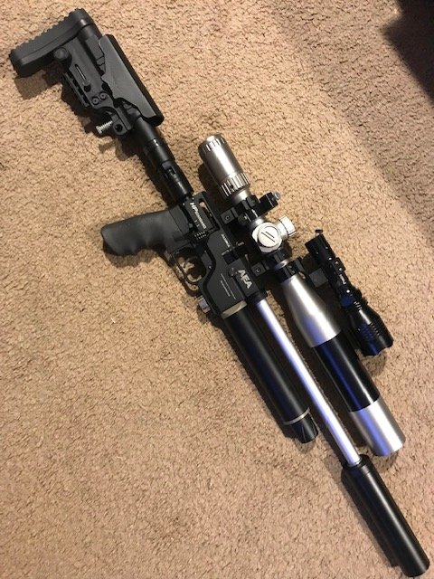

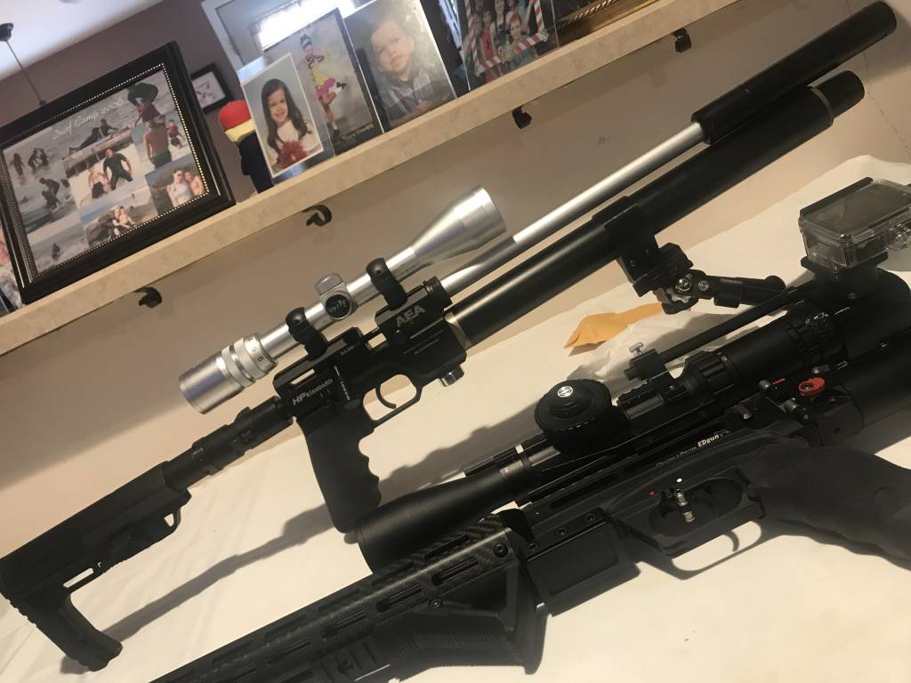

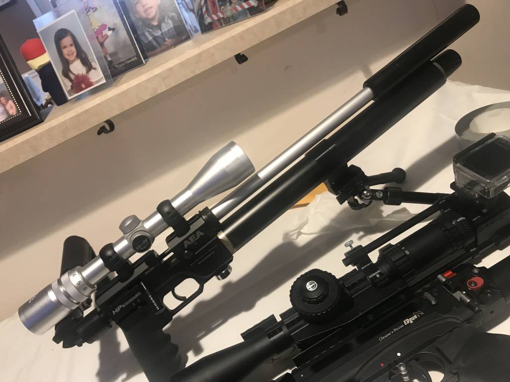

My always Morphing AEA 25 cal. I also have the original 350cc Regulated air tube and a 450cc Bottle predator light for the night critters and extra sun shades because day time shooting in my yard is brutal

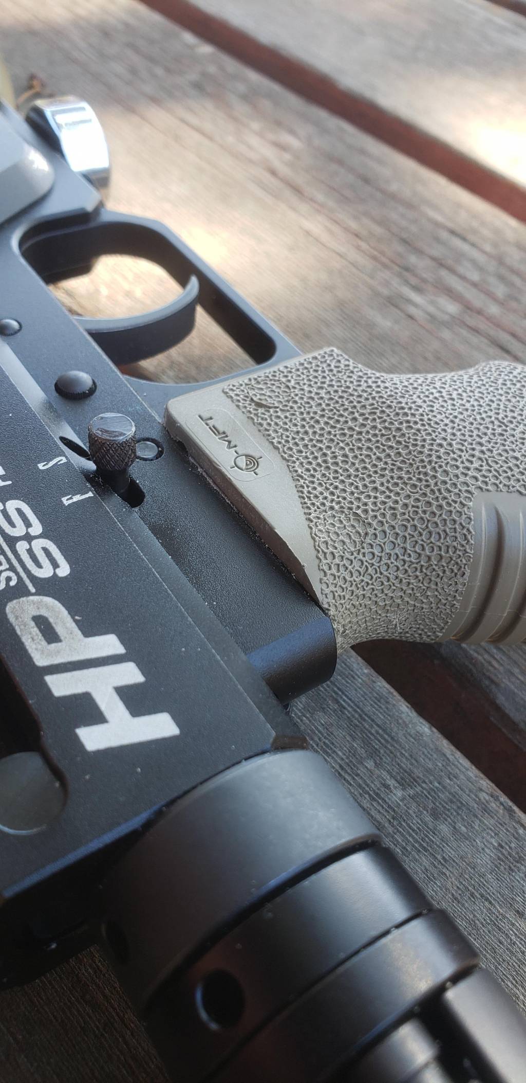

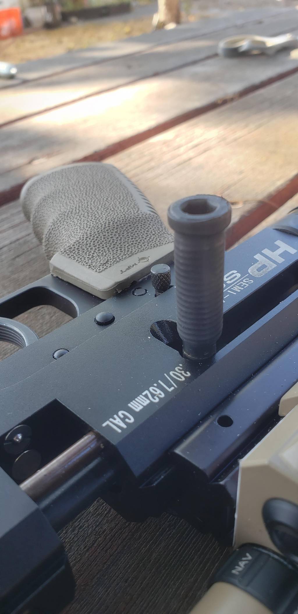

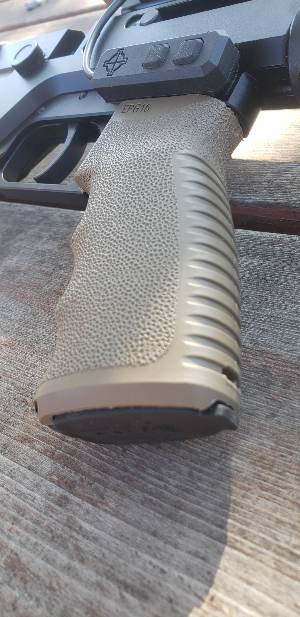

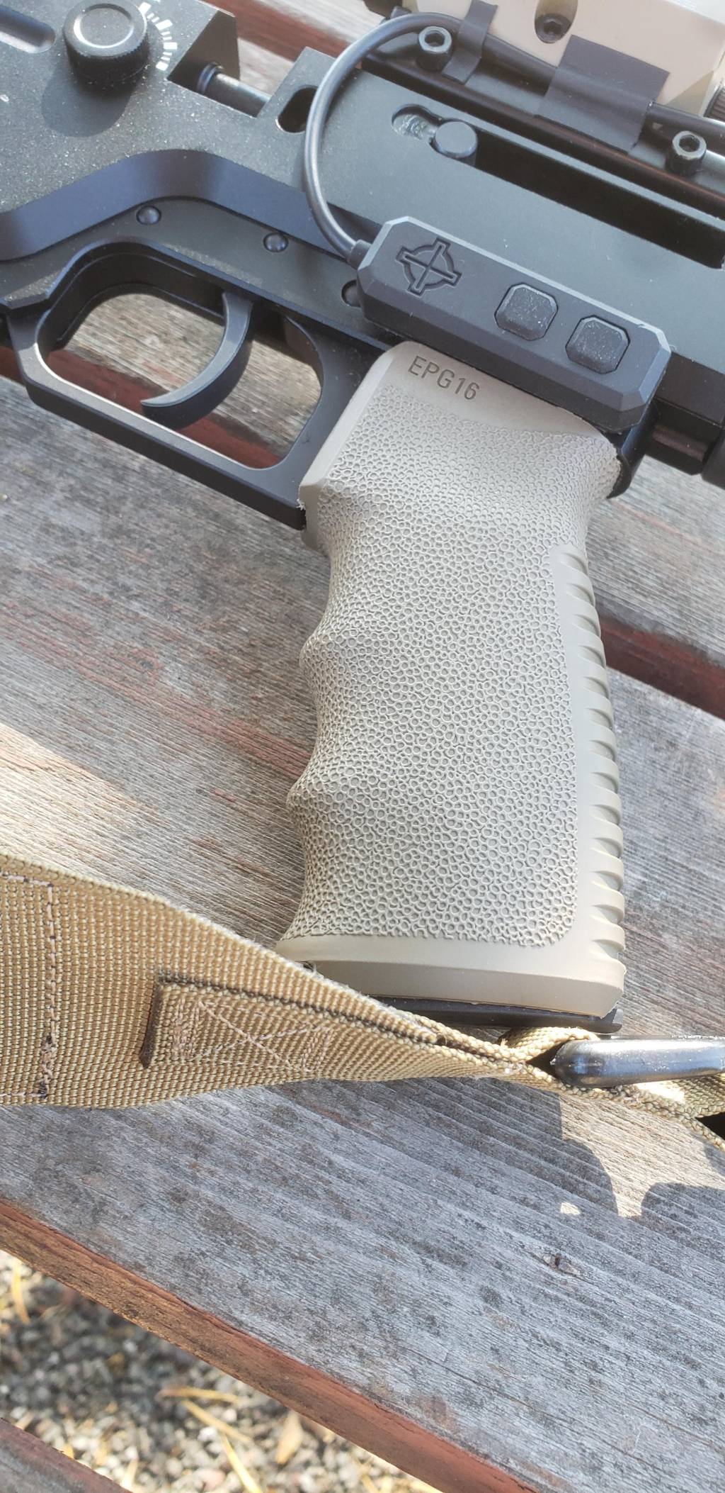

@JeffreyP123 Hey there, while looking into customising my own AEA HP SS i came across this forum and your post. I was wondering how you got t hat pistol grip to fit the HP SS if you're willing to share.
Seconding this! I really like how you were able to fit that on and I'd love to try myself...

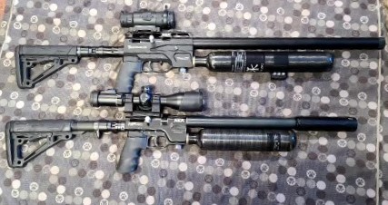

Size wise the HP TD (assassin, backpacker) receiver is like an AR 15 receiver size. Weighs around 6.5 lb. The Terminator receiver is more inline with the AR10 size receiver. Weighs in around 10lb. I took the stock bottle off and the front bottle off the Terminator and replaced with a .7 liter carbon fiber tank. Both rifles came with a folding stock though both have been replaced with Hogue stocks. The Terminator shoots around 100 FP and the TD shoots around 50 FP.
All HP carbines are semi-auto but can be converted to bolt. The Terminator is semi-auto only. Other than the Varmint all HP's I know of are semi-auto. The difference between the HP carbine and the HP TD is the TD comes with a larger carbon fiber bottle and has a folding stock. Both are semi-auto and have the same velocities. Bottles on both my rifles take 60mm clamp.
Terminator comes in two calibers, .30 and .357. HP Carbine and all its configurations come in .22, .25, and .30. One word of caution on AEA 30 cal barrels, all I have slugged measure .303 which limits ammo availability. Both of my rifles shoot slugs better than pellets. I shoot a 47.2 g .303 slug out of the Terminator and shoot a 26.8 g .249 out of the TD. Both shoot around 900 fps. I have shot the TD daily for over a year. It is my favorite rifle. Accurate enough to shoot 12 gauge hulls at 50 yards,

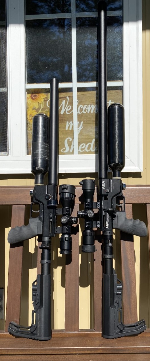

Firewalker is showing a carbine, semi-auto and a Varmint bolt gun. Both nice rifles he will have to speak of his favorite. I hear real good things about the Varmint.
Of the two I displayed the TD {carbine} is my favorite and I carry it daily while walking the dogs. Light and very accurate for me the perfect air rifle. My TD is in 25 cal and if I had to do it again I would think hard on 22 cal. Just for a bit more range. I also would forgo the TD ($899.)and purchase the carbine ($659). Same gun just fewer accessories. I have over 4k rounds through my TD and it is still going strong. Purchased mine through the Pellet Shop.
