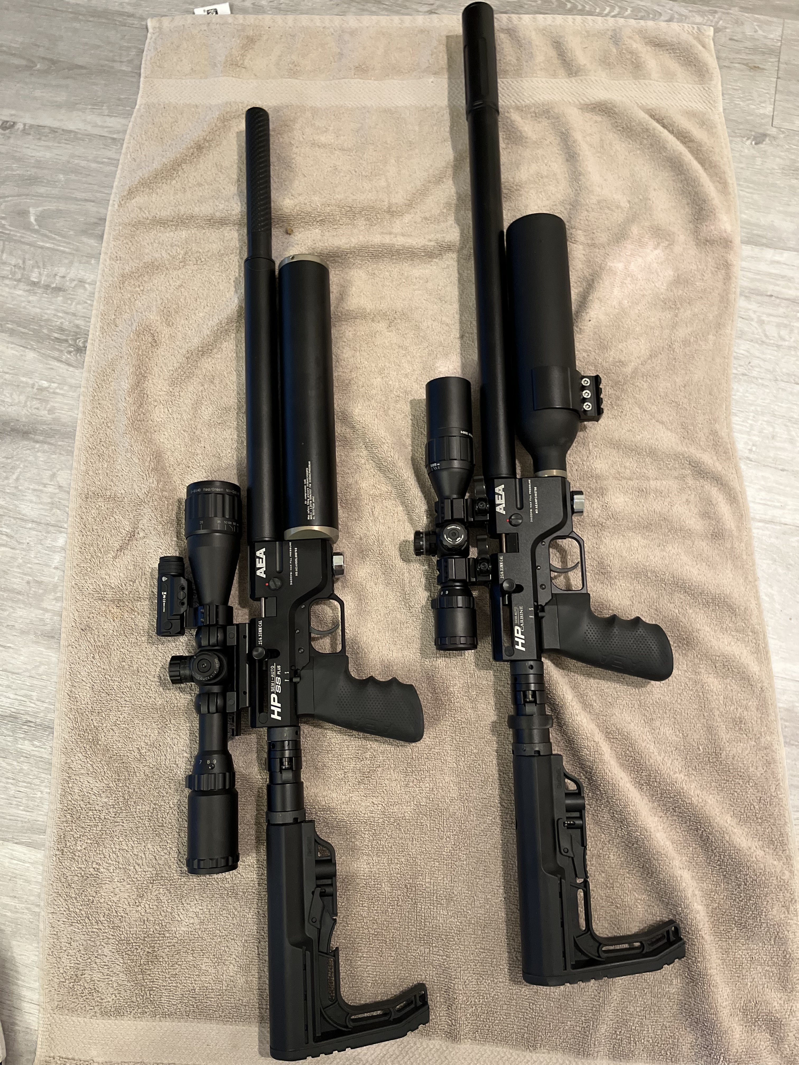

I have the HP Carbine in .22 and swapped out the aluminum bottle with Carbon Fiber and added a regulator. It's my EDC whenever I am out doing chores (pb on my hip too) and is zeroed at 30y.
850 fps with CPHP's, 4X12 Bugbuster on it makes for fast acquisition of bird sized targets.
The Varmint has the actual 24" barrel, I'm told it's a LW. It will throw a 48gr slug at 850 fps wide open. I mostly shoot 34gr Heavy Hunters at 950fps.

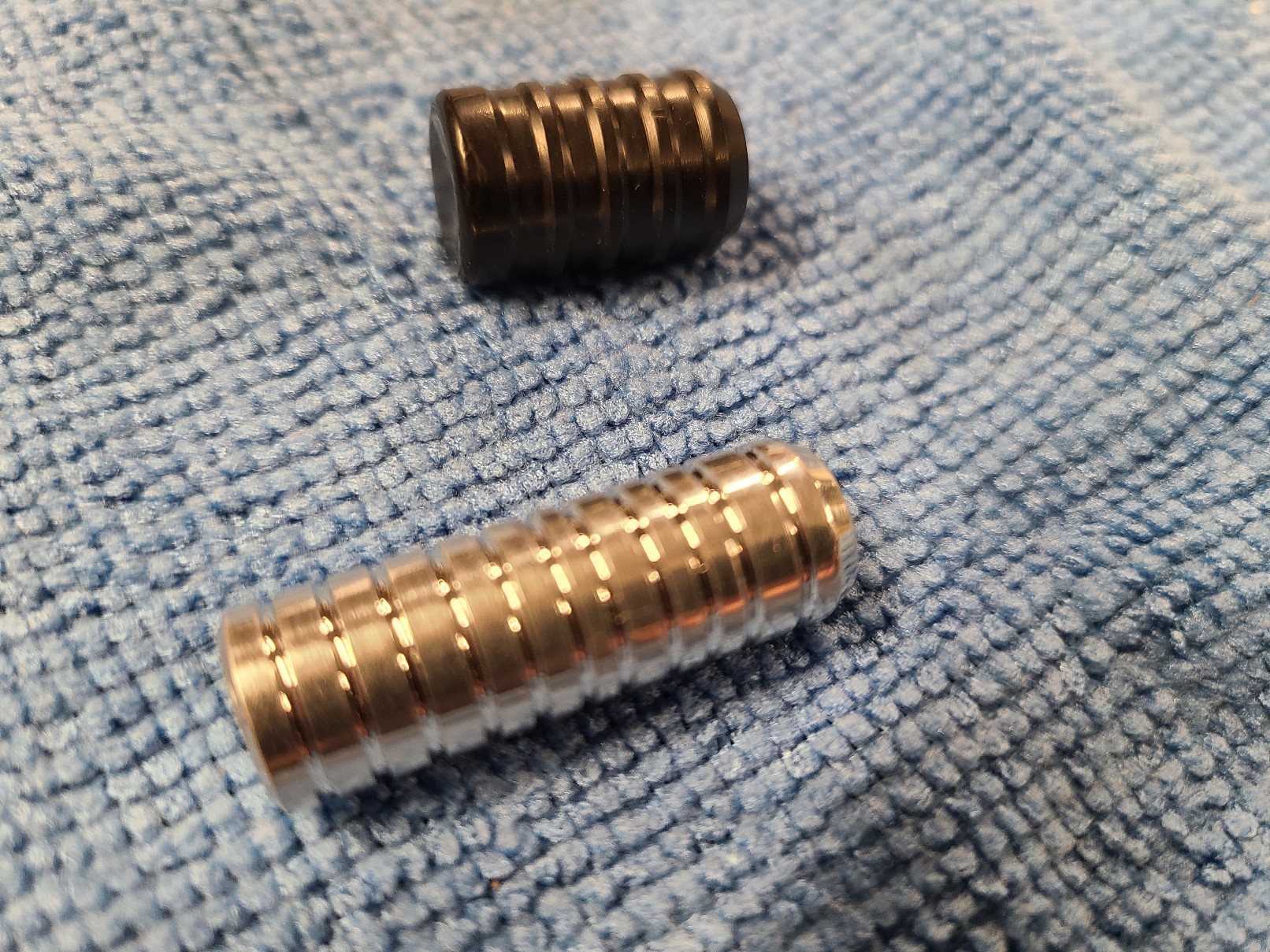

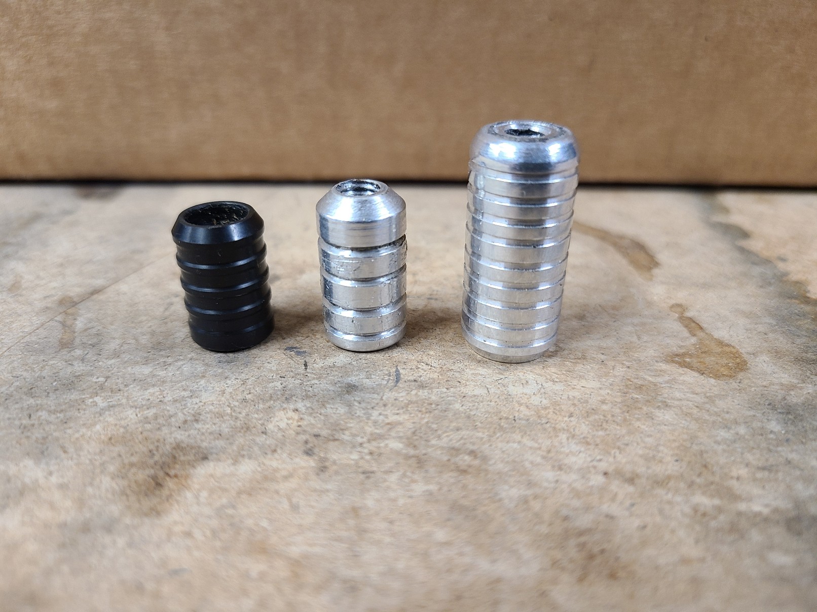

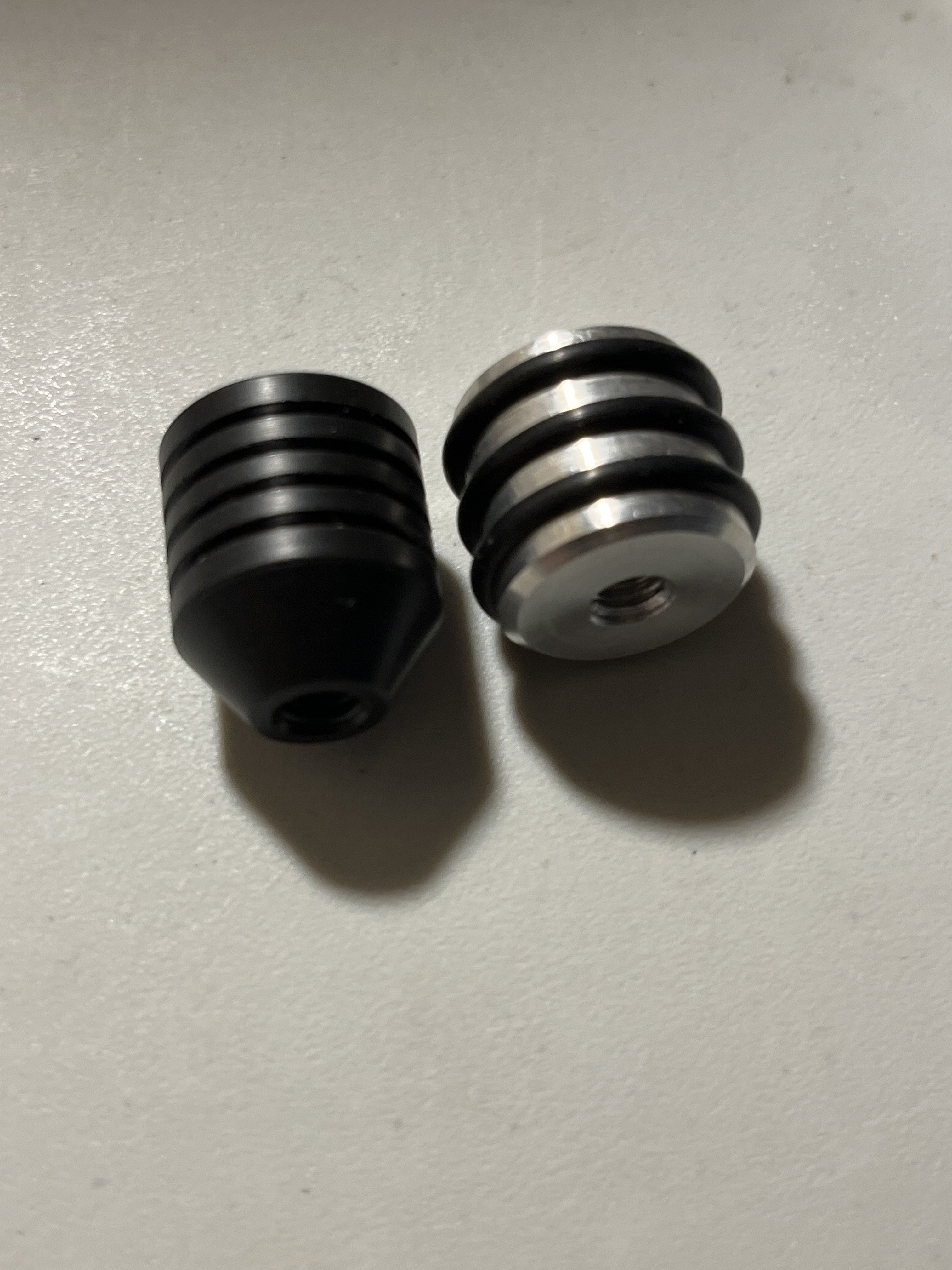

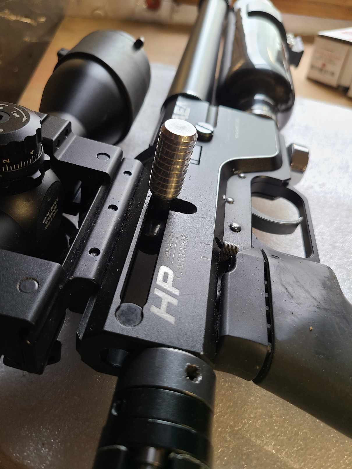

AEA guns have 2 flaws, 1 really but they are related. The hammer springs are extremely over sprung. This kicks the poppets too hard and breaks them. The cocking handle is also way too hard to cock, there is no reason for this, a balanced valve and a side lever would resolve this.
