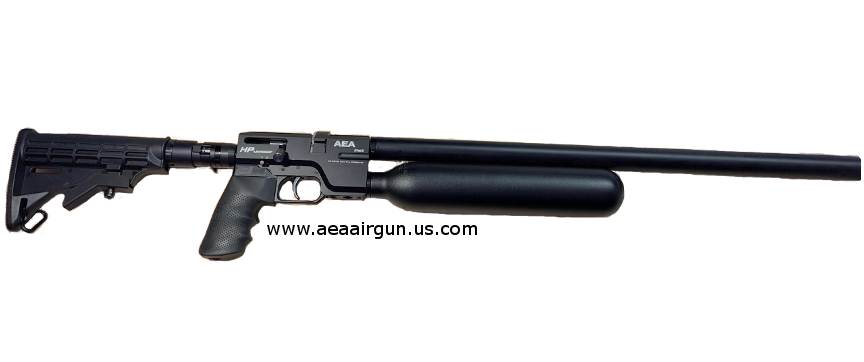

Don't have a pic on hand so I borrowed one from their US website. The pic appears to show a CF bottle but it comes with an aluminum one.

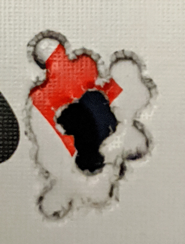

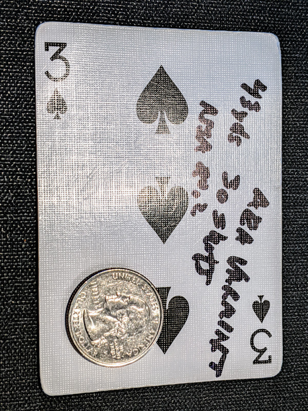

NSA 20.2 hollow points. Average velocity in the curve, 930 fps for 39 fpe.

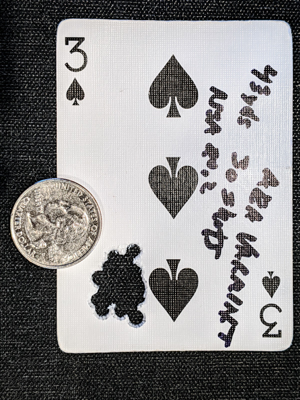

This a 30+ shot group at 43 yards. I was doing a shot string to find the sweet spot and this was about in the middle of the curve though it had a few on the front side that were iffy for velocity.
Easily covered by a quarter.

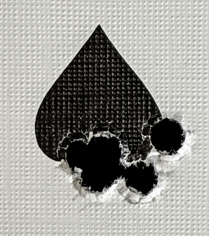

Here is my last sight in 5 shot group before that string. There are a string of shots around it as I moved the crosshairs so I didn't post it. After I figure out the starting pressure I'm going to see if I can duplicate these results. Shouldn't be tough given these were taken at a faster pace for chronographing.

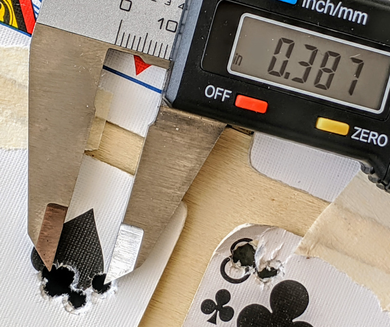

Here is one of the better groups again at 43 yards.
.387 CTC.

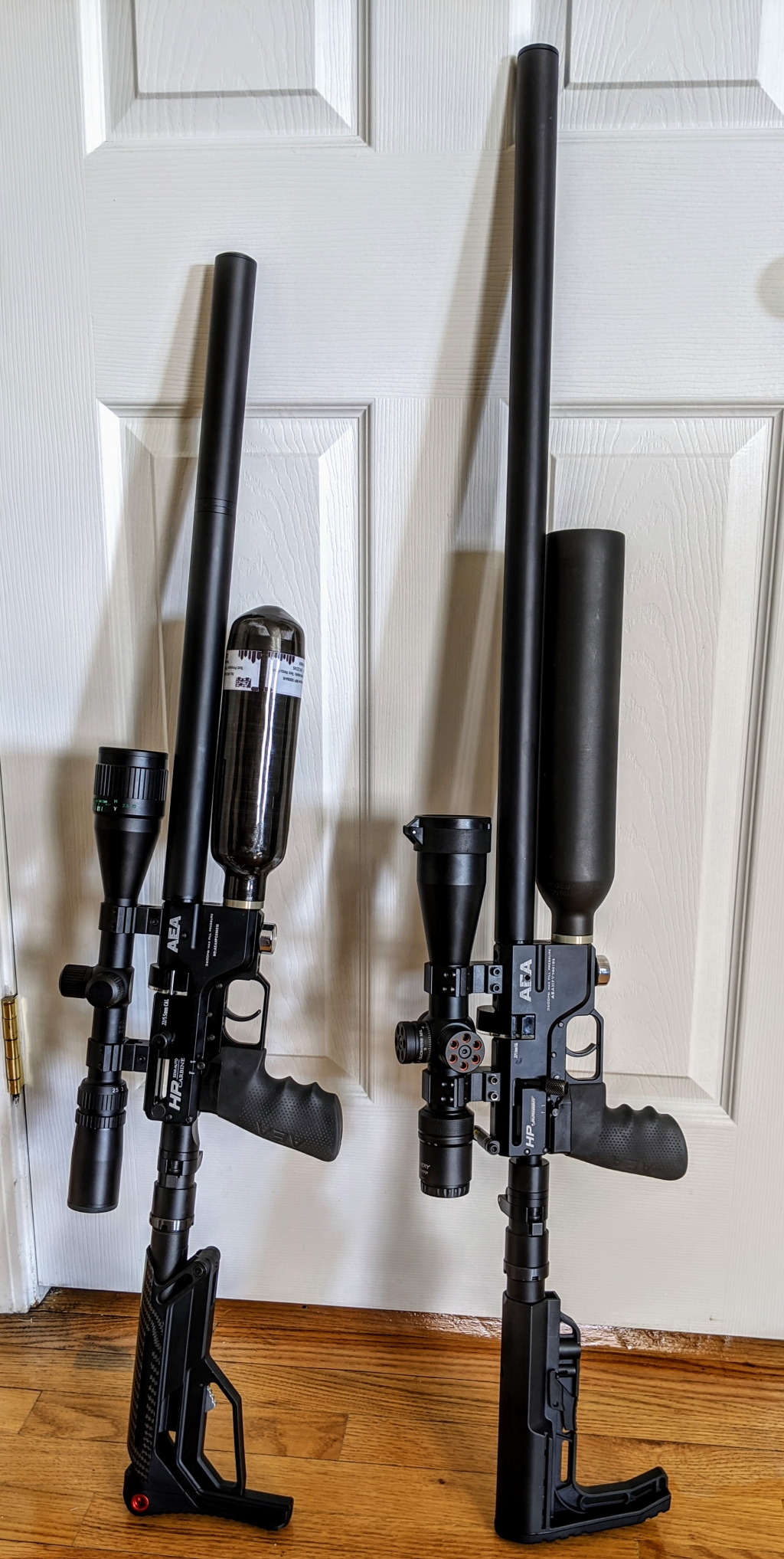

Does anyone have pictures of their own AEA rifle?
I really like the look, but the only pictures I've seen of the whole rifle are the bad ones from the factory or the silly photoshop of the "Backpacker" version.

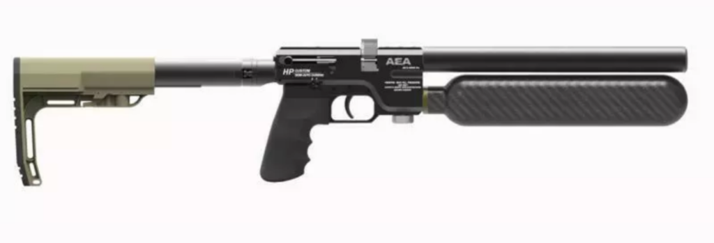

The moderator on the both the Varmint and the Backpacker are background friendly but the Backpacker is really good...as good as any add on. The semi-auto mechanism helps as well as it diverts some air from the barrel before it gets to the mod.

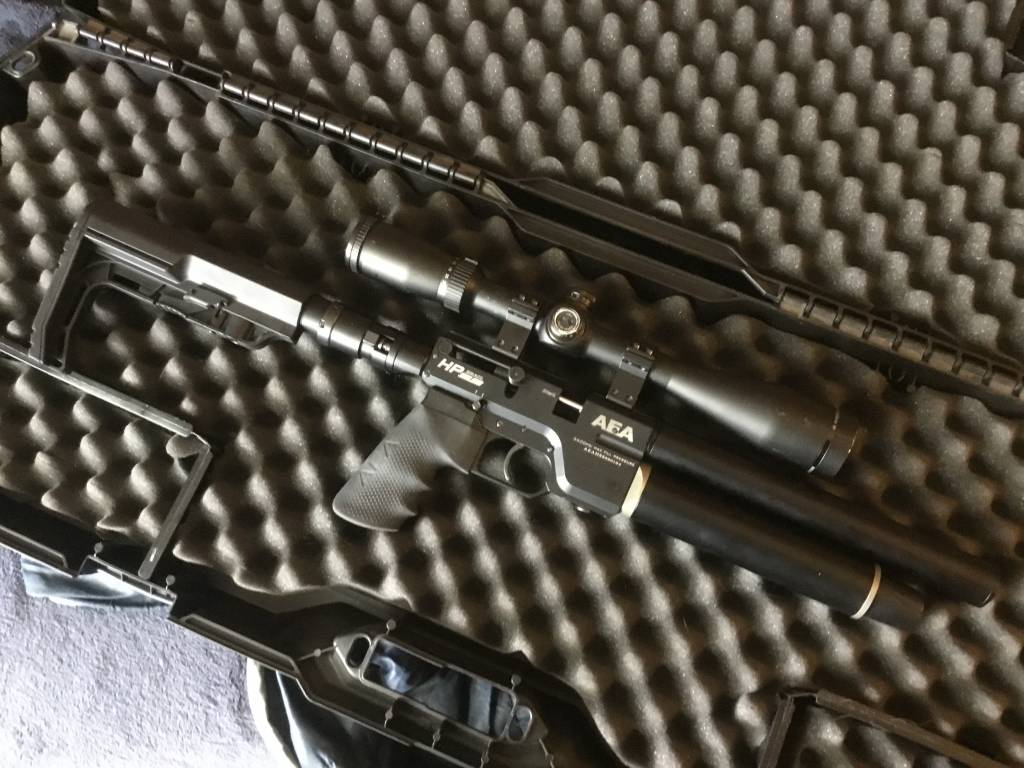

DanielL - What stock is that on the backpacker? It looks really good!
Did you buy yours from eBay? I saw a seller named "aeausa" who has a backpacker in stock.
Thank you for taking time to post a picture and info.
Yes. Bought from aeausa. The seller has been very supportive of fixing the issues I've had. The first one arrived with the wrong size magazine and it was broken to boot. He got me a replacement right away and then said he'd ship more when China was back online. He just shipped 4 for my trouble having to wait.
I actually don't like the stock on the Backpacker. I would have preferred something less ostentatious like the plain army green one shown in the advertisement...or flat black. I suspect they might have temporarily run out of parts and made a substitution so they could get it shipped. I contacted him on that as well.
