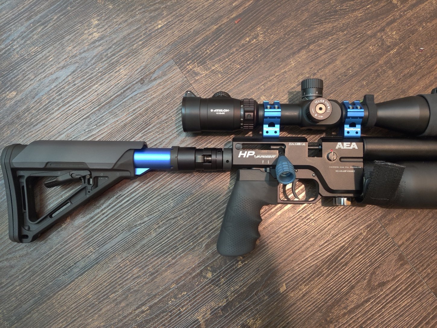

So my .25cal Varmint is here and I'm loving it so far!
It shoots JSB 25.39gr pellets hole-on-hole at 35 yards, moving around 920fps. That setting on the power wheel is a little over 1/3 up the scale, and it's very repeatable if I want to go back to it from another tune. The shot-to-shot velocity is remarkably consistent over at least 4 magazines of shooting.
The issue I'm seeing now, and I'm hoping someone else has a thought on it... When I'm tuning for slugs, I turn the power wheel all the way up. What happens is that the velocity starts pretty low (840), and the slugs don't group very well. But then after about 1 magazine, the velocity creeps up to about 880 and up to a little over 900, and the slugs will group to right on top of each other, actually sub-MOA.
This is with H&N 36gr and ZAN 37gr. Has anyone else seen this with their rifle? Every lower power setting on the dial shoots a very even shot string, but at max power it takes about 10 shots to get to a workable velocity.
My workaround for this so far has been to only fill to about 3400 PSI, or about the pressure when the shots start pushing past 880. If I do that, the velocity is good and the accuracy is like a laser beam. But obviously that means I'm sacrificing a certain percentage of my shot count. Is there something else I can do to counter this and still be able to fill my bottle to 3600? This only happens at the max power setting, and it would be great if I didn't have to sacrifice shot count for power and accuracy.
The problem is that your hammer is not striking hard enough to open the valve fully at high pressure and you’re seeing that with the heavier slugs.
Your solution of filling to lower pressure is a good one. An easy alternative would be to add some spacers to increase the amount of preload on your hammer spring. Another possibility is increasing the weight of the hammer but that is probably not as simple.

This seems to be the norm for these guns. 3600 is just a bit too hard to crack/dwell the valve. Most have found what you have, 3400 down for the sweet spot. It’s kinda nature of the beast when running unregulated.
Different springs and hammer weights can change this but I’m not of the opinion the gains are worth it. Sounds like yours is performing quite well.

Thanks everyone for the insight. I think I'll probably just fill to 3400 when I shoot slugs, since that's predictable, and I wouldn't need to make any changes to the gun. I can fill all the way to 3600 to shoot 25.4 pellets and the velocity is even from the first shot.
But out of curiosity... If I were to preload the hammer spring a bit in order to even out the shot string at max power- would that be likely to ruin my consistency for my pellet tune? I'd hate to sacrifice one for the other.
