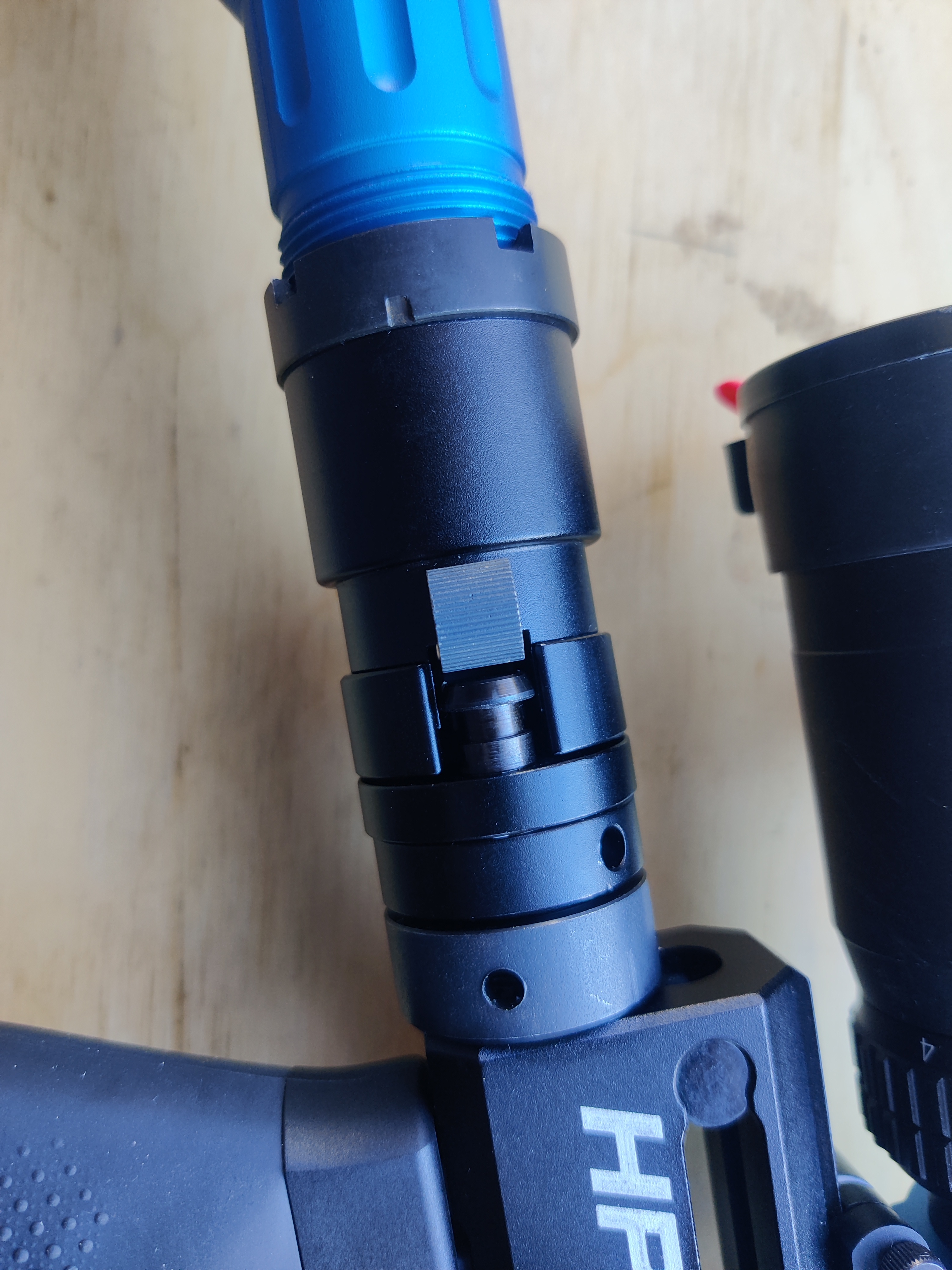

Also: my folding stock latch just stopped working when I was taking the trigger group out. It had always been a little rattly, but now it failed altogether to hold the stock open. Has anyone seen this? IMG_20220928_173340.jpg

Also: my folding stock latch just stopped working when I was taking the trigger group out. It had always been a little rattly, but now it failed altogether to hold the stock open. Has anyone seen this?View attachment 293375
Yes. My Varmint did that. I had to disassemble the folding stock and use a Dremel to let it "bite" more onto the post. Or just stretch the spring a little so it pushes to the post harder.
Thanks! Looks like that cleared it up for me, as well. I may try to do a little more at some point but that fixed it.
That's the mod I did on my carbine, works very well. The Varmint just got a little dressing on the latch surface to sit fully closed and that solved any rattle.

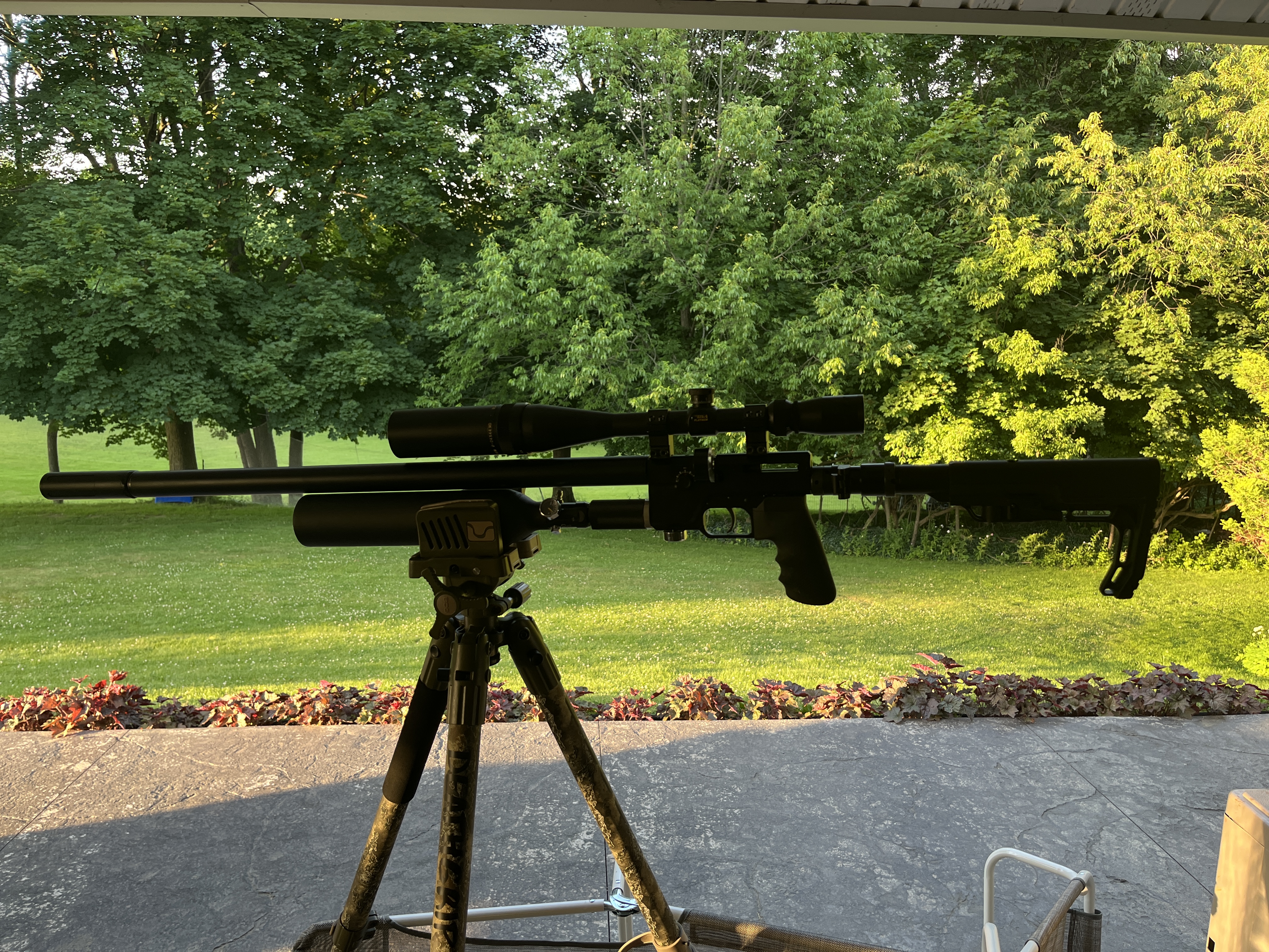

Here is a pic of my.22 with a bottle reg and a adapter plenum. It was very cheap to setup. Let me run 300bar in the bottle and I regulated it to 3200psi. Which was peak pressure for my shot strings. 23gr javelin’s at 950ish instead of 1100+ fps. If it had more plenum it wouldn’t have slowed them down. Still had to turn the power way down for barracuda hunter extreme’s and hades.
