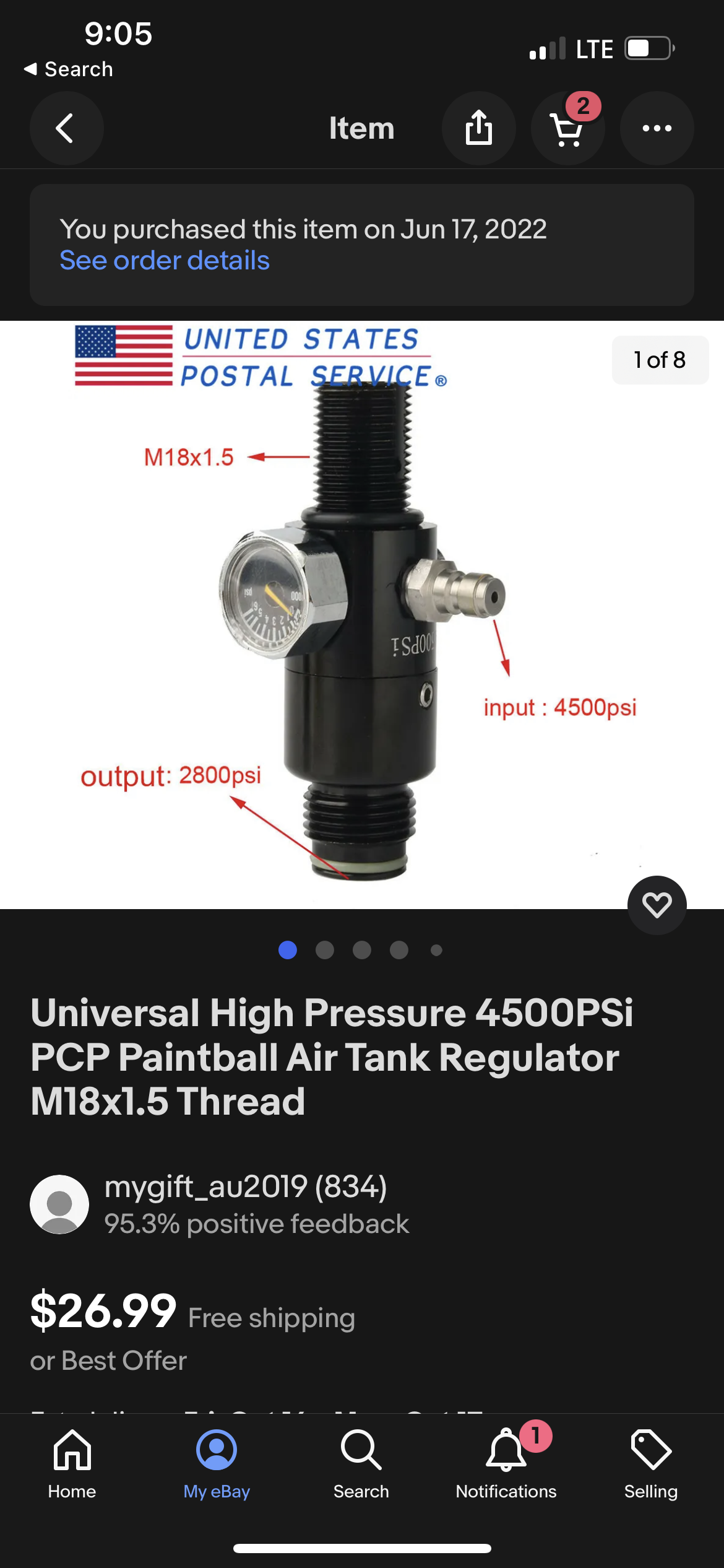

I added 2 shims to the reg. The little plenum adapter only has one small offset hole so I drilled 2 or 3 more.

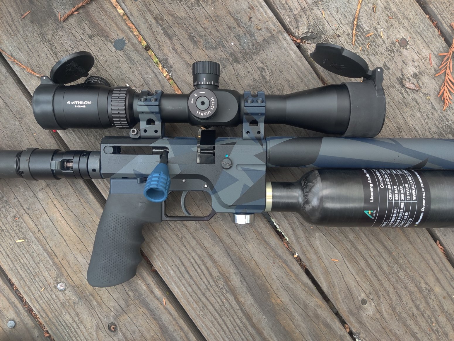

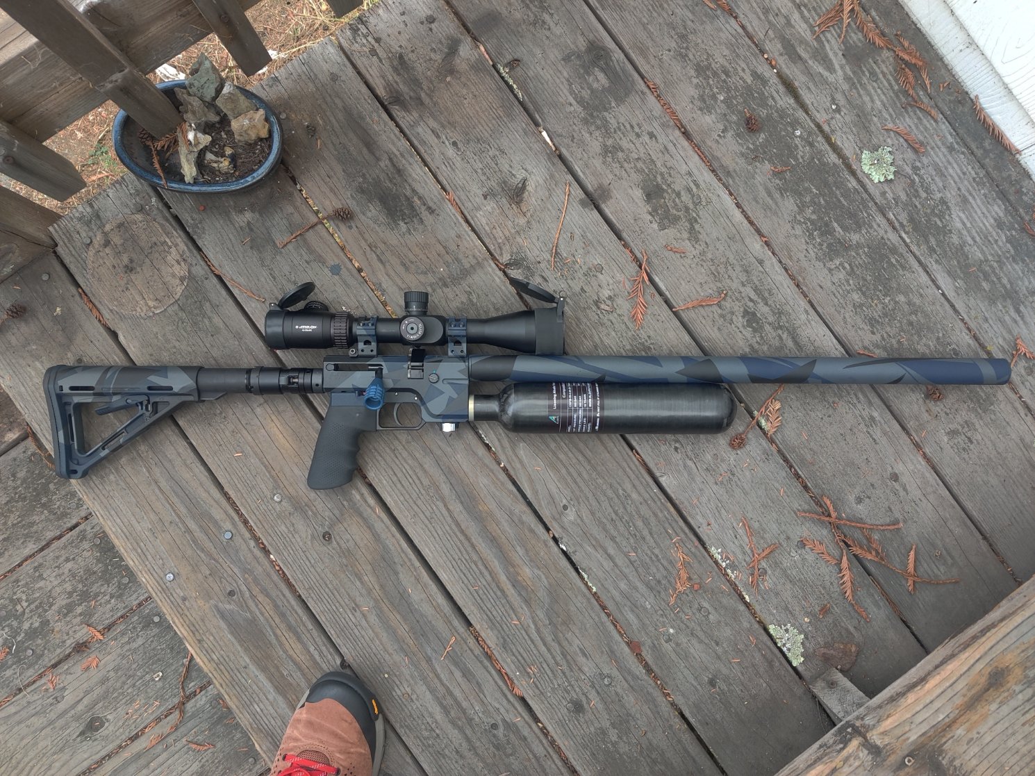

My 25cal Varmint is really proving to be the value gun that I'd hoped. It stacks 25.4gr JSB pellets and 36gr H&N slugs on top of each other at 35yds.
My only wish was that it either liked lightweight slugs a bit more, or that it had about 50fps more to give with the heavy slugs that it likes. It moves 26gr FX Hybrid slugs at 1020fps and 26.8gr Nielsens at 1010. The FX don't group at all, and the Nielsens group about an inch at 35yds. I'll stick with the H&N 36s because I can shoot inside out on a 3/4" dot at that range. But they're only moving at about 880-890. It would be great if I could get them up to about 950 or so for a good flat trajectory for small game hunting.
I had the gun apart over the last week to do a Duracoat camo job, and that included taking off the barrel. While I was in there I expanded the barrel transfer ports from 3/32 up to 7/64. The barrel uses 6 of them, so combined that's a good amount extra. I'll report back on power gains or accuracy losses and whether or not I ruined my rifle. Until then, here it is in the new 2023 colors.
EDIT: Also added a .58L CF bottle during the teardown. I like the lighter weight and slightly increased capacity.

Fantastic job on the paint!!
I’m curious of any changes from the port mods. I feel like accuracy shouldn’t be effected unless you just left some nasty burrs.
Dave
I really tried to get in there with a fine file and get rid of all the burrs, so we'll see. I used a pull-through patch to confirm and was finished when I got rid of anything that left behind any lint. Fingers crossed!

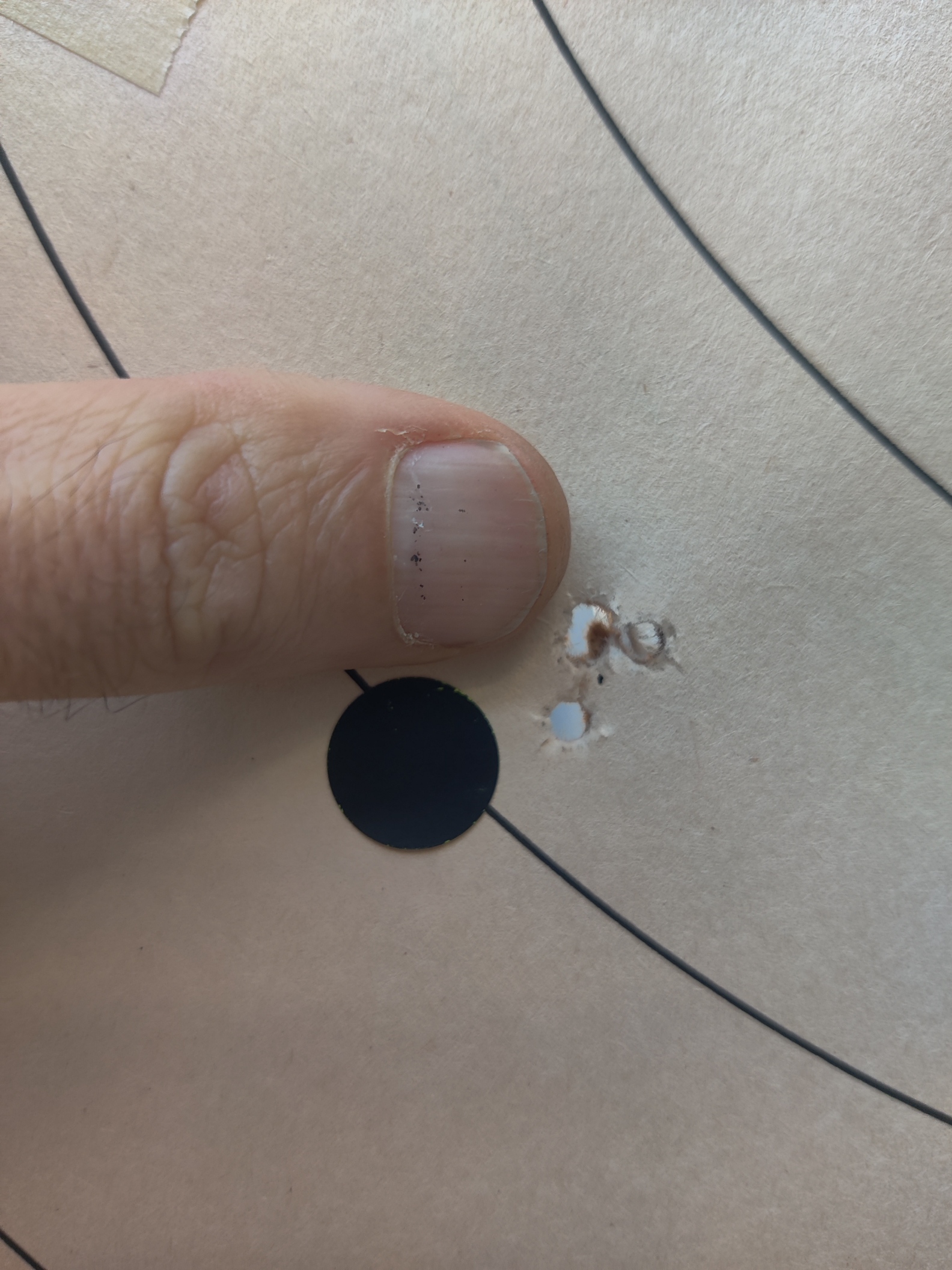

I just got back from the range- first test of my Varmint since opening the transfer port.
VERDICT: Don't bother. I opened the ports up one drill size above the factory ones. There are 6 that circle the breech, so the effect should have been pronounced as a cumulative addition of all the added port area. The end result seems to be that I bought myself about 10fps at max power. My 36gr H&N slugs are now moving at 900-910, up from about 890. Didn't seem to take any hit in accuracy, but drilling into the barrel wasn't worth the risk for such a small bump in power. I'm happy I didn't mess up the accuracy and it still shoots like a laser beam, but I wouldn't do it if I'd thought I'd only get a tiny bump in speed like that.

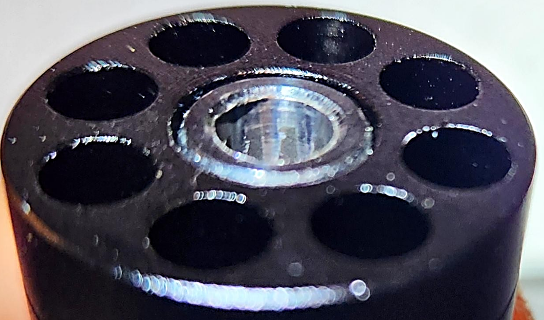

Just got an HP Carbine in .25 and was planning to follow Sicumj's lead on polishing the barrel crown. Once I got a close look at it I'm thinking it needs a lot more than just polish. Would anyone recommend cutting it back to get a clean break on the rifling?View attachment 302337
Looks like a good sized burr on the upper left. I would return the gun.
