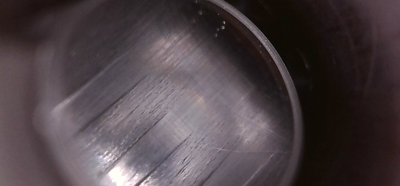

I agree it is a good sized burr. For some reason AEA tapers the bore at the muzzle. Mine starts about half an inch back tapering to almost no grooves at the muzzle. If they won't take it back you probably could still grind it out.
Cutting it off and crowning would be a job. I'm not sure what all would have to be changed to get it to operate semi auto again. Probably shroud trim and adjustment to the disc that works the semiauto function.
Reactions: MarksmanPete
The bore and the chamber are tapered the same. Looks to me like the same tool. First is the chamber and second is the bore. Both my rifles are like this. For whatever reason they do this is beyond me but my rifles shot well after lapping the barrels and trueing the muzzle end.
Look how ruff the lands and grooves are. I have lapped this barrel 3 times with JB bore. There was a lot of rust in one of my guns and both had tight spots as you pushed a pellet through the barrel. I lapped until the tight spots were gone.

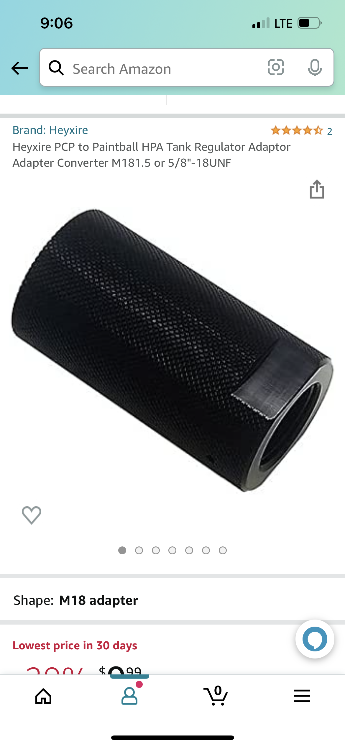

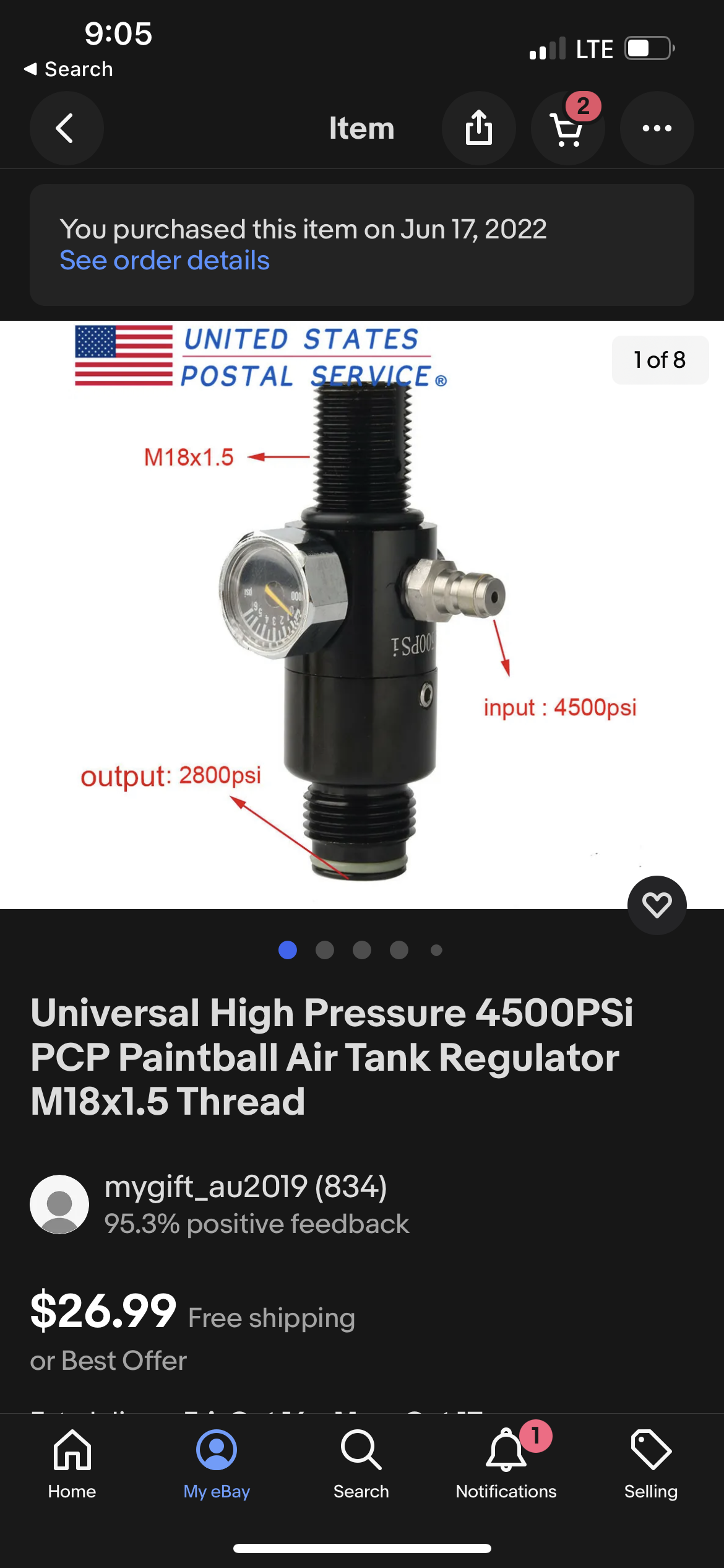

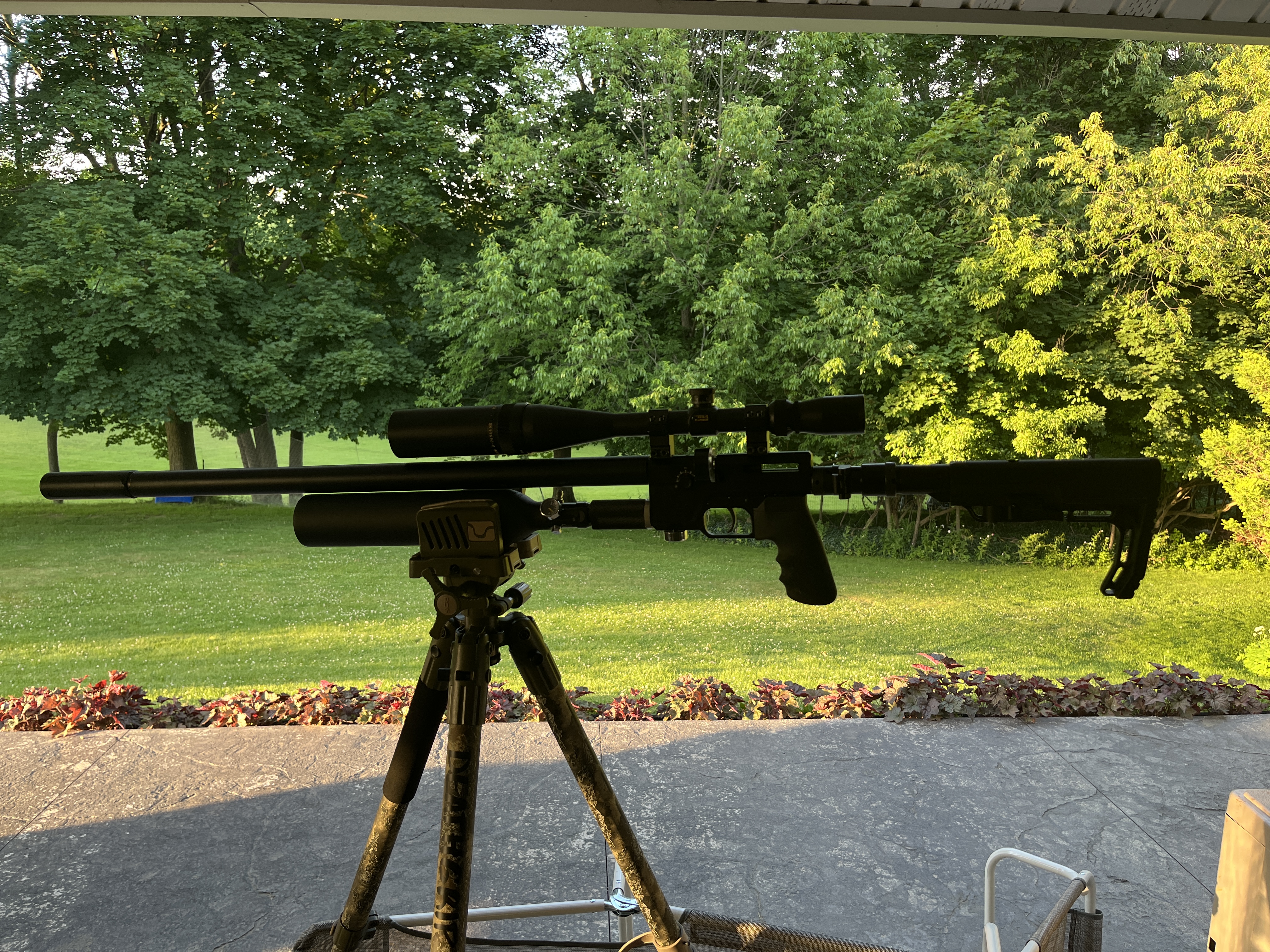

Here is a pic of my.22 with a bottle reg and a adapter plenum. It was very cheap to setup. Let me run 300bar in the bottle and I regulated it to 3200psi. Which was peak pressure for my shot strings. 23gr javelin’s at 950ish instead of 1100+ fps. If it had more plenum it wouldn’t have slowed them down. Still had to turn the power way down for barracuda hunter extreme’s and hades.
Wait so you lost power by adding the reg so where would you find that larger plenums, Is it worth the upgrade I got a 25 cal varmint. Im so new to these aea airguns im just trying to give my varmint some more potential if possible before I stard running my stash of rounds down range.
