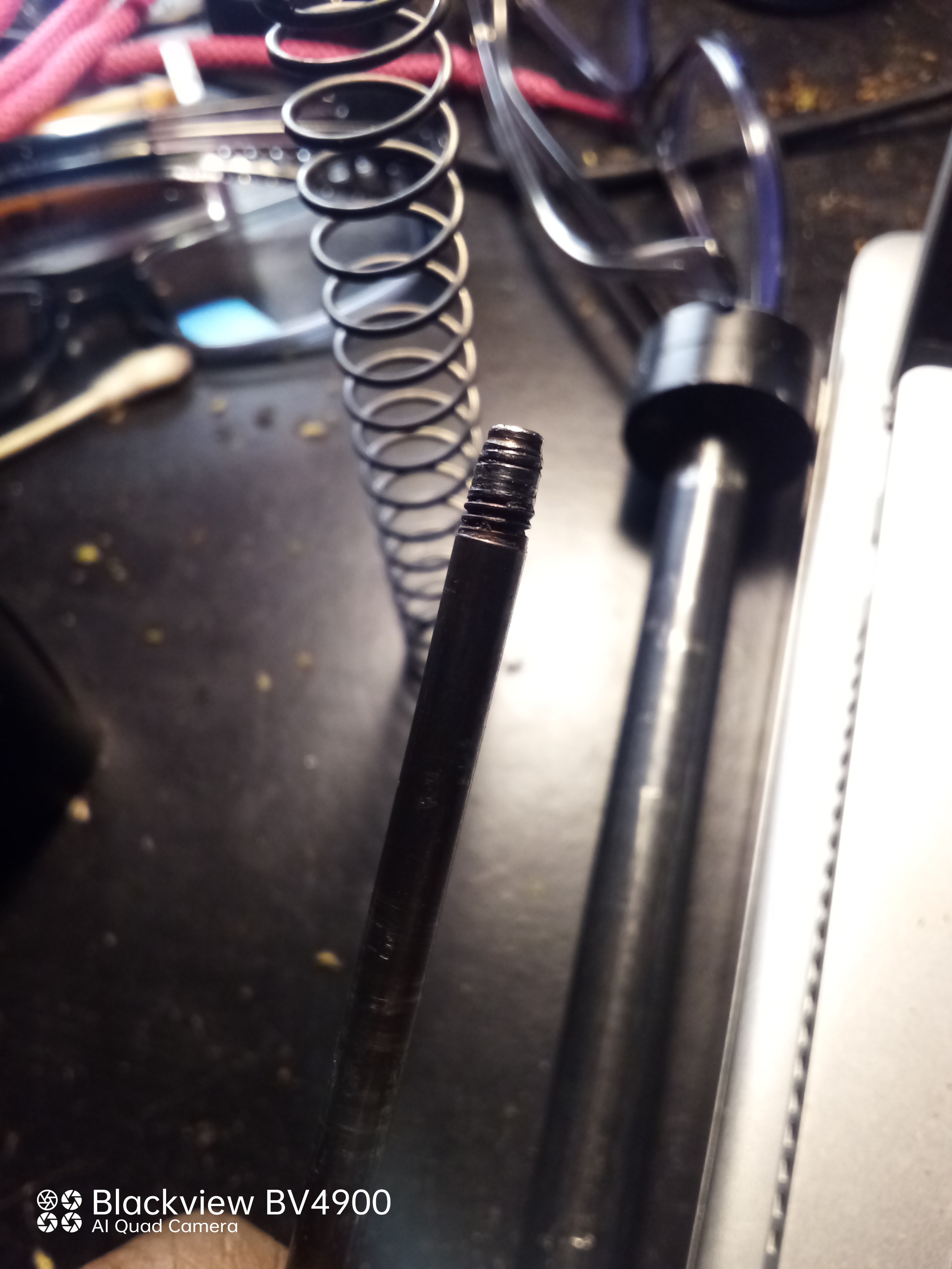

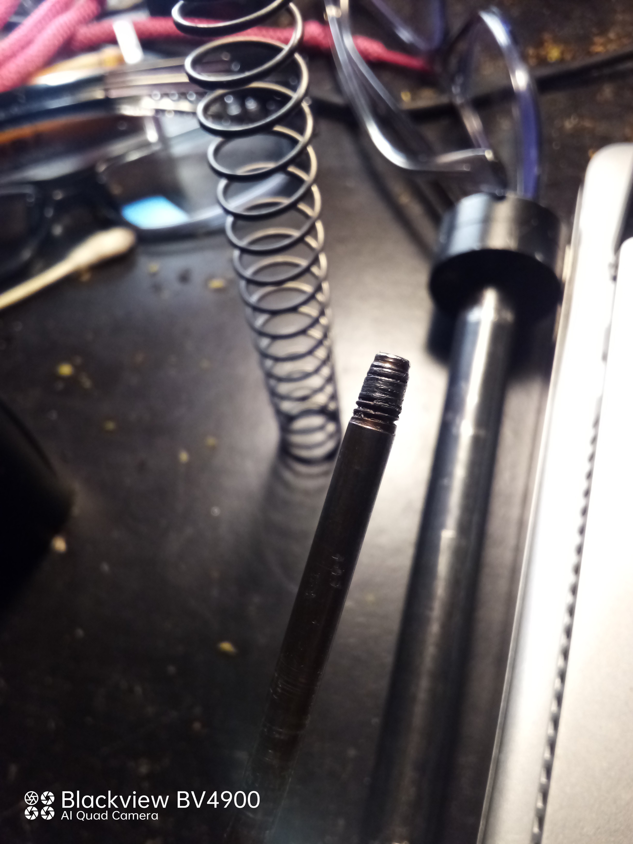

Welp, I wasted $499; I have trouble with the SS hp .25 cal. The bolt rod is stripped because it can not handle itself. I experience jam after jam; my magazines stop functioning properly the second day using it. I feel foolish for paying so much for something I thought would be awesome. Can anybody point me to the right website to get genuine replacement parts?

Cut the stripped part off threaded rod and thread trimmed rod into the bolt. You have plenty of thread left. You need to make sure the Bolt handle is not stripped also. Screw the black cylinder out on the threaded rod the same number of threads you cut off. Gun should be ready to go.
If the magazine has no spring pressure it has slipped out of its hole. There are You tube videos on how to do this.
