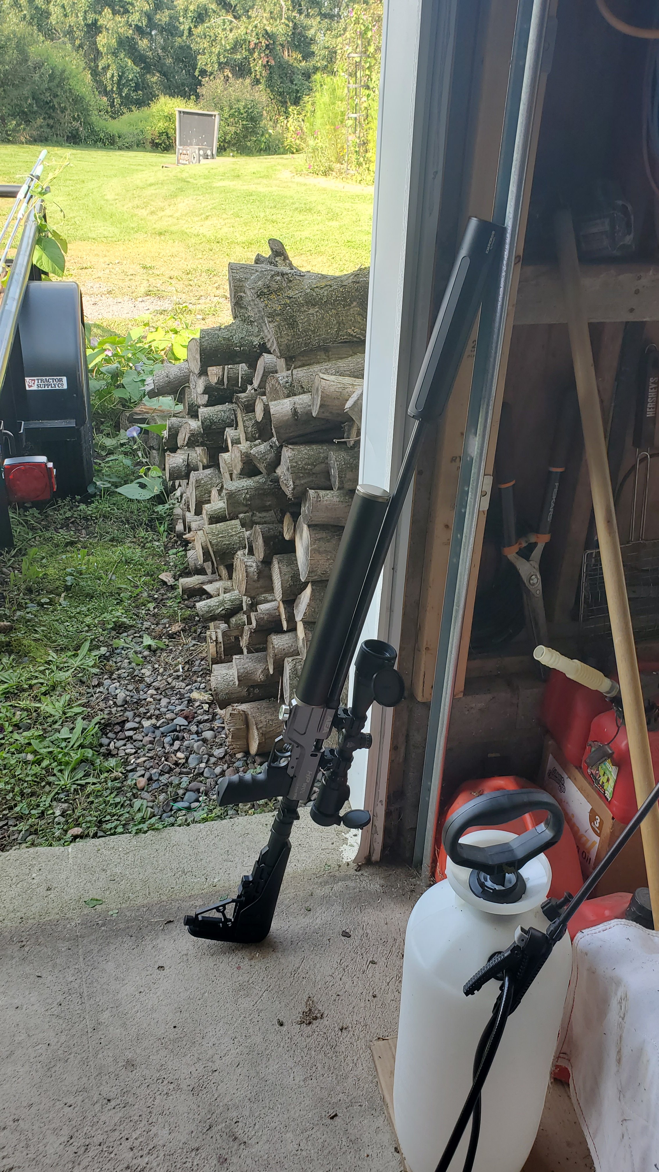

Just got my Emperor mod for my m50 and took a few shoots with it tonight. All in all I am happy with it and it should serve its purpose as a nice 50yrd deer gun. I do have a slow leak in it somewhere but so did my FX Maverick out of box. Going to back up to 50yrds and see whats up.
3 low and right shots where sighting in shots.
