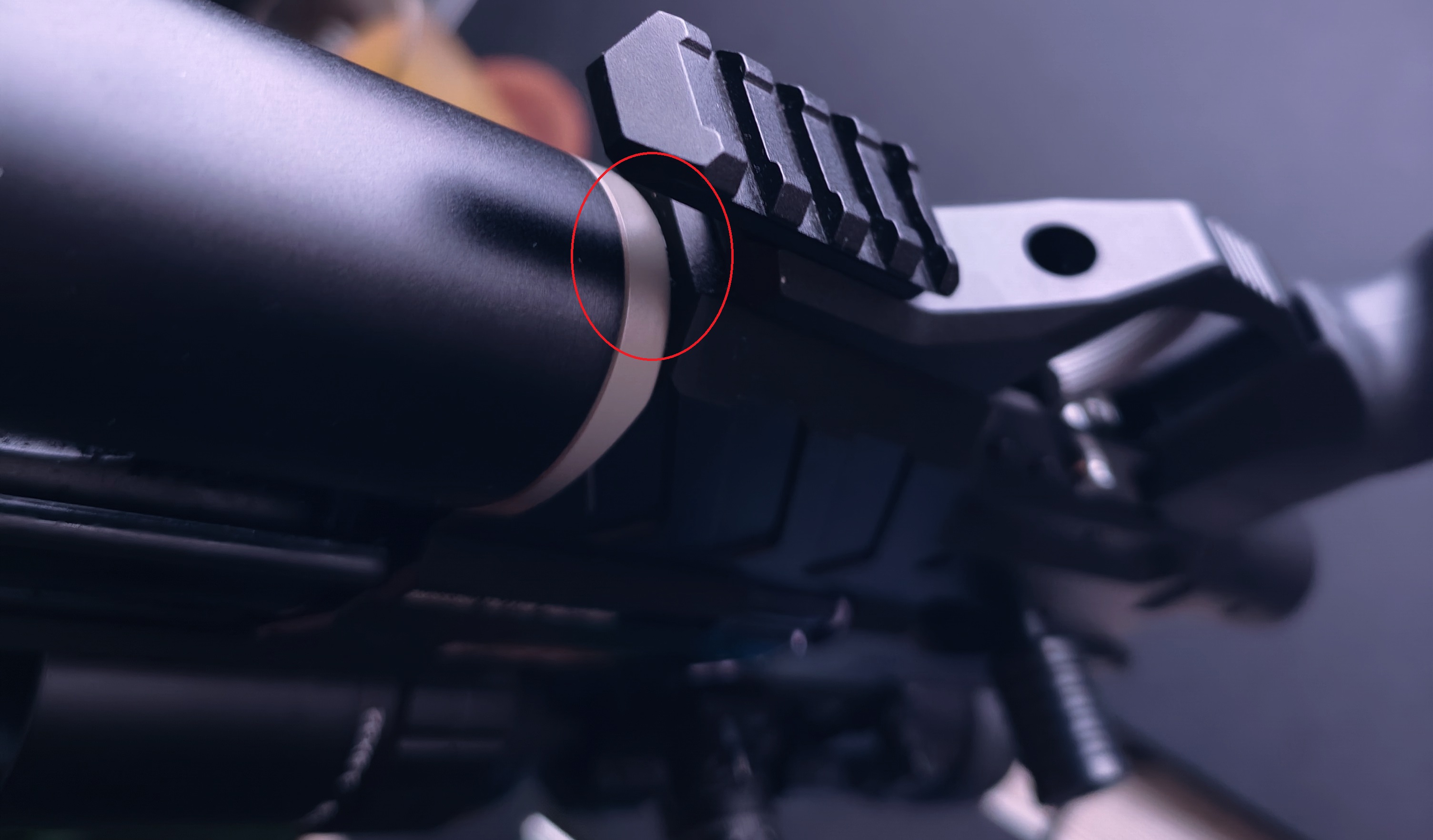

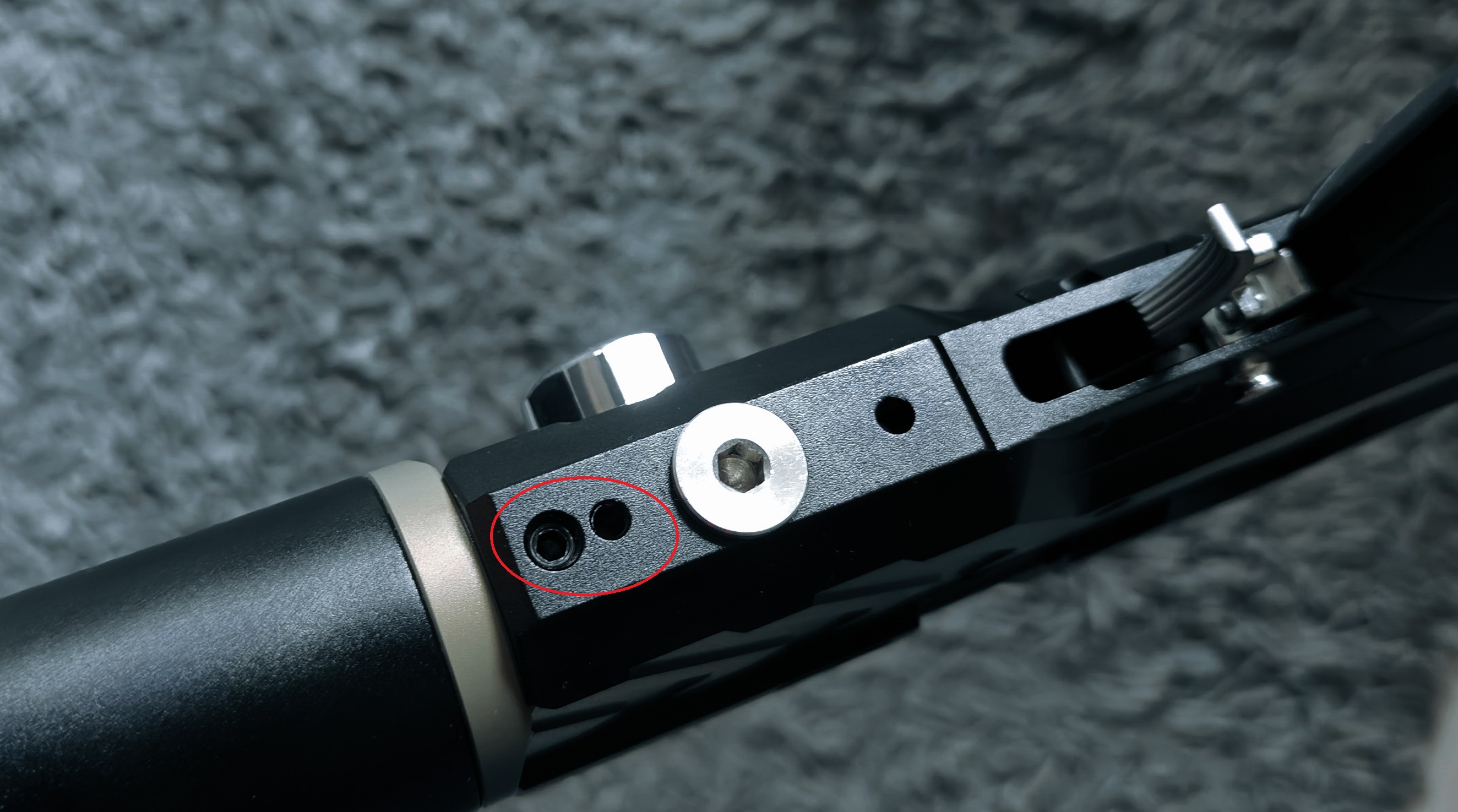

But now, I bought an AEA Megalodon not long ago, and same thing happened. It's leaking! Brand new. I did not even pulled the trigger once. Now I have to deal with this.![]()
Well, turned out, the leaking is coming from here.Please keep us updated. I have been eying the Meg for awhile. Seems like an O ring maybe?? I'm newish to these things and learning as I go. Good luck figuring it out.

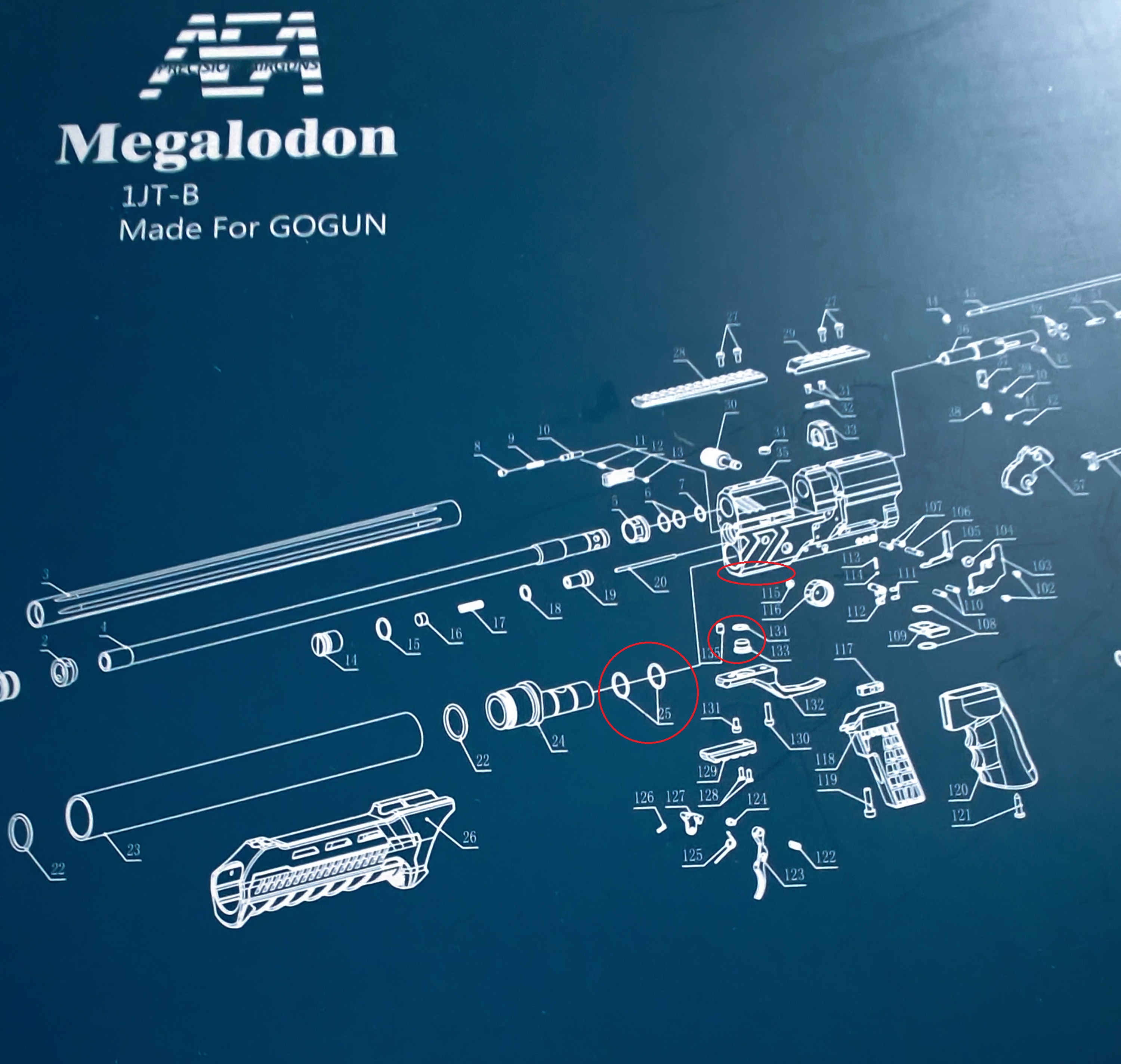

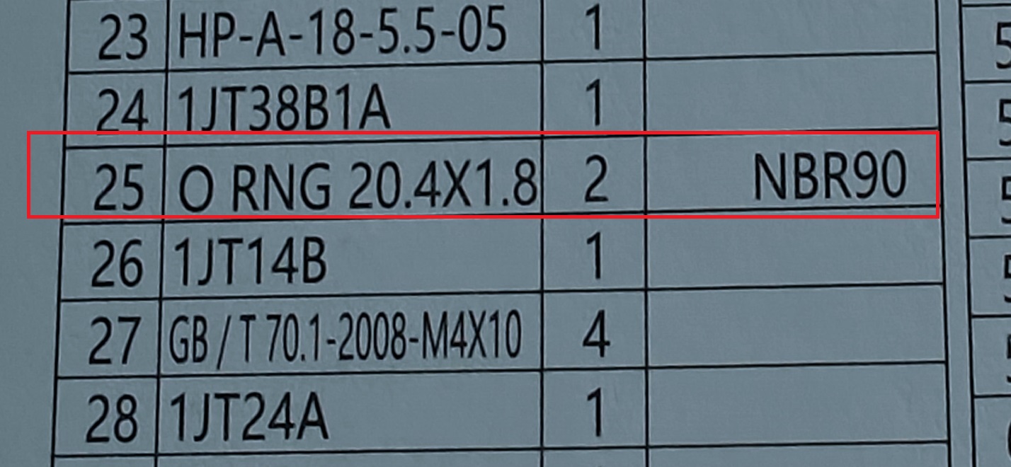

View attachment 525259 I took out the main airtank. No visible damage on the o-rings. I put it back. Still leaking. I guess, I have to replace them either way. The problem is, I don't have this kind of o-ring right now (20.4 x 1.8 NBR 90). I don't even know where to buy these from. :/
