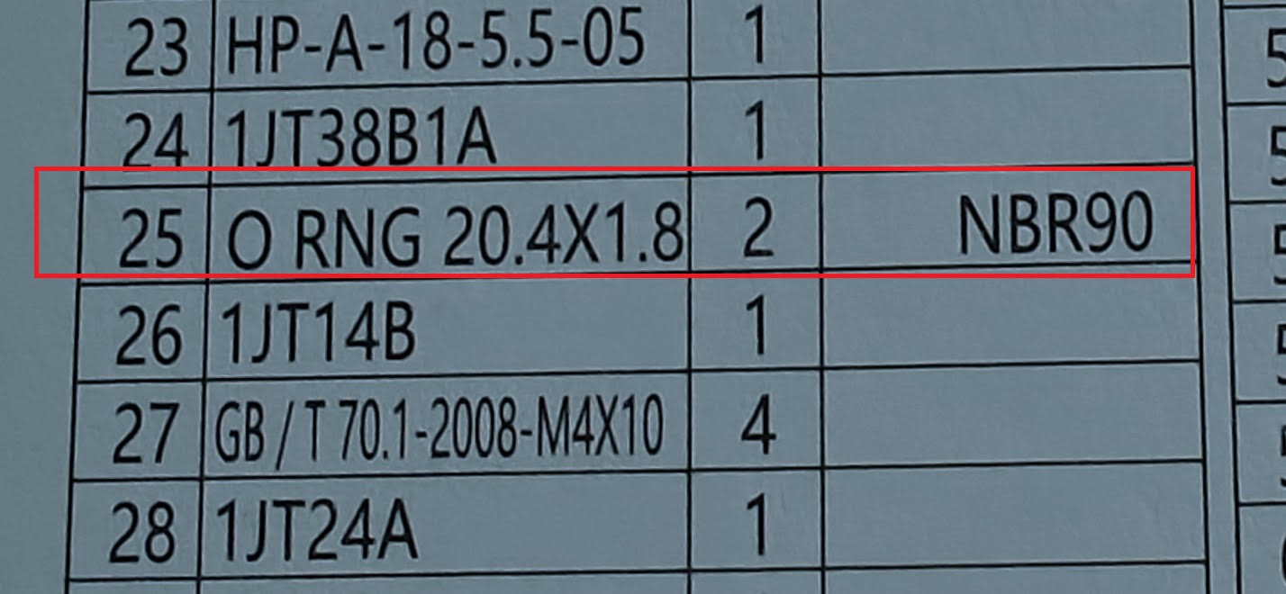

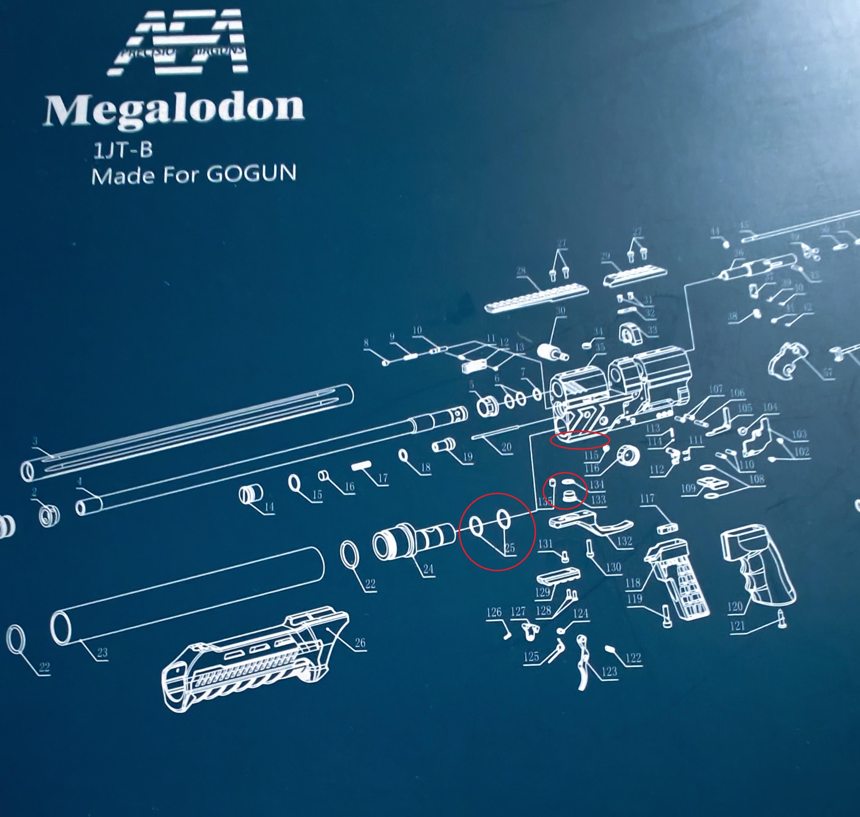

Where can I find this o-ring for my Megalodon? Slow leak, main tank. I live in Europe.
I asked Airguns Europe, AEA Airguns Shop, Benke Sport, Gogun...neither has this. :rolleyes:
(20.4 x 1.8 NBR 90)

i have to ask, is 20,4mm the outside diameter?
I normally buy special sized orings on special shops for them, like HUG.

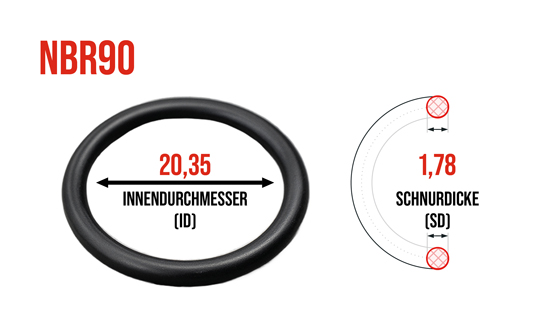

If its inner diameter is 20,4mm, you could try this:
Maybe the chinese dont mind the 0,05mm and declare its a 20,4 but in reality its an 20,35....
If its the outside diameter, maybe this could possibly fit (i calculated 20,4-1,8-1,8 which results in 16,8mm inside diameter):
Maybe it would be good if you measure the oring exact by yourself, so that you have clean results.
