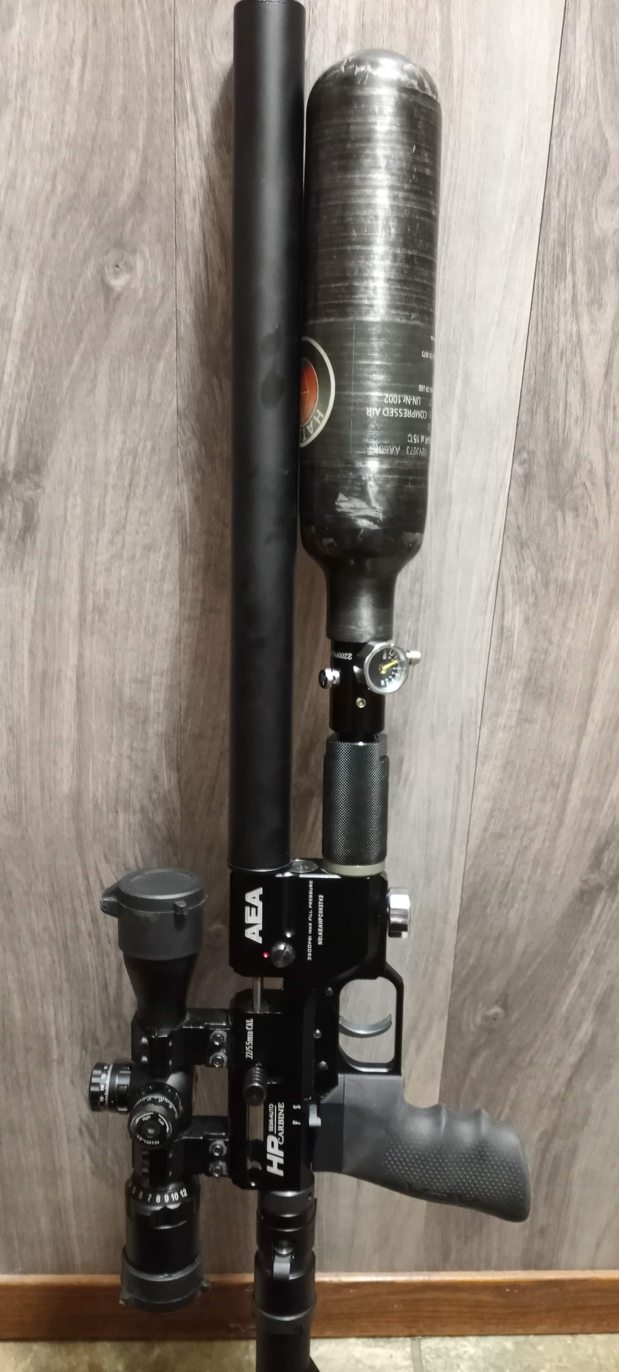

Full disclosure:
It took me a long time to tune the semi-auto function to the point that I could mag-dump without a jam. I added a carbon fiber bottle and a regulator with a small plenum, added 6 spent .22lr casings to the support ring to limit the air to the piston.

Gun
