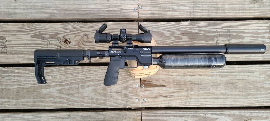

i have a first gen 22 cal. hpss semi auto, that i purchased a adapter/ DFL , & installed a tatsu on , it cycles great & has all of the baffles in the shroud it came with,, on monday 1-3-22 i recieved a new 22 Cal AEA hpss + with a tube air reservoir, ( 1 st gen has a 500 cc metal bottle) that i am thinking about swiping the tatsu & adapter from gen 1 & installing , but it will be a few days, it is 2 degrees right now heading towards 4 minus, ..
This gun cycled well with no issues.

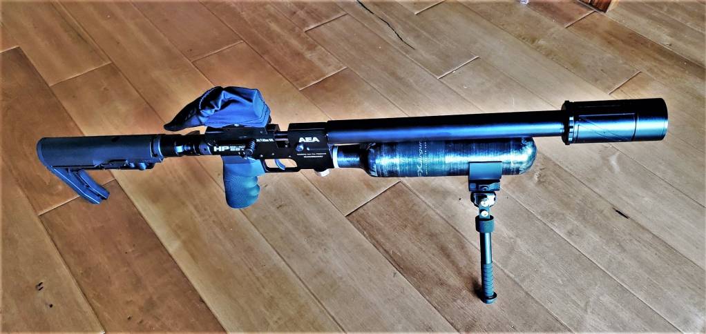

Ok, just to followup on my previous response on adding a Ronin(.30) to my new HP SS .25 PLUS. I did that today with its stock baffles in place and it cycled perfectly from approx 3200 psi down to 1900 and it was still cycling when I stopped because I ran out of pellets. Pellets were JSB exact kings. It was way quieter that I expected so really happy at this point.

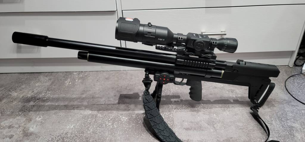

Yes, this happened to my Bullmaster a few years ago. The semi-auto blow-back system can not support moderators. The valve-less systems are the once that are not effected by a moderator. The blow-back systems uses the excess air to cycle the system after the projectile leave the barrel. The Valveless system cycles before the projectile leaves.
