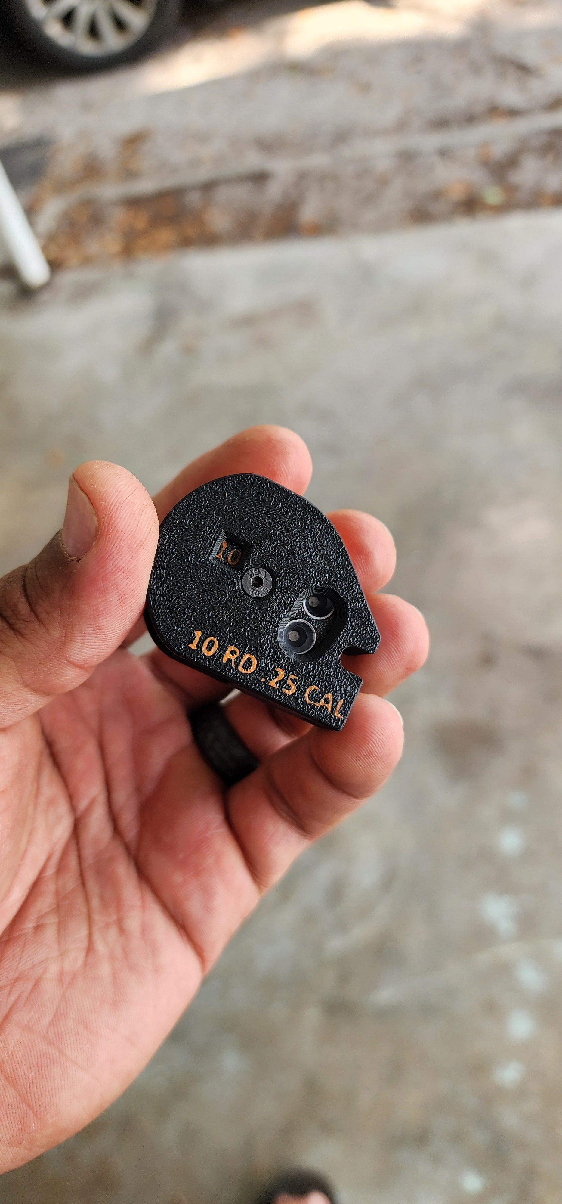

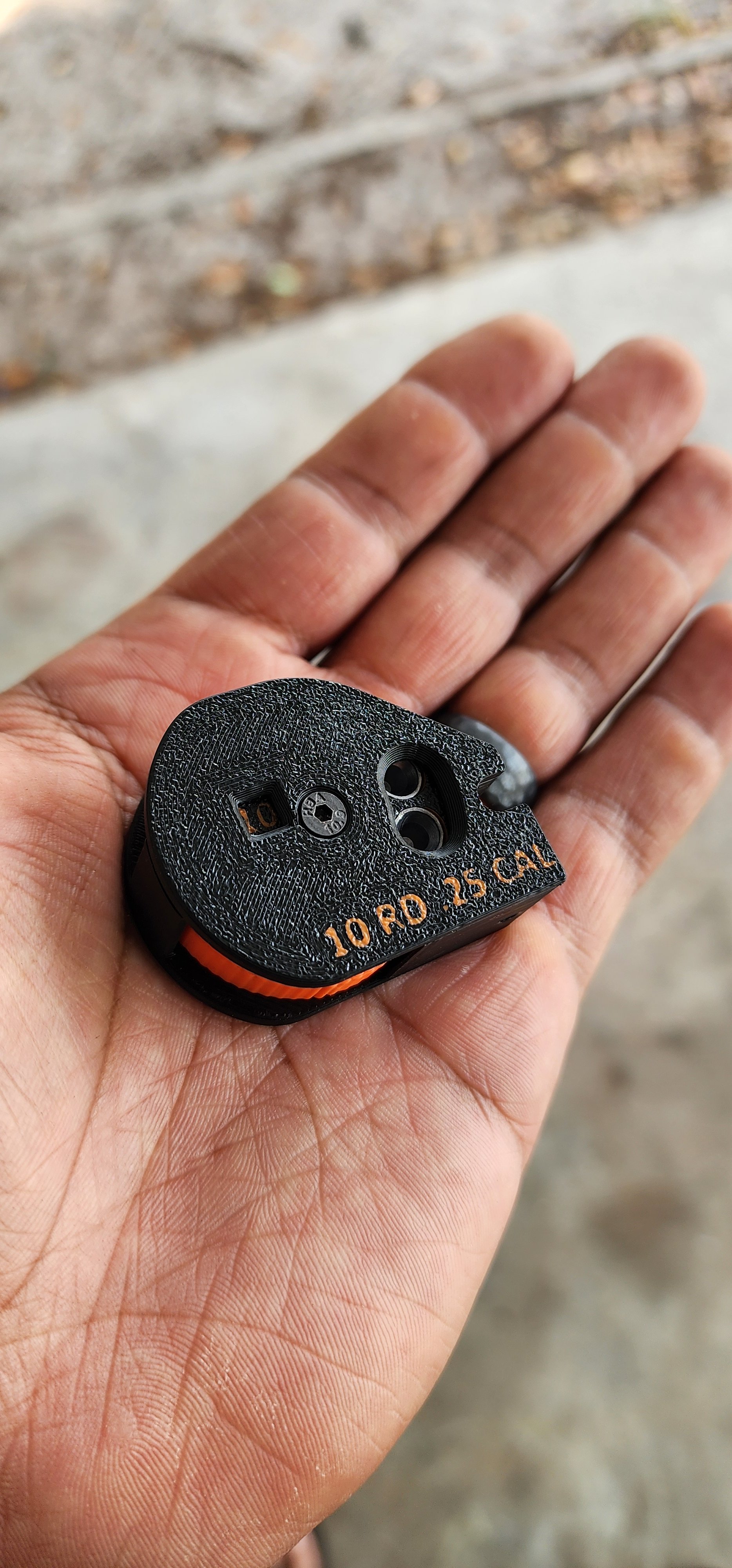

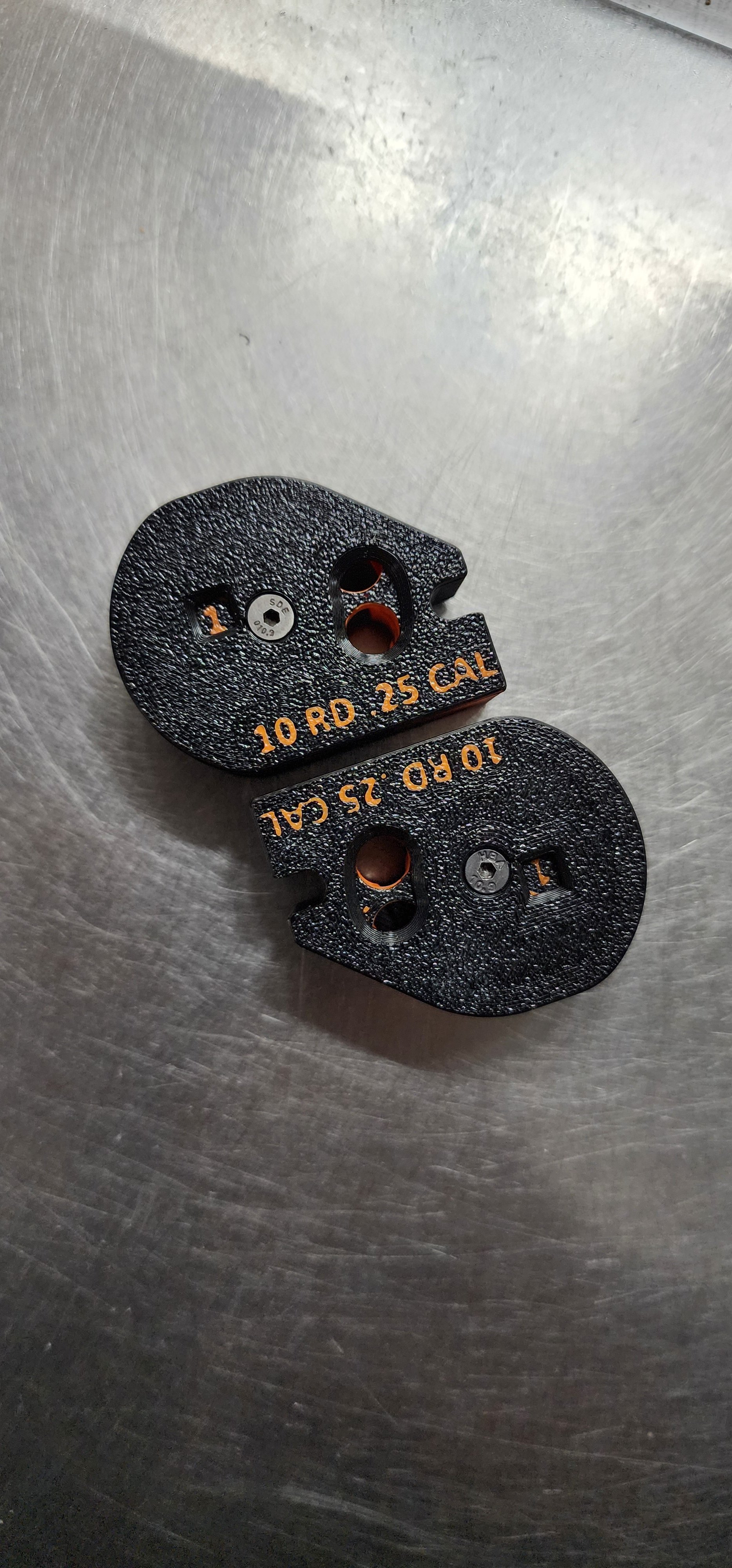

First run of AEA SF/HP .25cal mags will dropping at the beginning of next month. .22/.30cal will be released shortly after followed by extended capacity mags.

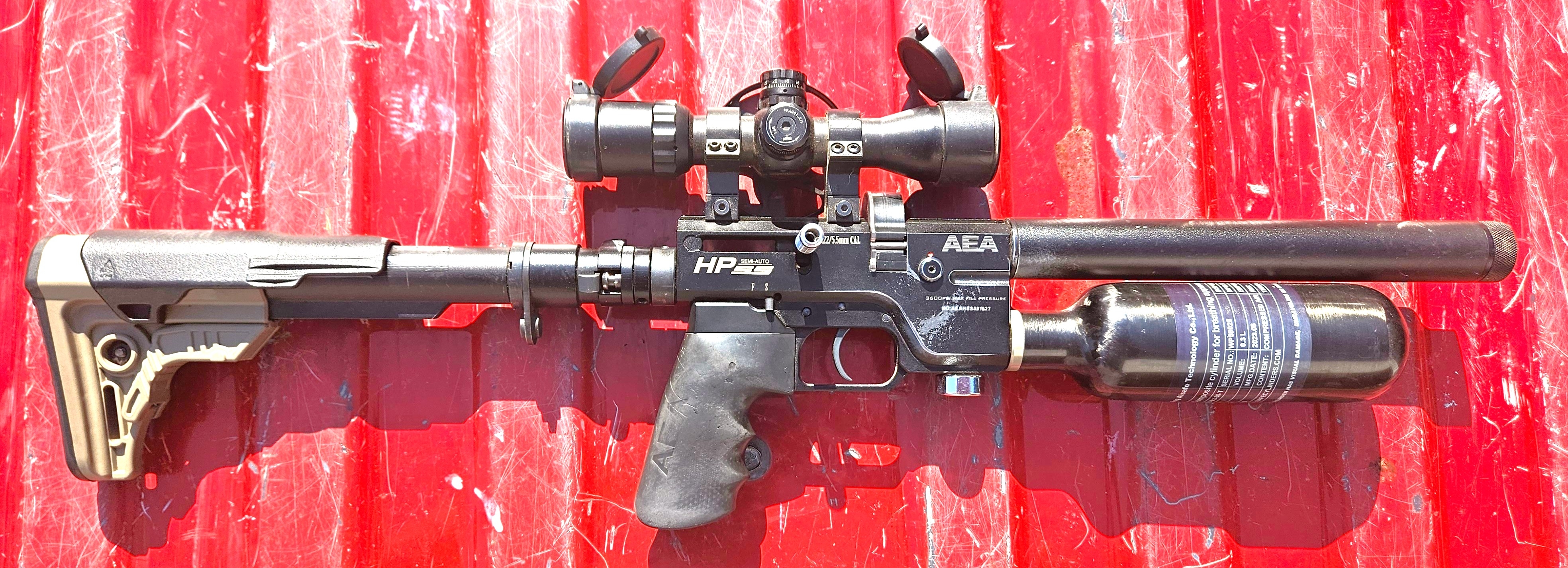

I have a 300cc bottle on mine. I use AE Swede mags and get 2 mags out of the bottle. That is 2 mags 34 shots with no POI change at 50 yds. I have been shooting this one daily on our dog walks.
Nice setup!!! Which adapter did you use to get the bottle attached? AE Swede mags are great, but they are like 50 bucks a piece if I recall correctly.
