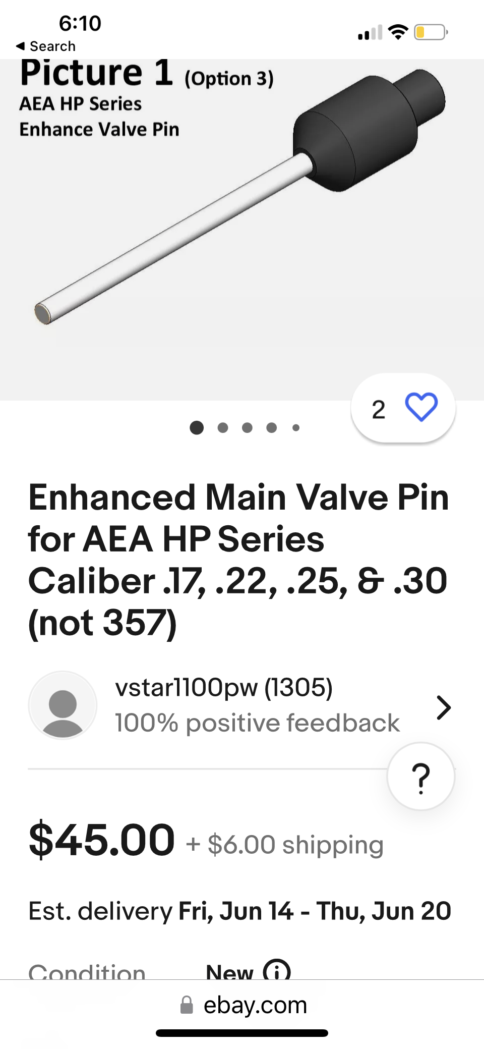

Perle Member Jun 9, 2022 1,581 1,741 South Florida Jun 9, 2024 Add bookmark #2 Jun 9, 2024 Add bookmark #2 Check eBay Stock valve pins use something inferior these are made from Peek Upvote 0

allinssd Member Apr 28, 2018 431 368 california, United States Jun 9, 2024 Add bookmark #4 Jun 9, 2024 Add bookmark #4 Perle said: View attachment 471283Check eBay Stock valve pins use something inferior these are made from Peek Click to expand... Does anyone make beefier ones for .45 cal and above? Or do those not have issues? Upvote 0

MWS Member May 22, 2023 52 41 Anchorage, Alaska Jun 9, 2024 Add bookmark #5 Jun 9, 2024 Add bookmark #5 They break in the middle where the metal pin ends. That tells me that the metal pin should extend all the way to the back. Easy fix for the company that makes them. Upvote 0
