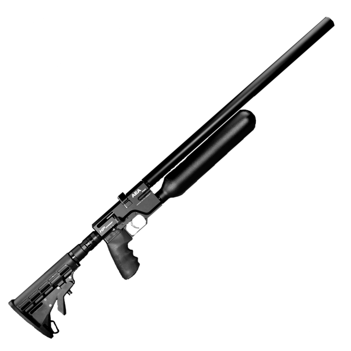

AEA Varmint hissing sound when bolt pulled back
No, you can try to fire it a few times to see if it helps seat it or see if there is any improvement, but its possible the poppet is cracked.
The gun is pissing air bad now I shot it a few times, Air started leaking out of the end of the barrel what is going on with this Varmint, I cleaned the barrel thats all I done so far.
Came with a defective poppet, the aea's are pretty known to have poppets fail but not so sure with out of the box. Definitely going to need repair.

It's the poppet. Remove it, see if its broken, clean the poppet and seat, air it up while cocked and try again.
