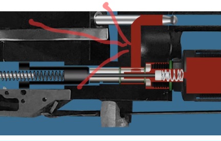

The probe spears the pellet and pulls it back into the void where the hammer/valve sit.
So the lodged pellet would be here (red arrow)? This isn't the AEA gun just a stock photo I found.

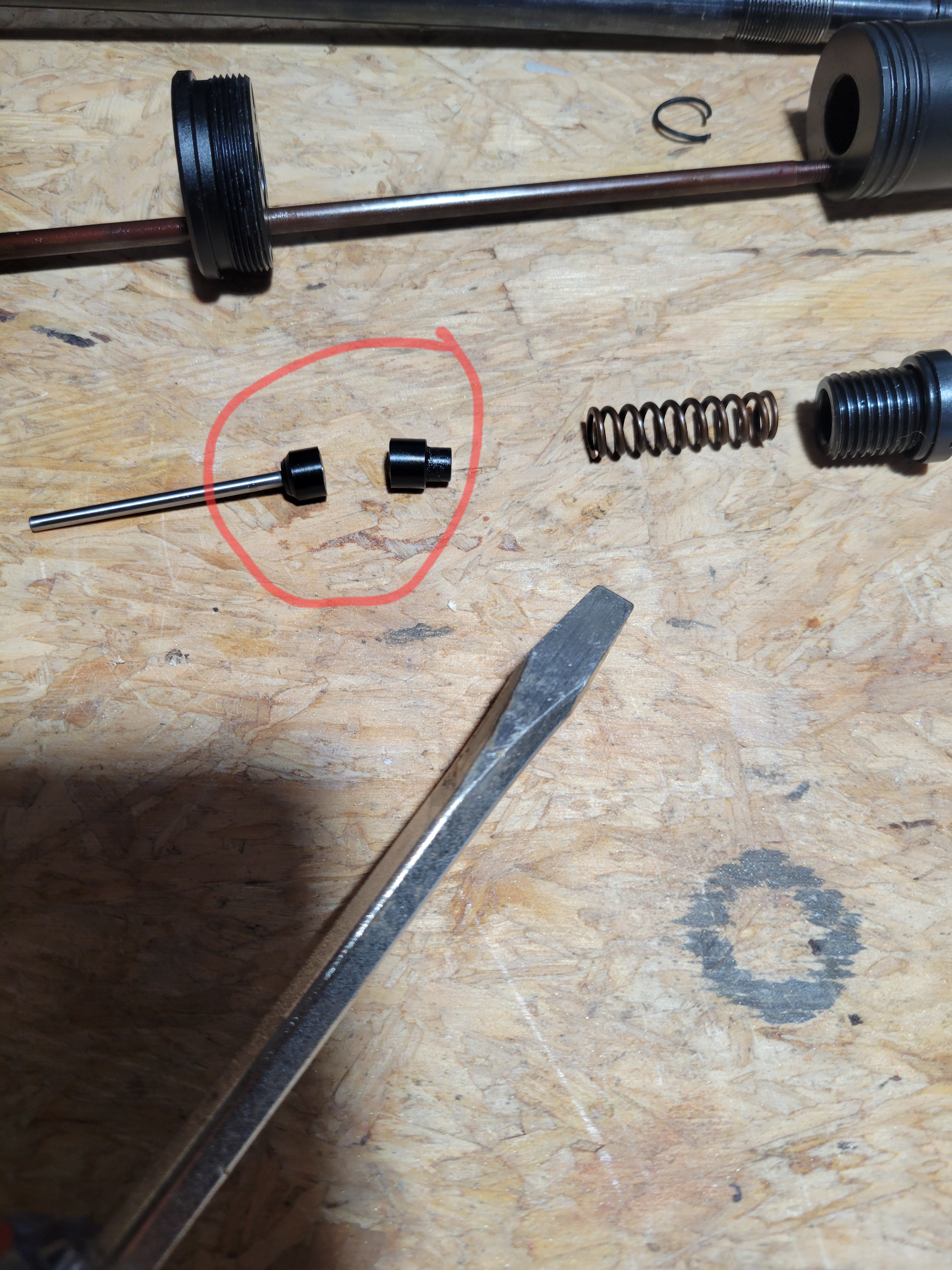

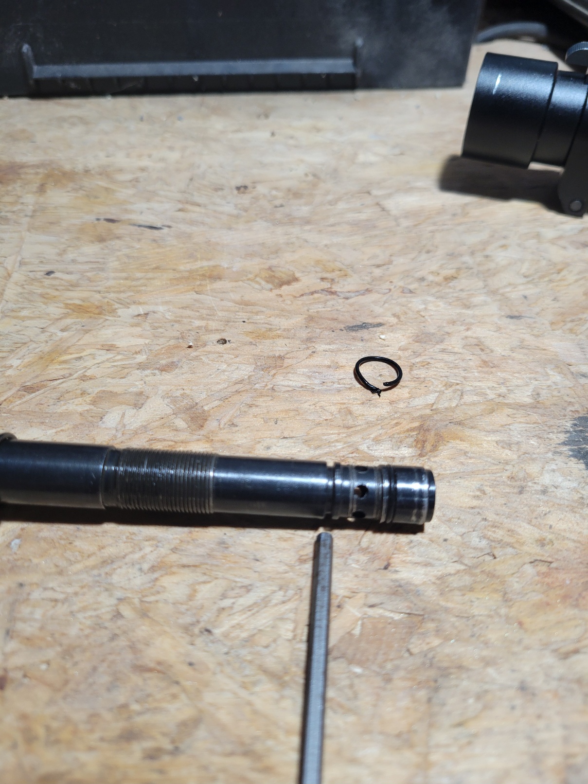

Today I took off the barrel, air tank, what I think is called valve pin (large flat head between tank and barrel, and hammer and spring. I inspected and could not find a pellet lodged anywhere. I put lithium grease on all the threads and reassembled. Filled to 2200psi and it held air. Cocked it and dry fired with no magazine in. This time air came out the barrel, but made a huge fart sound and degassed. I fill up to 1000psi, cocked dry fired and air came out the barrel. Filled again and when it hit 2200psi and air shot out the barrel during filling. I'm guessing an o ring or somthing.

The issues you describe sound like a problem with the valve pin. I'm guessing it sheared into two pieces and you will need to replace it, based on my experience with the HP guns
Thanks Mr P. The valve pin looked to be in good shape. I will take it out later and get a Pic of it. So far the only thing that looks out of the norm is that one O Ring I pictured. Went to Harbor freight and Ace but can't find one that size. Guess I will reach out to The Pellet Shop or Fox to see if they can send a couple or at least tell me the size.

You were right it was the valve pin. I'll order one tomorrow and ask them about the top secret O ring sizes. This has gotten me a bit more familiar with how these pcps work.
