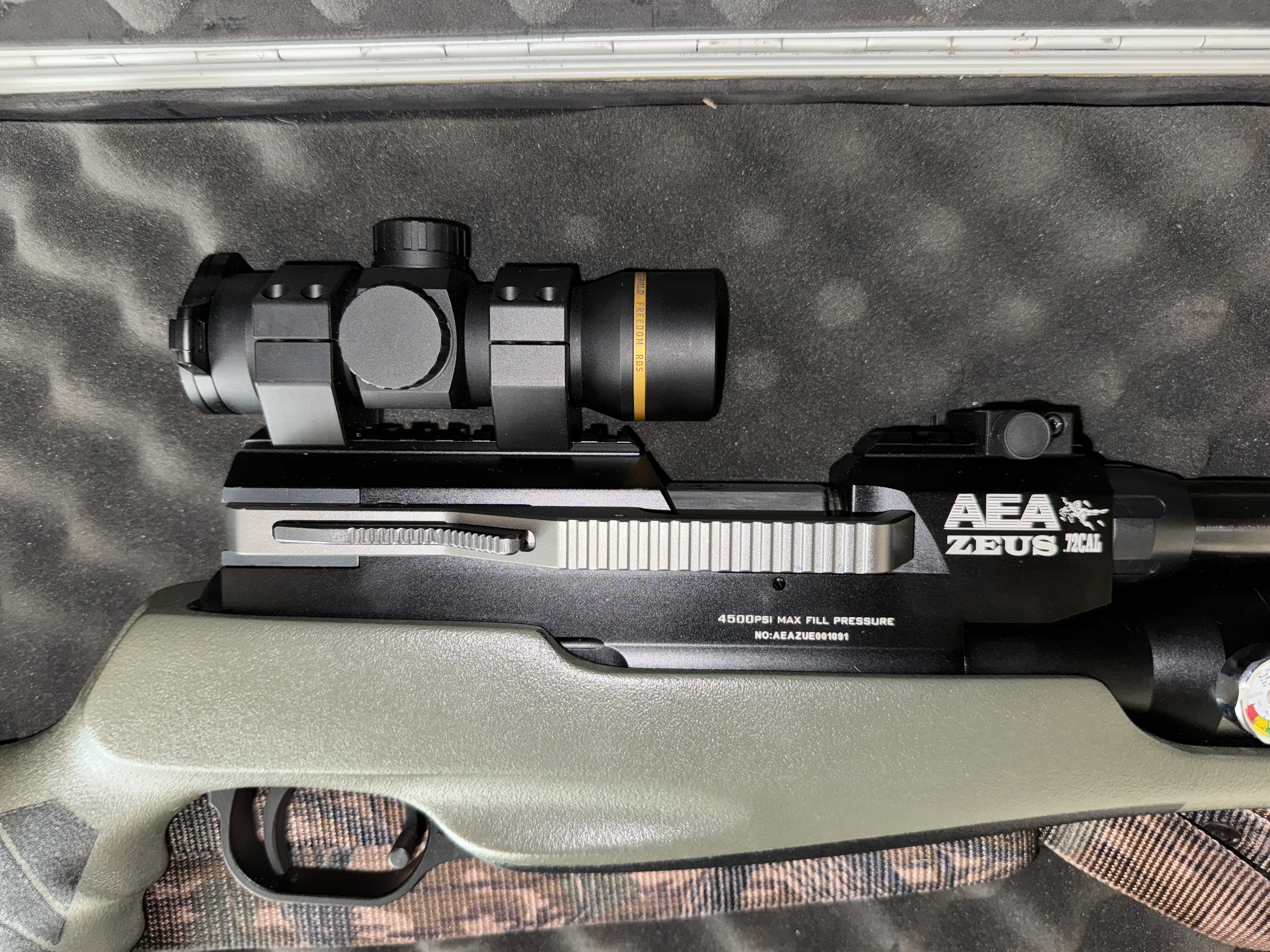

I have a Zeus 72 that I need to put glass on. I’m torn because I would like something I can use for white tail and also my plans are to get the shotgun barrel for it so I would like something that could be used for both shot gun range and out to about 75yarda for deer. Anyone have an optic that fills both roles or am I better off setting it up each time I switch barrel with that specific optic?

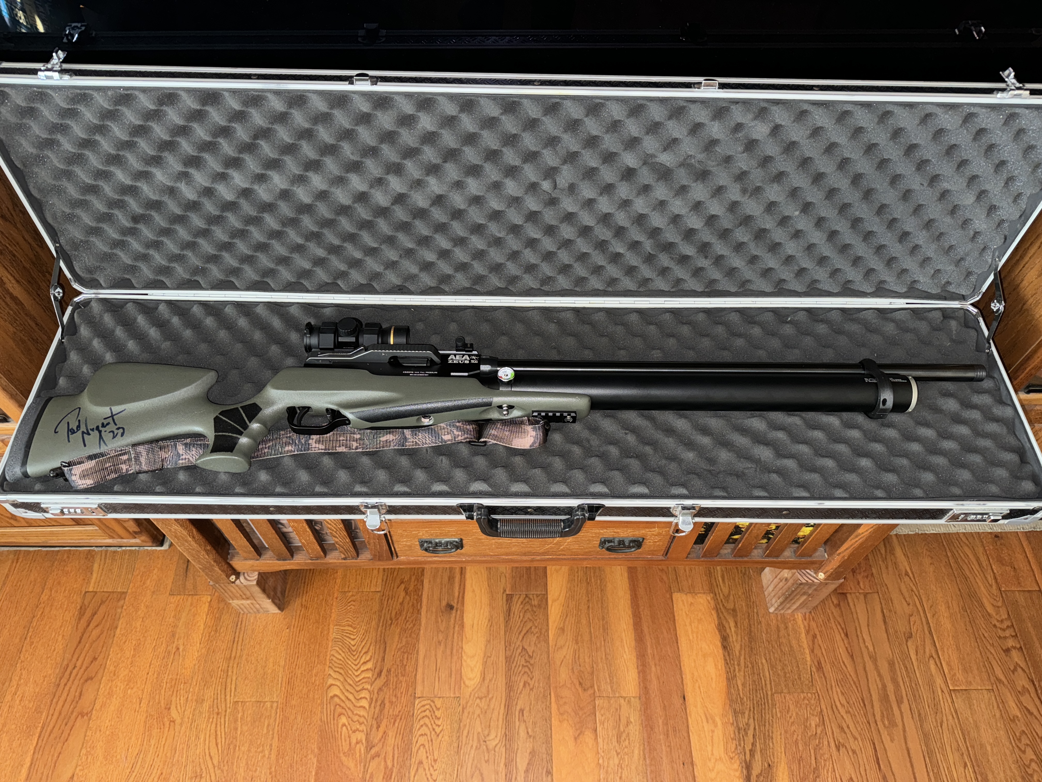

Side note this is the 72 Zeus I got off of you. Finally getting around to setting it up

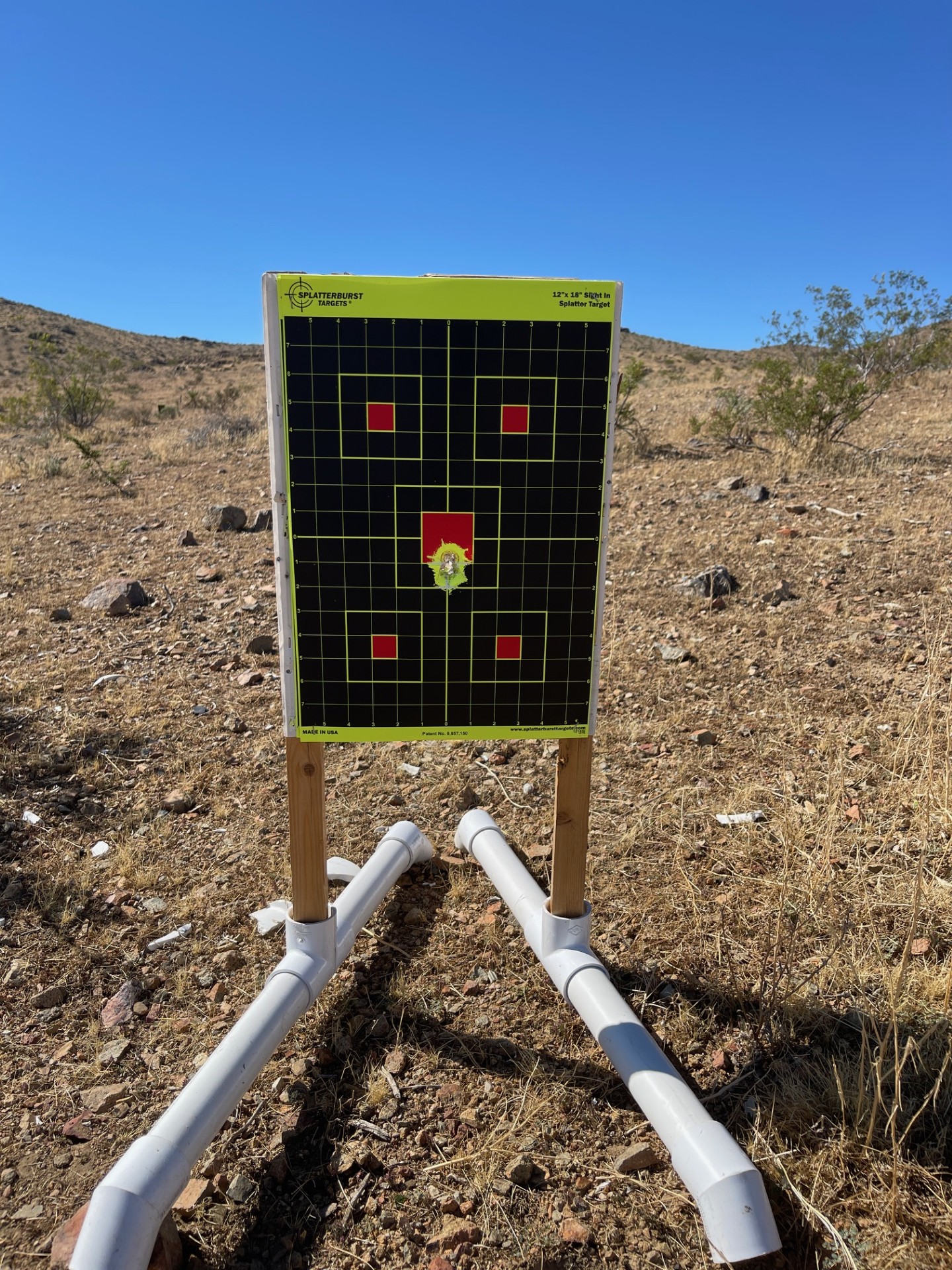

Just go with a good red-dot sight, like the Leopold Freedom RDS or equivalent. There is no need for magnification to get a good clean hit on white tail at distances under 100, and the red dot is plenty bright for shotgun use. It's more important to get that beast of a rifle properly tuned... so every slug goes through the same hole! The AEA Zeus 72 cal can be a troublesome rifle to tune, after testing hundreds of slugs, my best results were uncovered using MR. HP 525gr of pure awesome at 3,650PSI. With a barrel band, and this combination, the rifle will shoot 3-shot single hole groups at ranges out to 75 yards, holes touching at 100. Note: With a 50yard zero, the drop at 100 is a little over 8", your results will vary depending on pressures and barrel length.

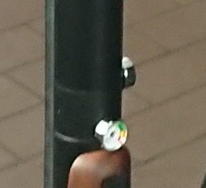

i am not talking about the fill pressure of 310 bar that the bottle can be filled to..
i was asking about the maximum regulator pressure- and my zeus comes with internal regulator from factory..
here- 2 manometers, one is reg pressure, internal
