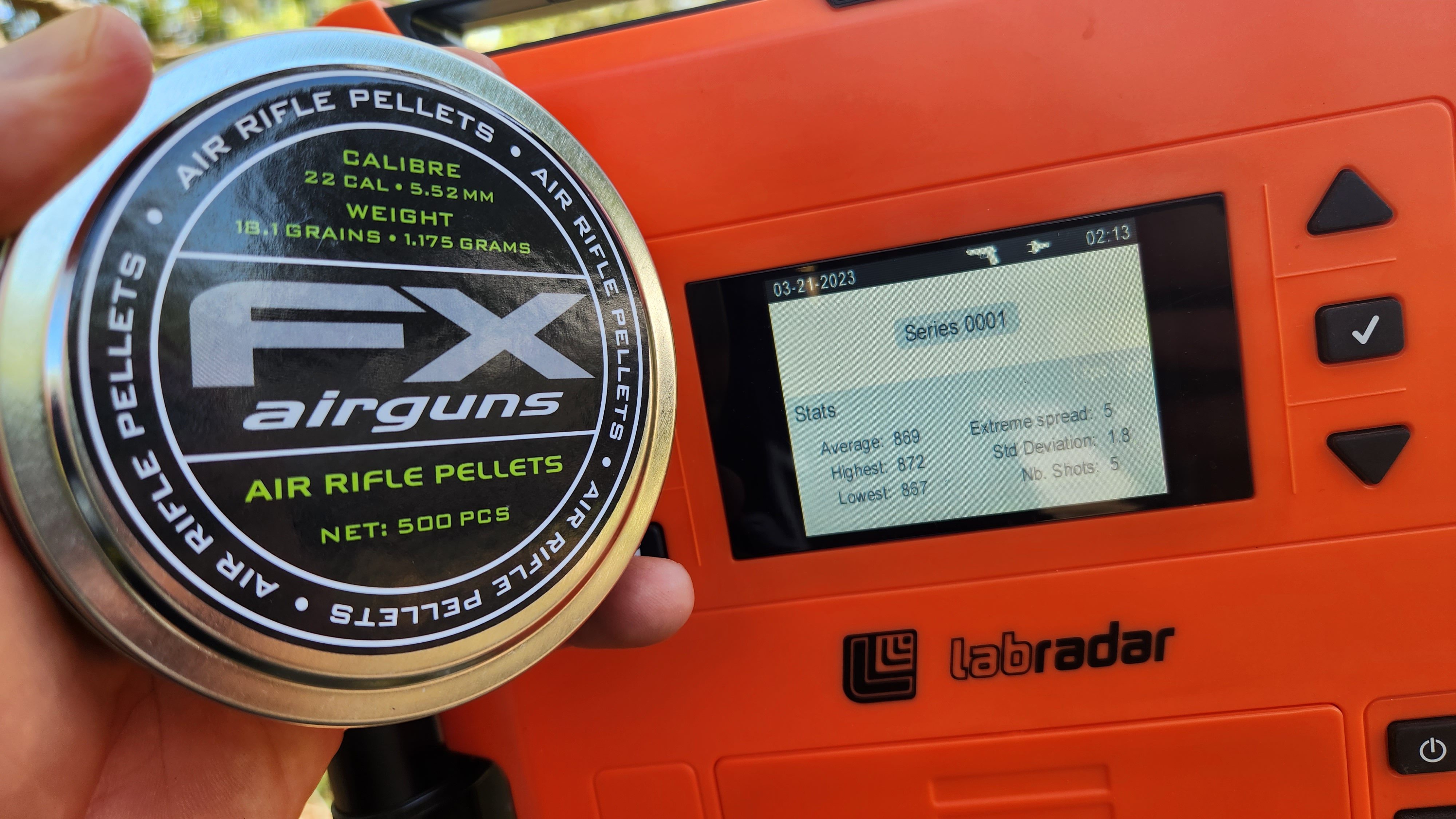

I even tested mine this morning as I promised I would. Very first shot after a several days without use was 865... right where I would have expected it to be at 65* outside. ES was tracking right at 5 too, as I sighted in at 50 yds and seasoned my barrel for filming today.

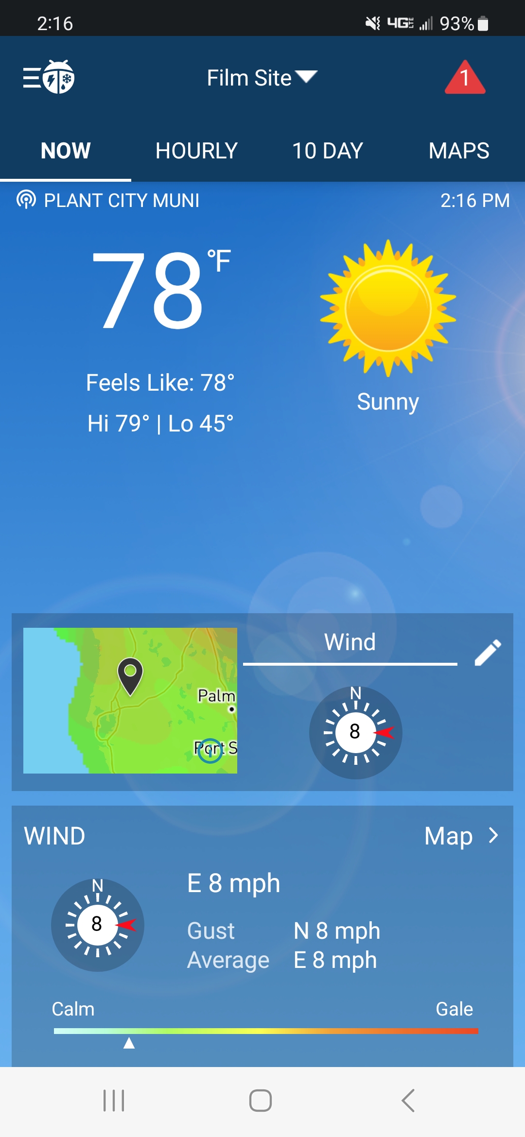

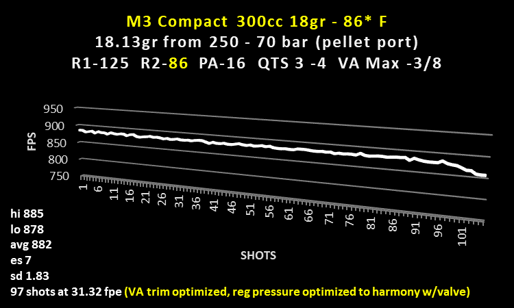

18gr Diabolo
The tune tested out well at 50 yards. The 8 mph wind wasn't helping things, but it didn't seem to hurt either... and that may be the whole story. The 18gr flew stable from 865 to 880 no problem, outta the 500mm STX Superior 1:24. Interesting to note - it took about 50 shots for it to season post clean. Before then, I saw some light random corkscrew.
I created the tune at 86* and tested it out at 78*. It worked great.
Here's the tune again.

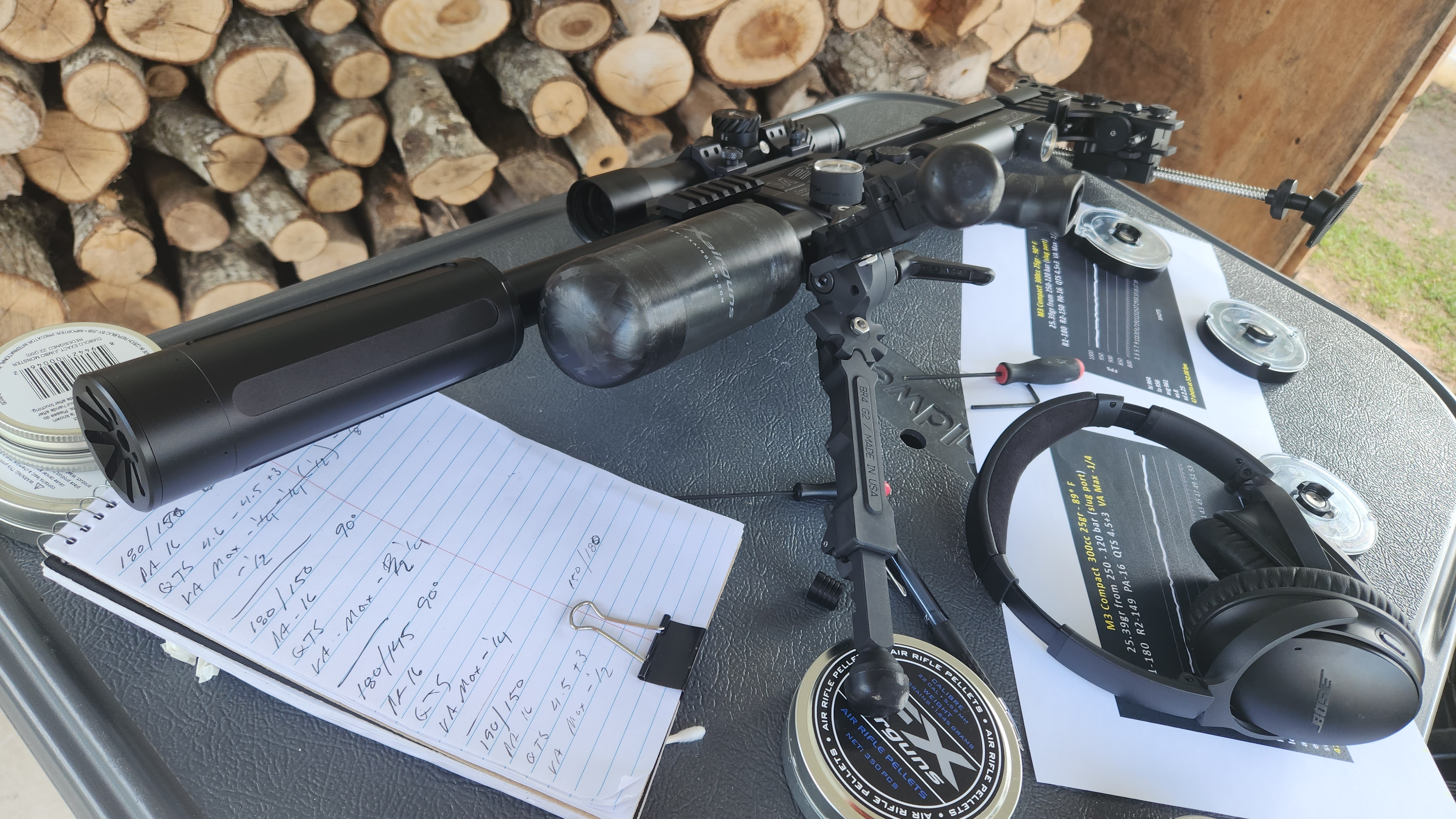

Next Up - the 25.39gr Redesign (Psst - that tune is done and will be up on my Instagram in a few minutes) "hookedonair" :)

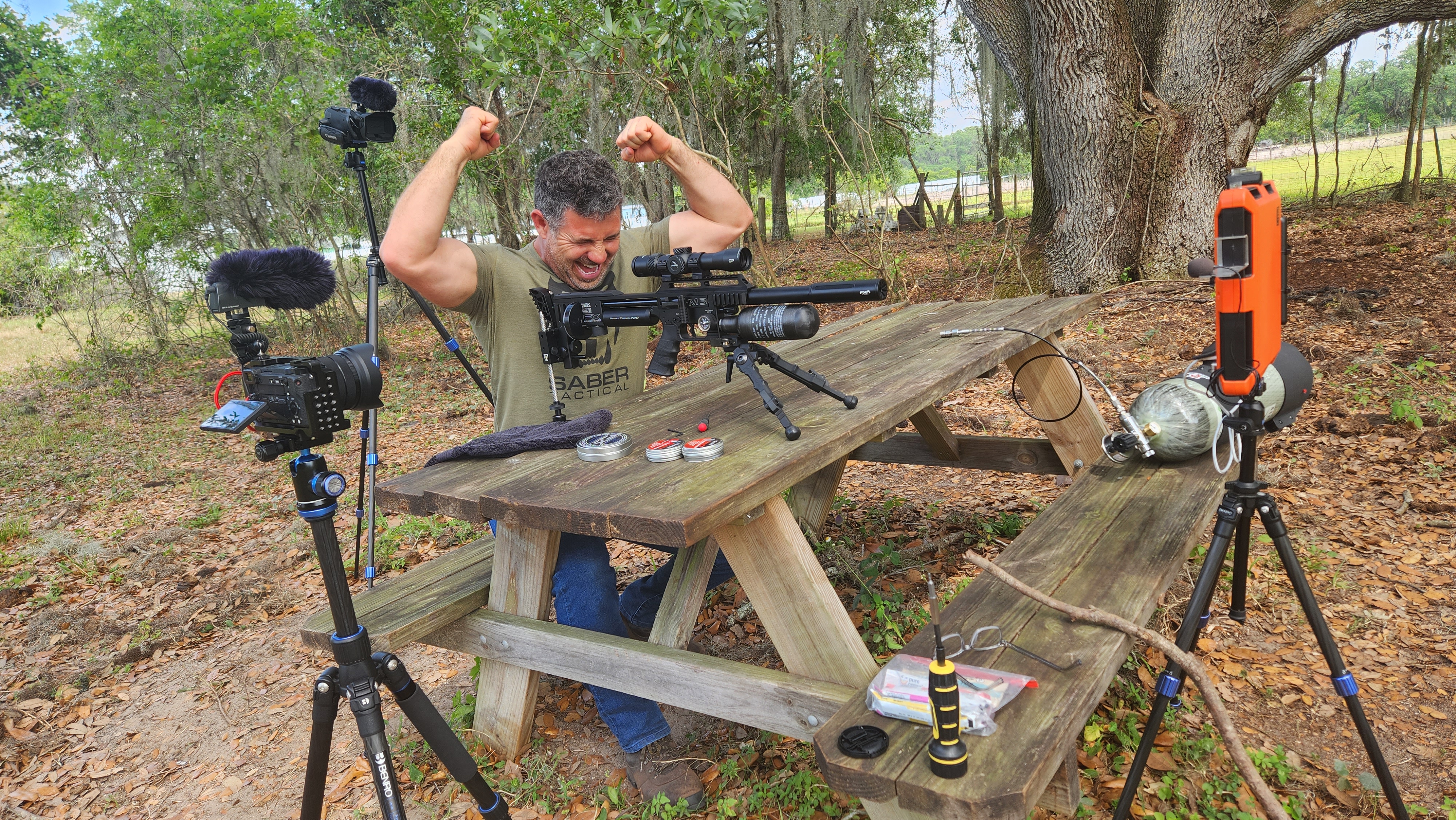

Here's some pics from the day.

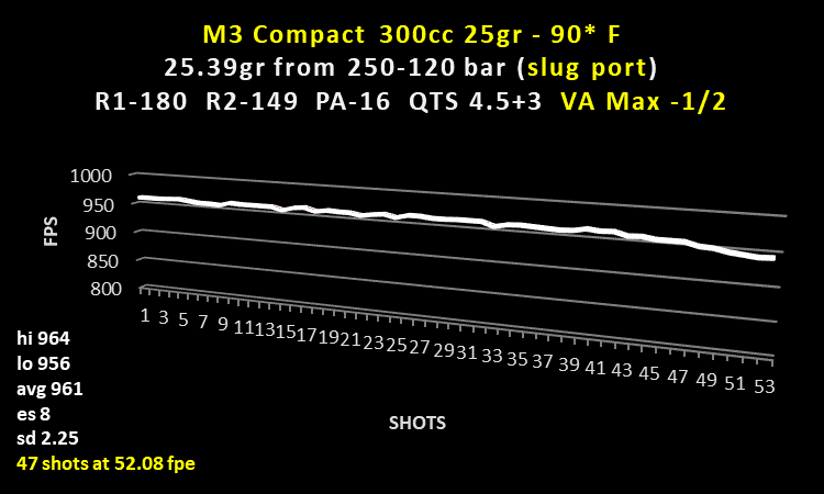

Update - 25.39gr Redesign
Out of the 500mm M3 Compact, the JSB Redesign wanted 960 fps, no less... and I really fought that for a lotta weeks. Why? The 300cc bottle. That little bottle and the smallness of this gun are what make it great, so to preserve their combined merit, I squeezed relentlessly on speed versus consumption.
I started with the included 1:24 and worked through every velocity from 850 to 960 and in every imaginable tune & trim. The best spots along the way were 850 fps and 915 fps. At those speeds, 50 yard groups were less than dime-sized, however random pellet hook & wobble were fierce. No matter the tune, and no matter the velocity, the 25gr Redesign kicked & screamed all the way to the target... and any wind (which I had lots of) seriously aggravated things. This pellet was unreliably wobbling itself into good groups. Not ideal.
Giving up on the 1:24 (which had been so excellent for the 16 & 18gr) I ordered the 1:16 "Superior Heavy" liner or "slug liner" as some call it. Again, I put in the big hours ruthlessly tuning & testing my way from 850 to 960, and at 950 fps something amazing happened. The hook & wobble nearly disappeared. I pushed to 960, and it vanished completely. I spent the next few minutes ringing the 150 yard gong and observing flight to confirm. It was smooth sailing all the way. I was more than very happy, lol.

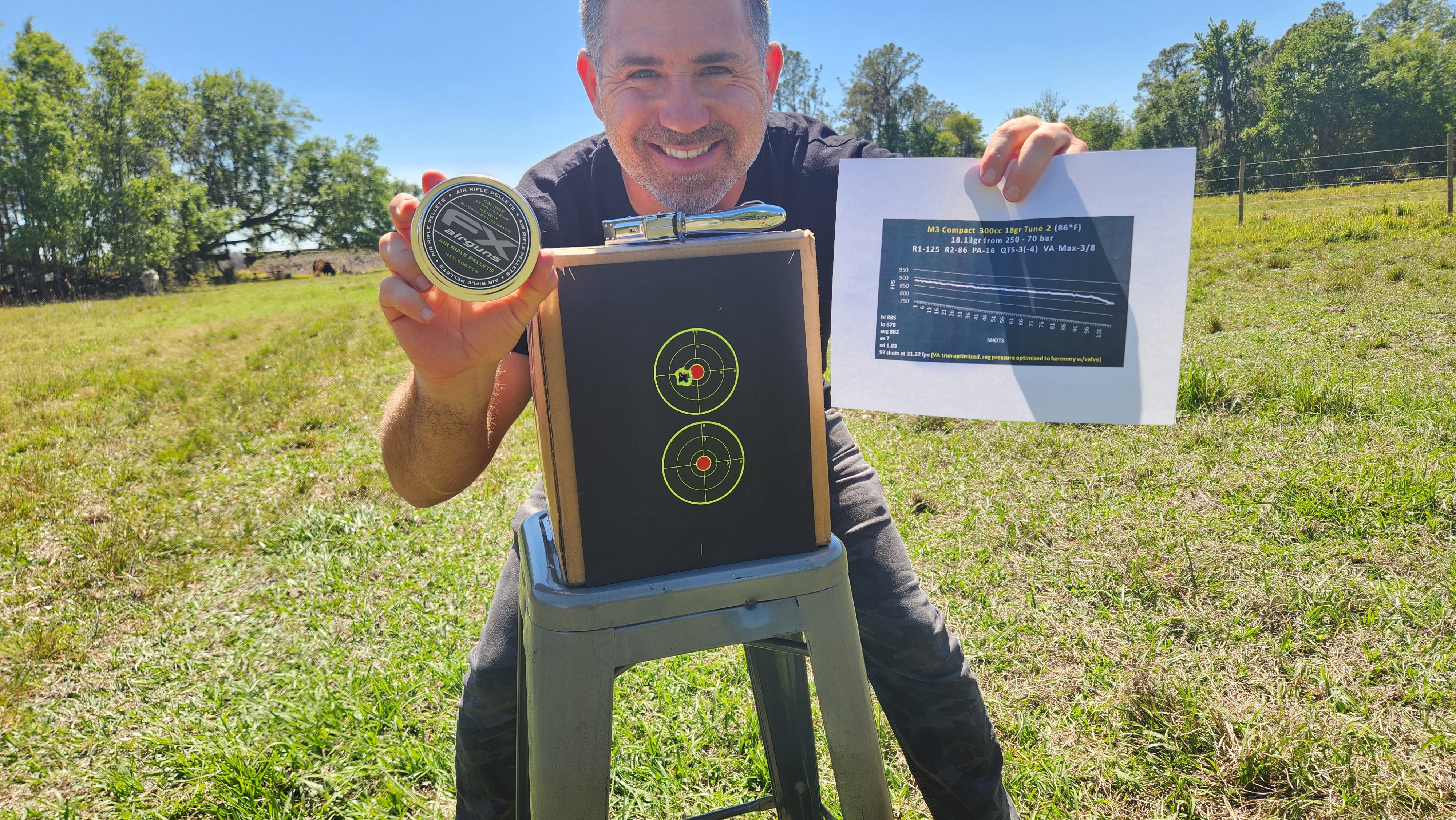

I QTS-ed a quick tune, busted out the cameras, filmed my 50 yd group (of which they all fell wobble-free into the same hole), then went home to build a solid tune around 960. Below is that tune. Two of them actually, made back-to-back days. :)
47 shots at 52 fpe in the flat
47 shots at 52 fpe in the flat - ran it again the next day trying to find some more shots with the VA

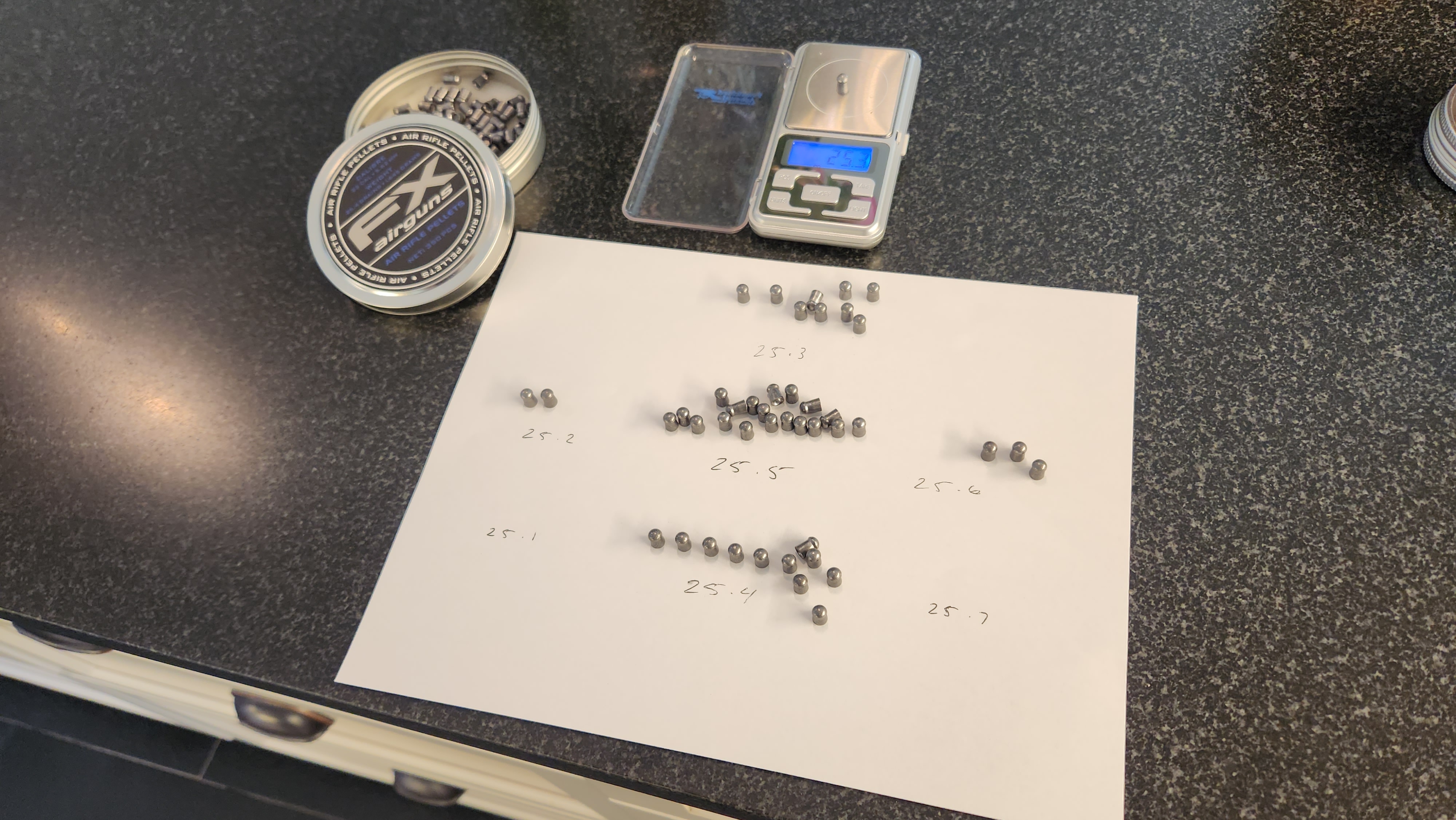

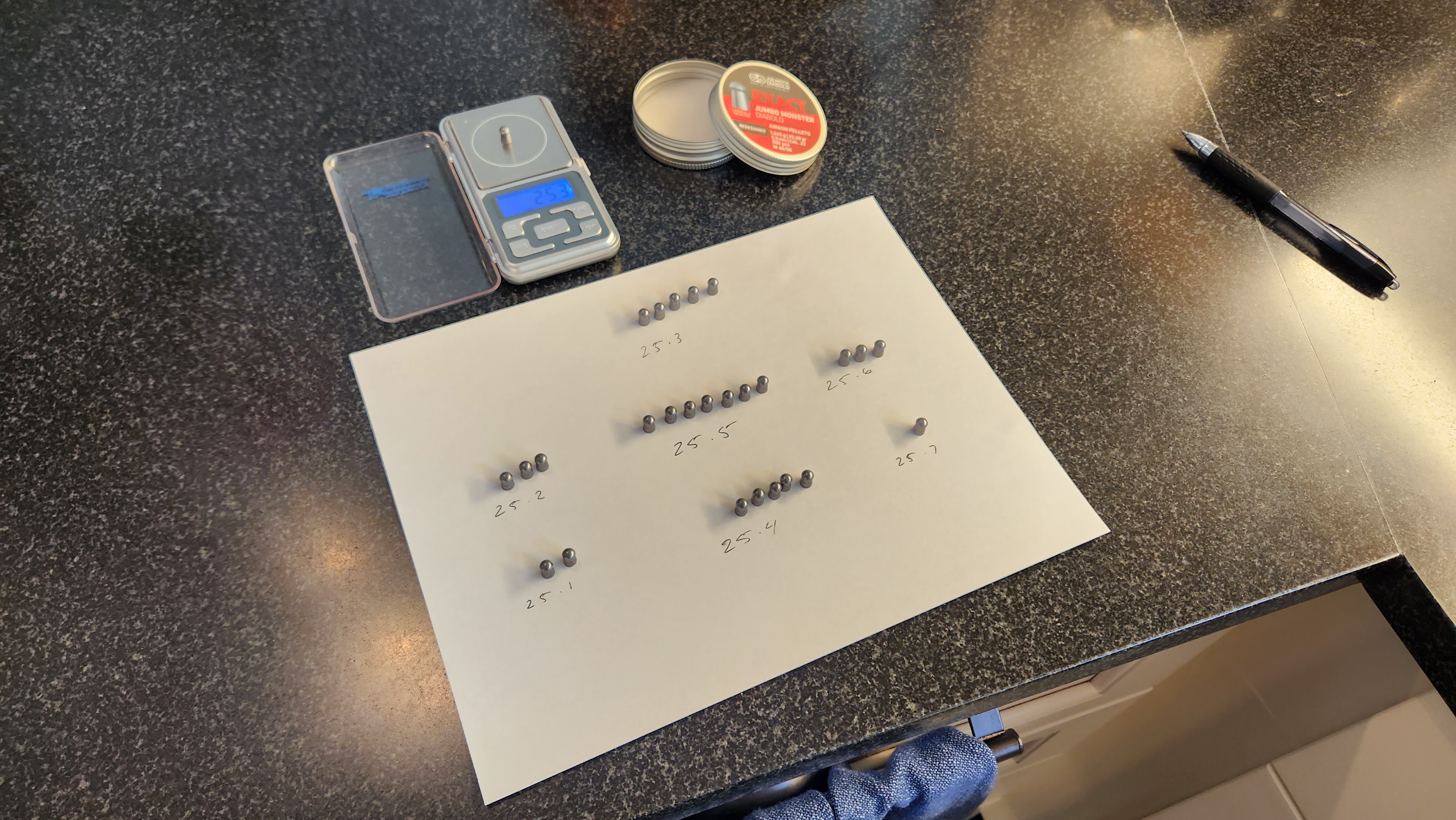

Yesterday, after building out these two tunes, I got curious about their random dips & pops. I suspected my pellets so got out the scale. The below is what I discovered. Not sure what it means (if anything) but it's what I got, so thought I'd share. I'm left wondering if the 8 fps ES's this M3 is generating could be pushed to just 5 with some pellet sorting 🤔

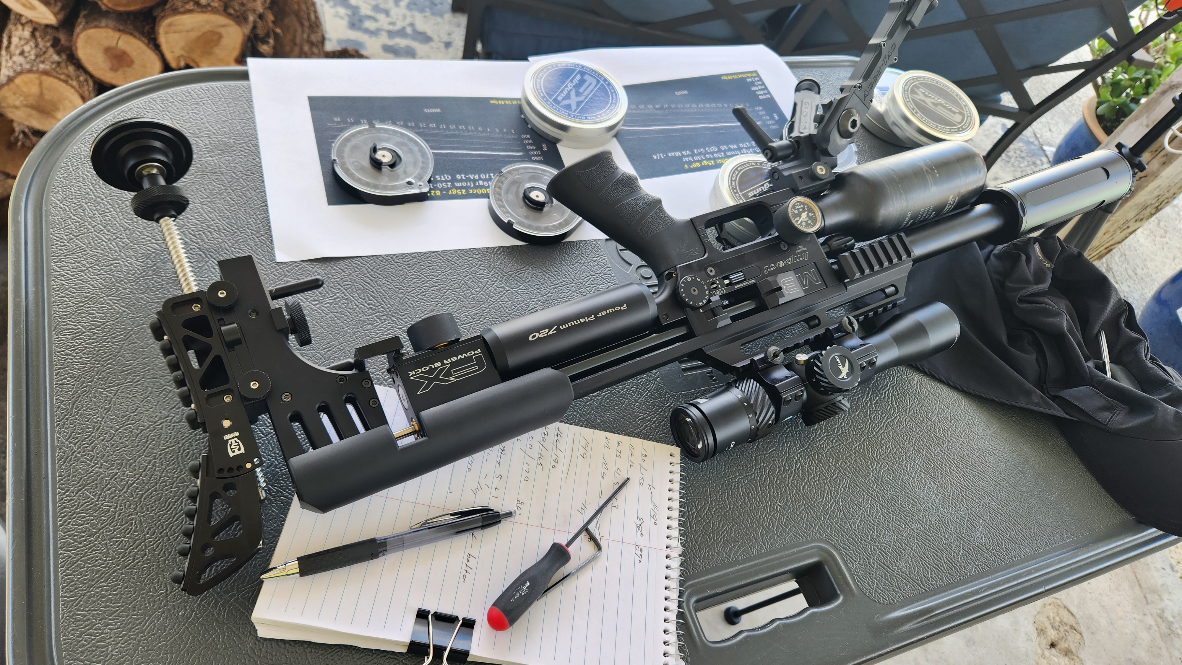

I actually tested for this on Saturday when I did some scope came filming to test my 26gr's tune-stability in a 7-9 wind (at 120 yards) :)
Here's what I got;

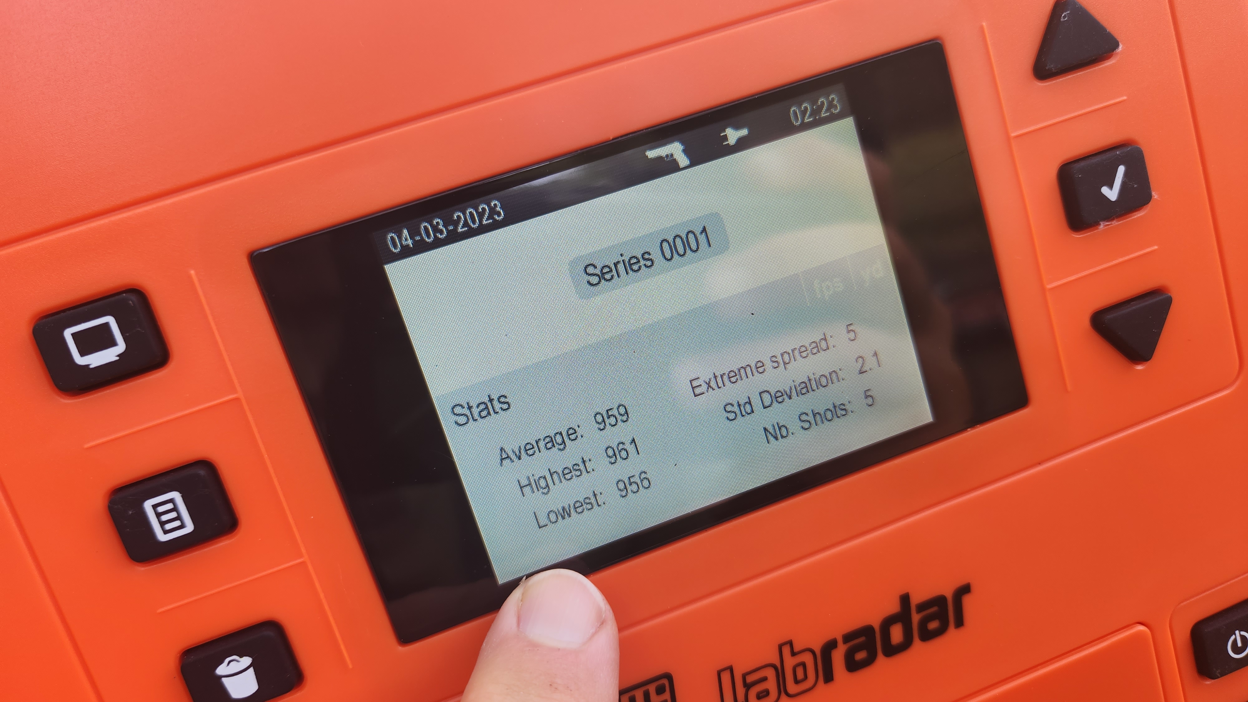

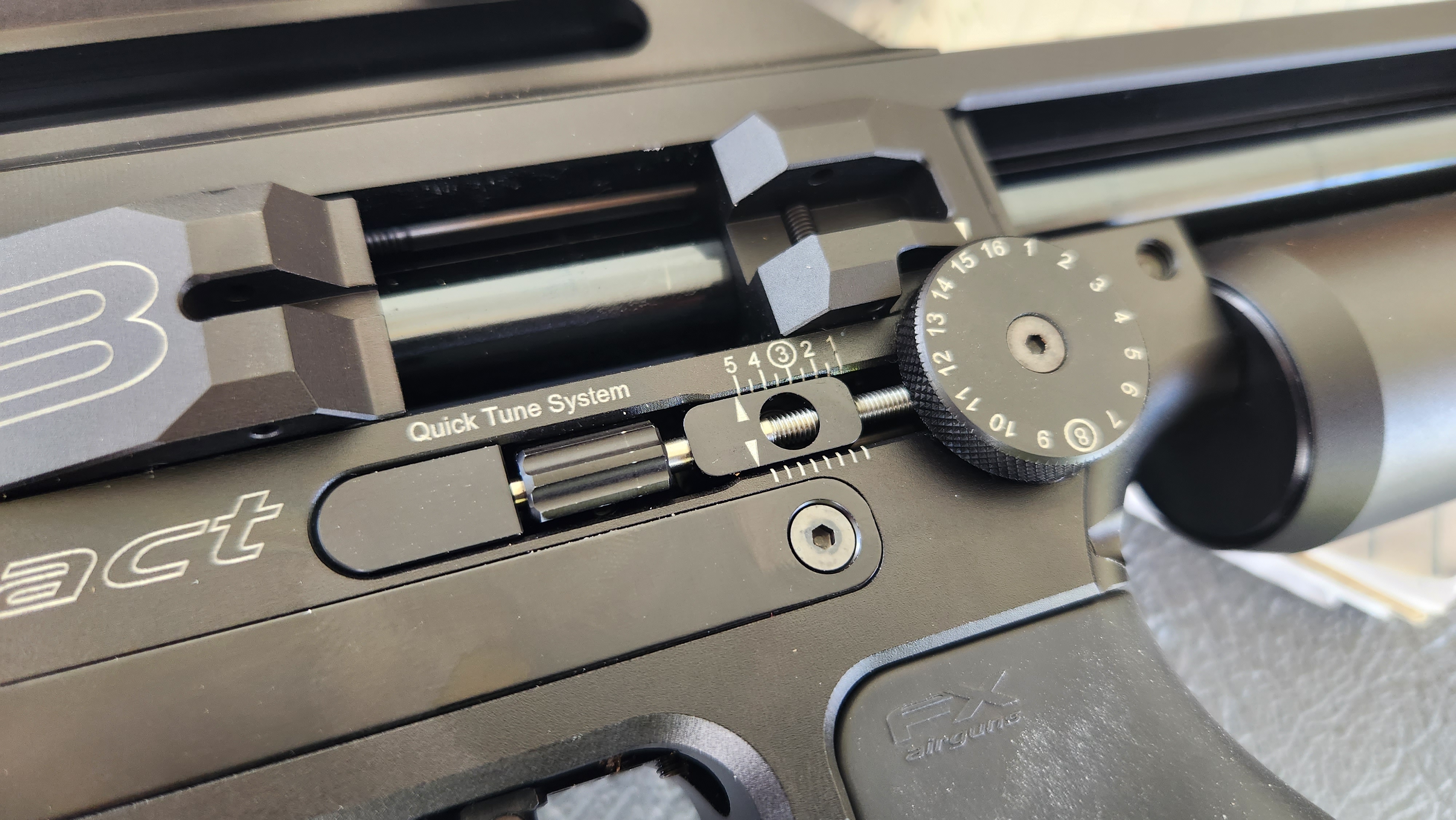

Shot #1 and #2 were 940 fps in a 78* ambient. I had tuned to 960 at 90* ambient. When I tuned at 90*, the gun and ammo were also at 90*. When I took my first 2 shots Saturday, the gun and pellets were at 75* from being in my AC'd garage overnight. This all seems normal to me.
Getting back on 960 at 78* and a cold gun was super easy. I bumped R2 1 bar and advanced the QTS 2 positions. It jumped right to 960 and stayed there for me for the rest of the morning.
Hope that helps,
Steve
Here's some pics from Saturday;

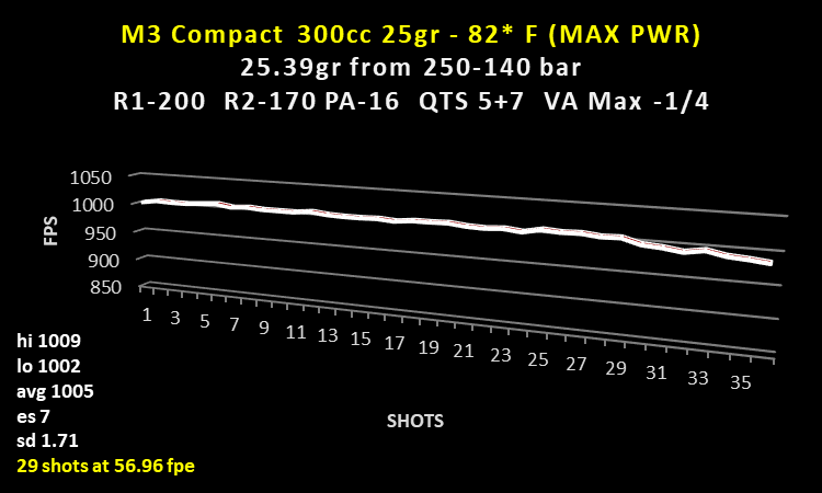

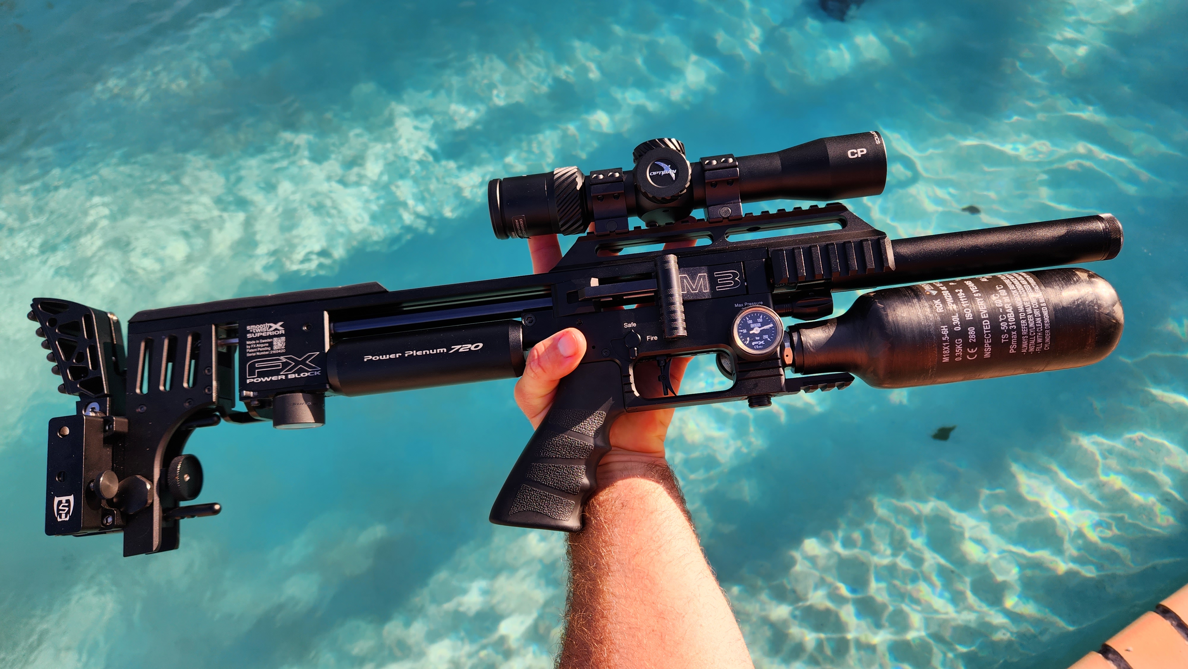

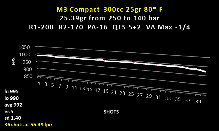

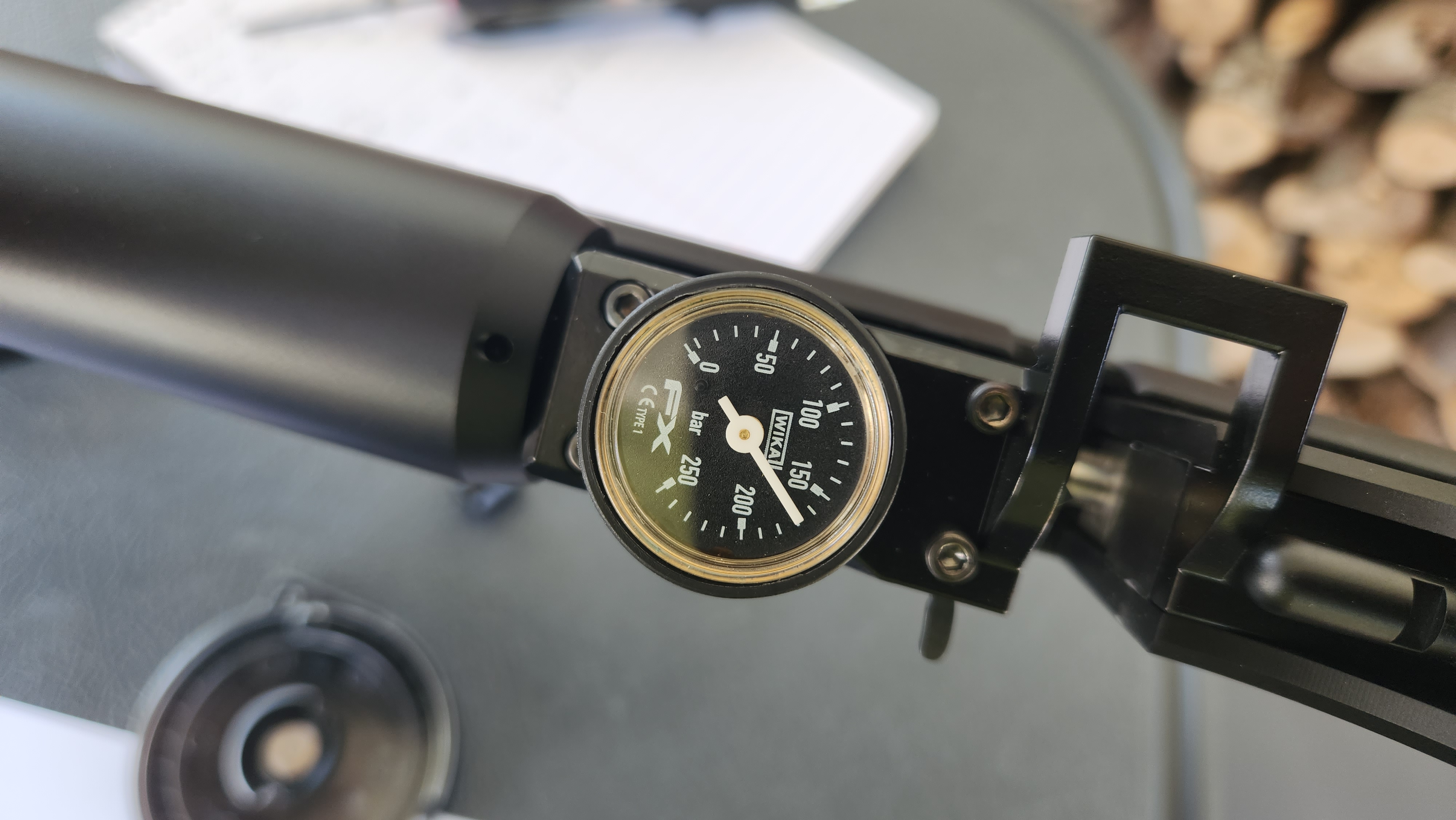

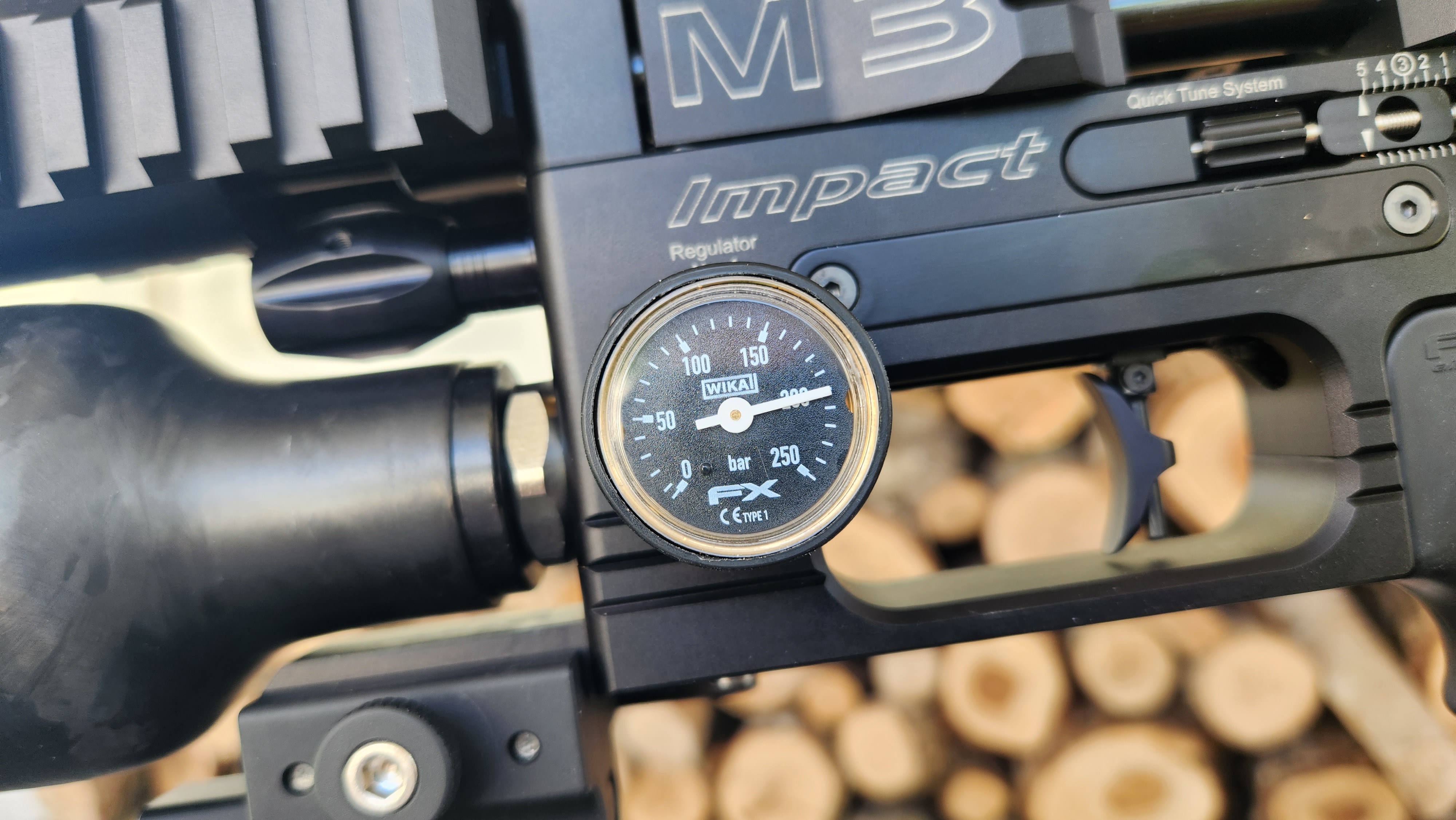

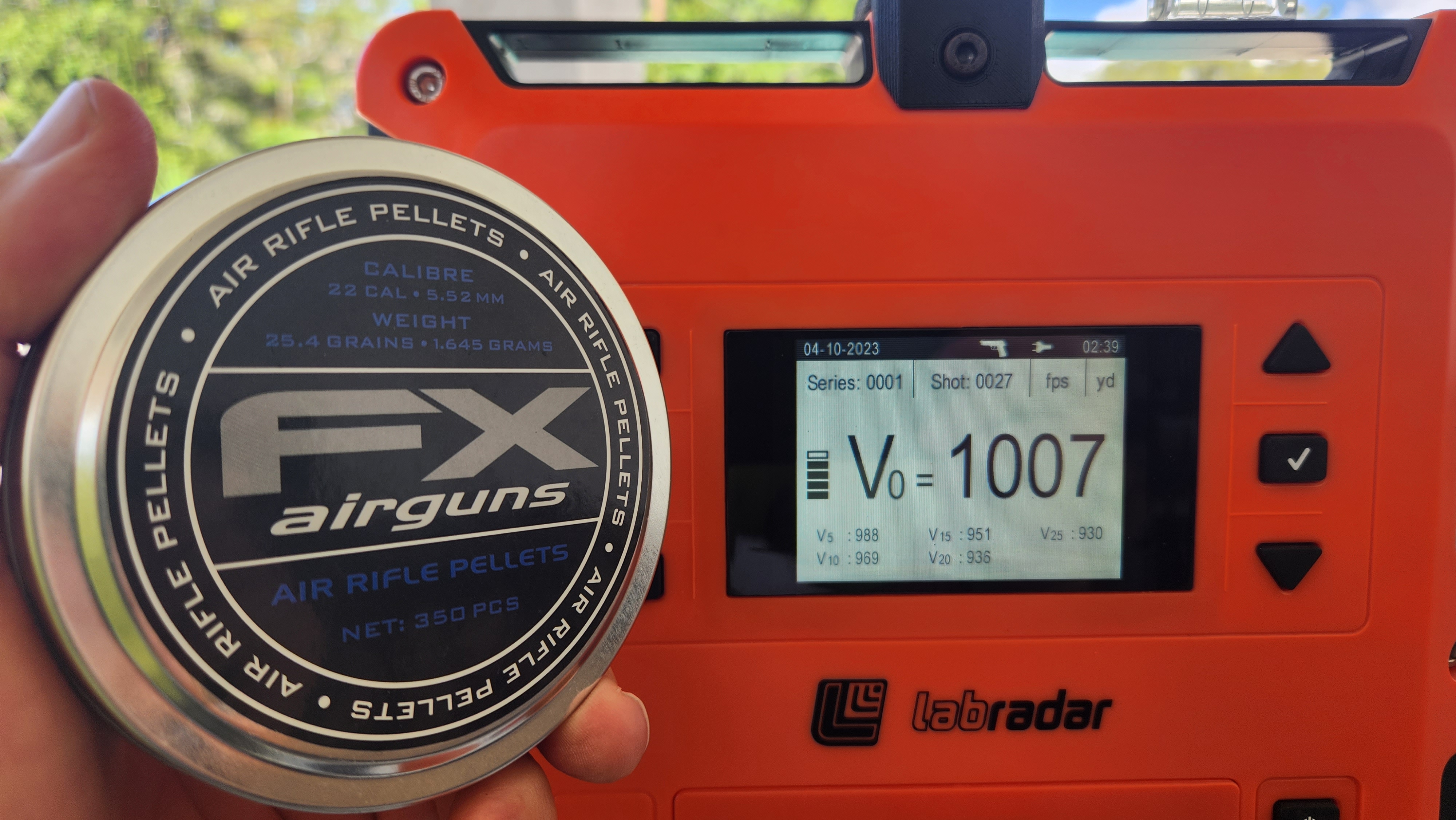

Update - MAX Power, FX Impact M3 Compact .22
Yesterday, I pushed the M3 Compact's reg 2 as hard as it'll safely go (according to FX). I did see more speed (1017) when R2 was at 171 bar for a sec, hehe) :)
I built out 2 shot charts, one for MAX Power, and the other as a refined version of the first (more shots and tighter consistency). FPE realized out of the .22/500mm was 57 fpe with a 25gr pellet. A 25gr slug may go even faster.
My current thinking is that these tunes could be useful if one wanted to push heavy slugs far & fast. If one wanted to shoot the lighter Hybrid, more shots might be realized.
Below are the 2 tunes and some pics of the day. It's not likely that I'll get out to field test them w/slugs before I leave for NAC. Winds here in Tampa this week are 15-25 gusting to 30 mph with lots of rain forecast. But I'll look for gaps in the weather to try.
