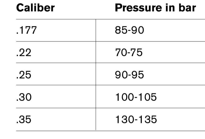

Right out of the gate, I ran a baseline chart for the M3 Compact (300cc bottle & 500mm liner) to see how Sweden had set it up. The takeaways for me are that Sweden likes a 90 bar reg for good all-around power & efficiency with an 18gr out of this configuration. That's important to note as we go forward and explore the lower limits of the aft reg on the M3, and lighter ammo. From the below, it's also clear that they like the gun set up with the Power Adjuster (PA) on 16, presumably because this is what the majority of their customers want. Personally, I've always sought to tune the FX's to more of a "middle point" on the wheel. Below is my M3's baseline run as it came out of the box.

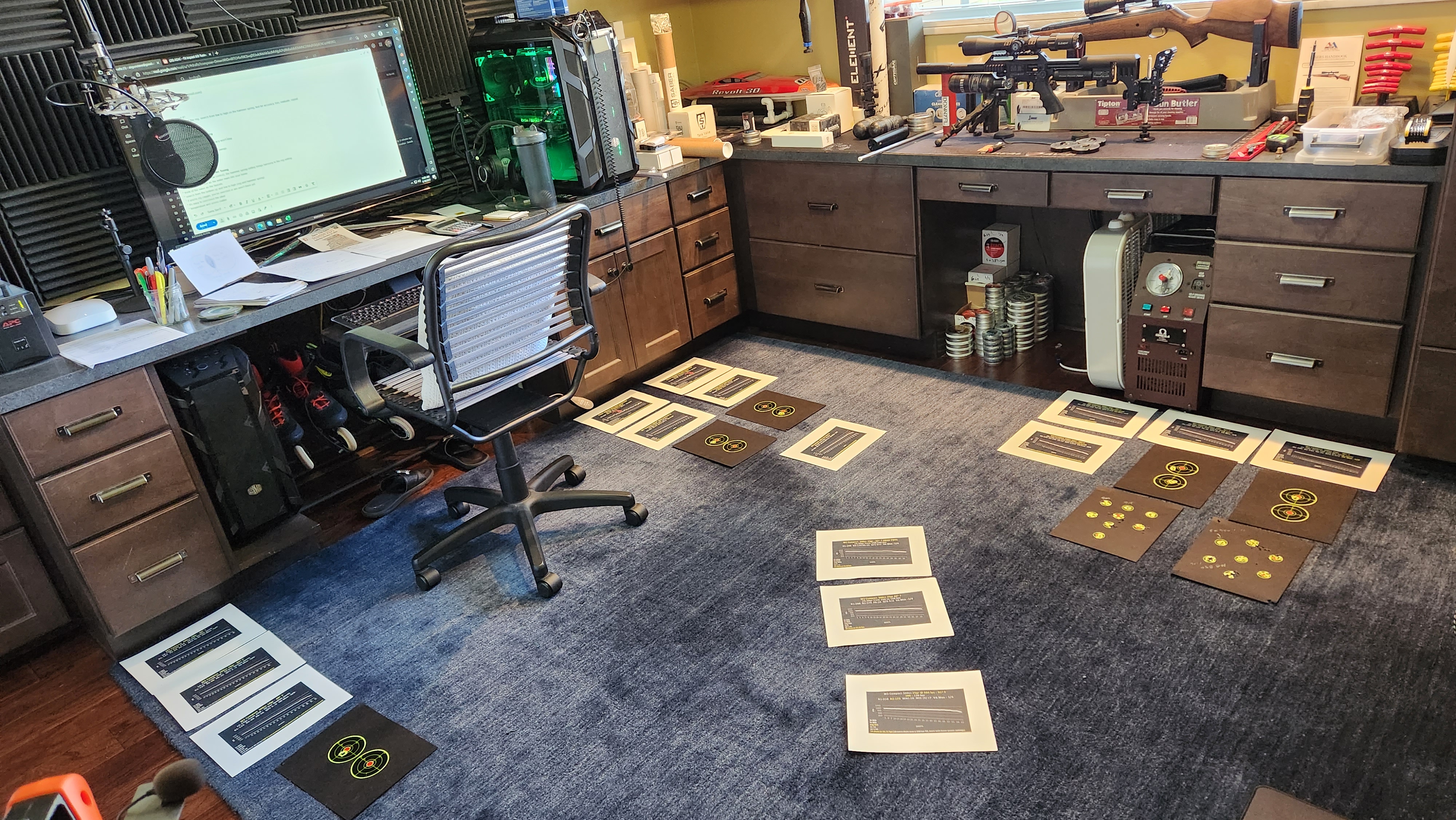

View attachment 318633 Wanting to evolve Eco Tune 1 into something more field worthy, I slowly worked the Valve Adjuster in a 1/4 turn at a time, searching for further tightening of shot-to-shot velocity. This step trims any waste air, increases efficiency, and improves accuracy. As you do it, listen for the report to go from a "cough" to a "snick" or even a
light "snick-ping." The change in sound means that you're "there" and probably in an improved area. The below Eco Tune 2 is what I took into the field with me last week to 50-yard film for the upcoming tuning guide... and the results were excellent, especially for a 16gr leaving at 850 fps and arriving 50 yards sway at 675-700 fps, in a 3-7 mph wind (multiple troll-strolls included)
. Note: the VA ultimately needed another 1/4 turn in to stabilize 50-yard accuracy, which super-validates the usefulness of this nifty device.
